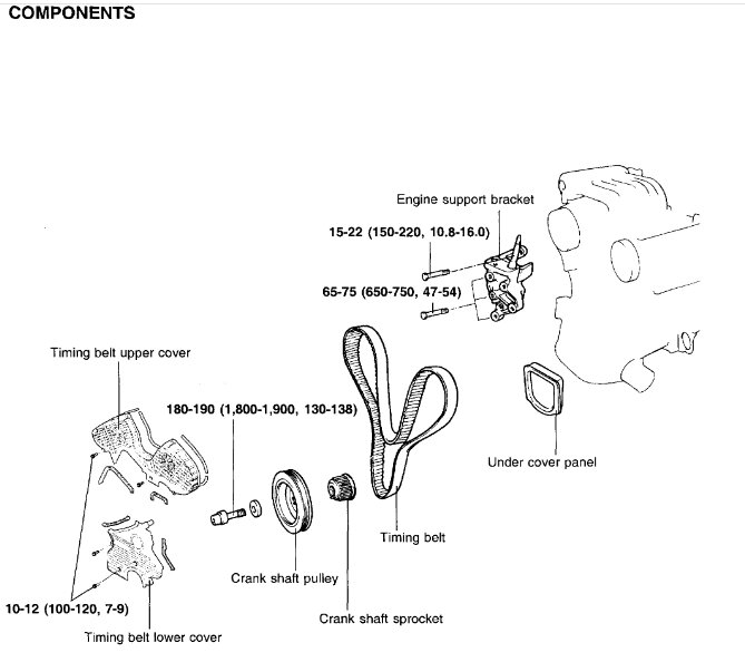

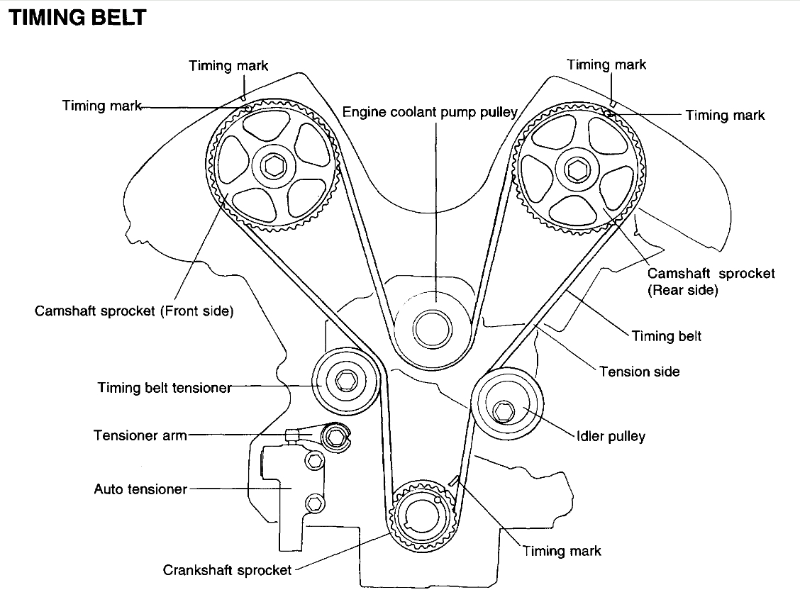

Where are the timing marks for my vehicle listed above ST? So I can put my timing belt on my car.

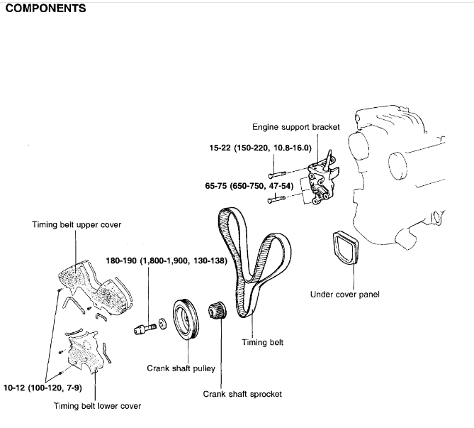

Here are the timing marks for the timing belt as requested. This is a non-interference engine so the valves should be okay. Check out the images (below). Let us know if you need anything else.
