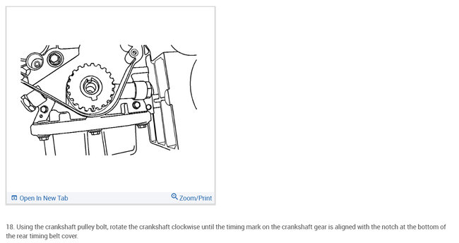

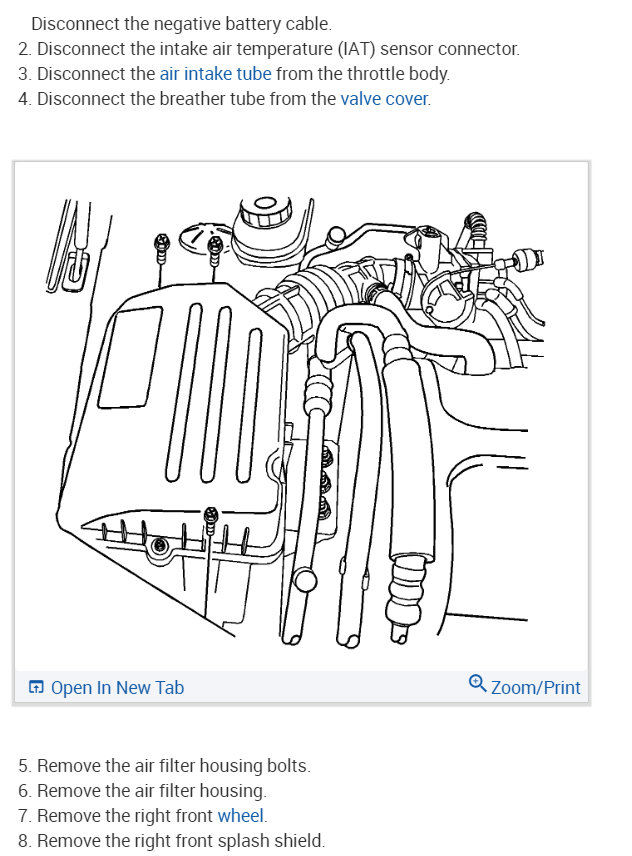

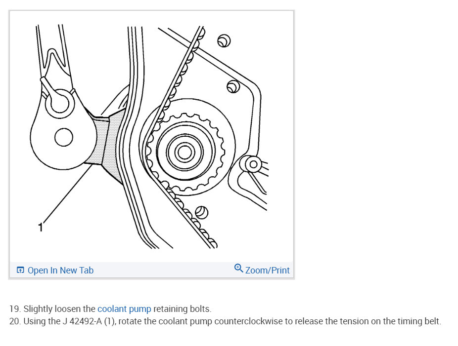

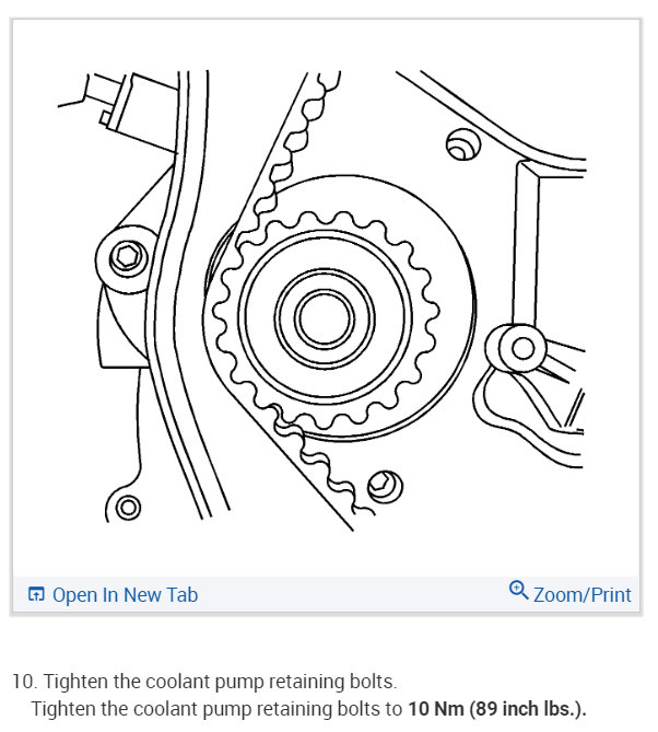

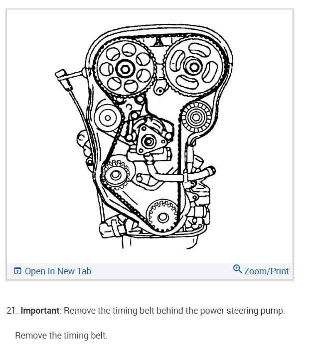

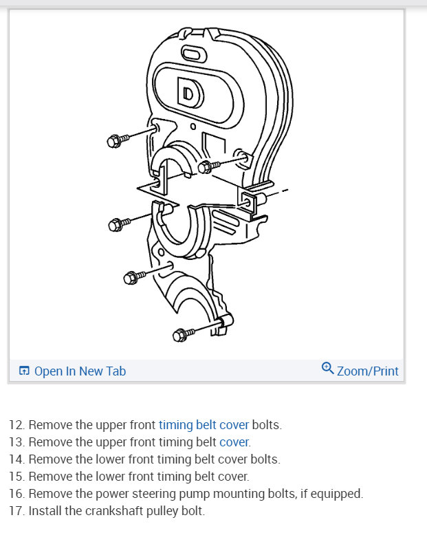

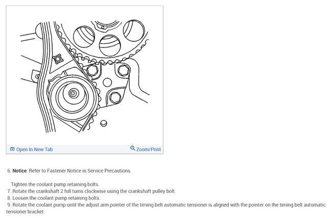

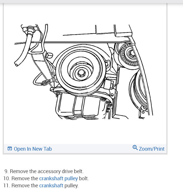

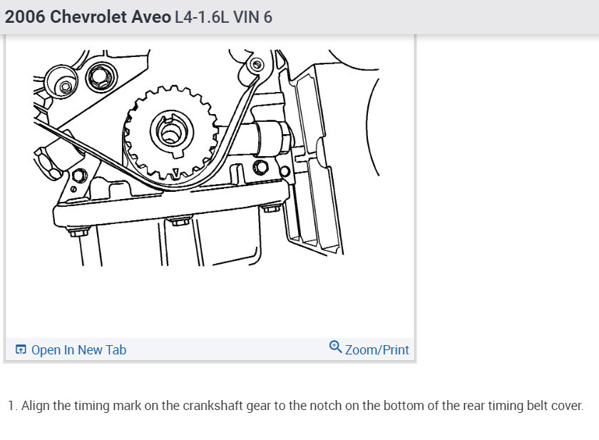

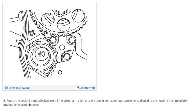

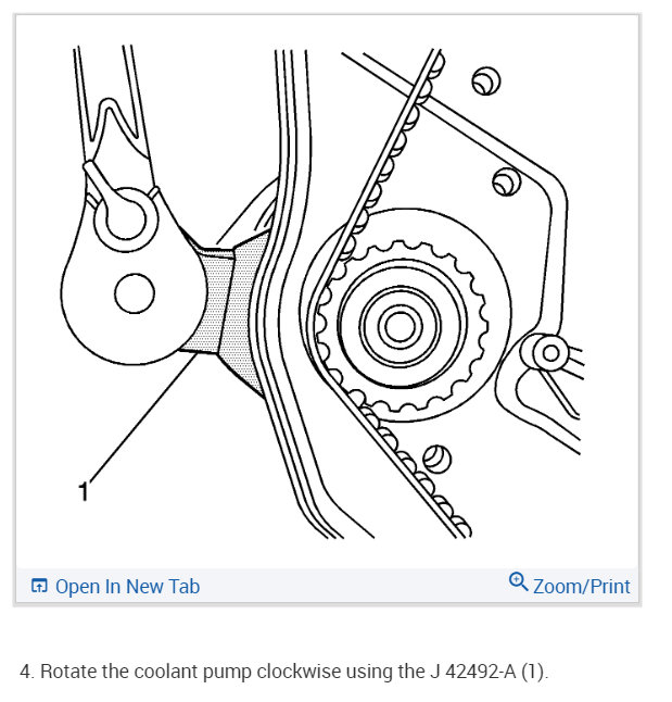

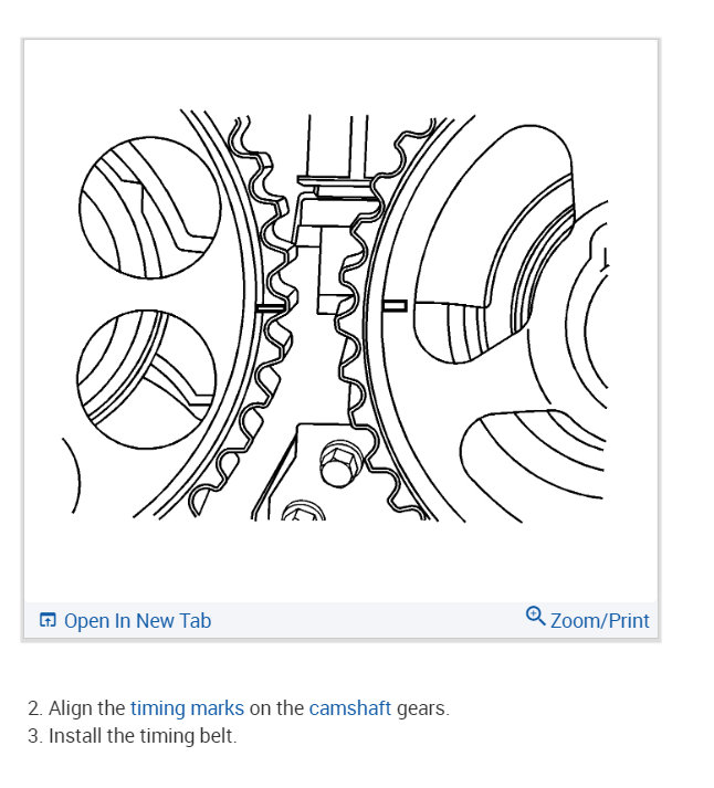

Is a Holden viva 2006 a interference engine or non interference?
Oct 13, 2019 at 4:34 PM
  • 55,222 POSTS
This is the GM engine, it is non interference. here is how you replace the timing belt step by step in the diagrams below. Check out the diagrams (below). Please let us know if you need anything else to get the problem fixed.
