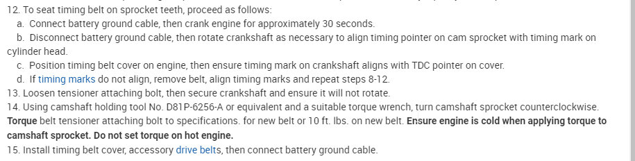

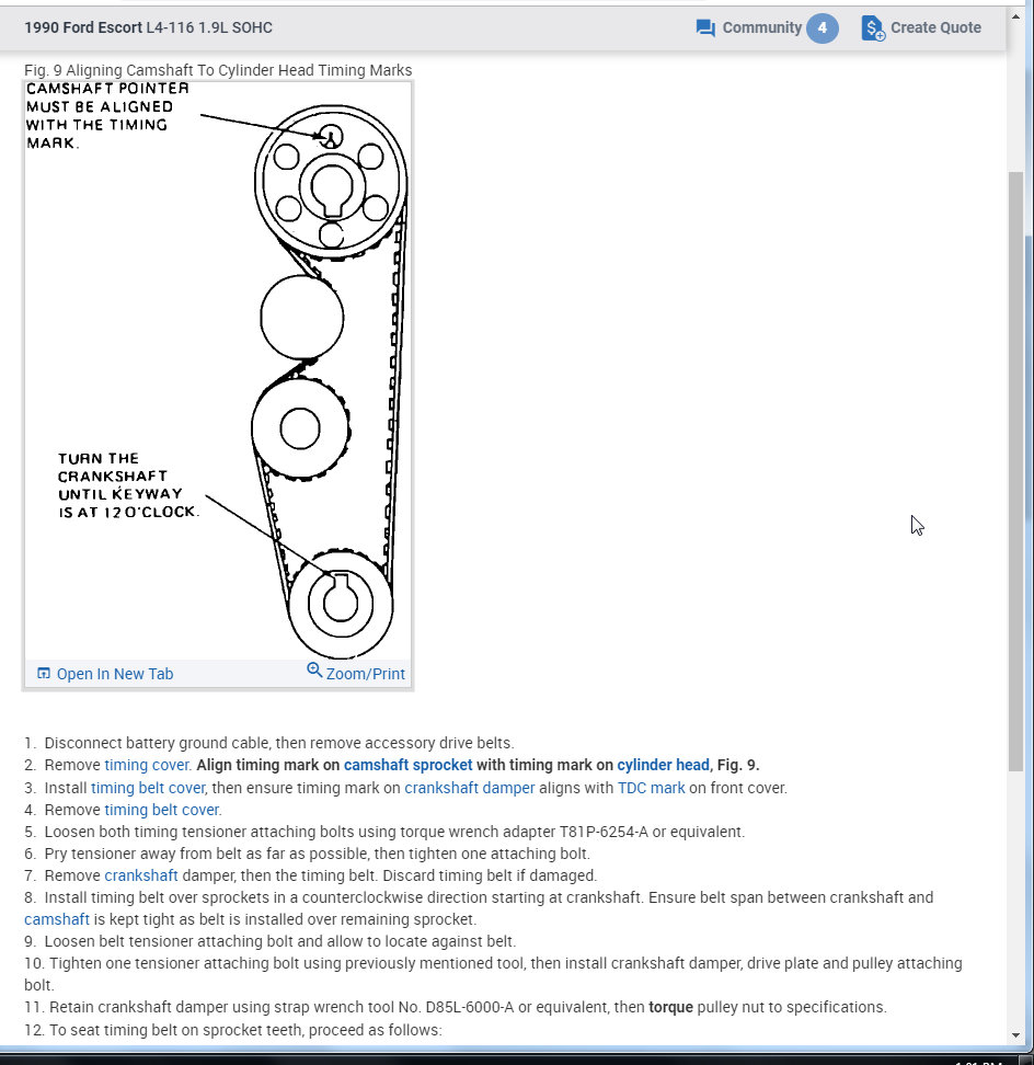

Do you have to remove motor mount just to remove timing cover? Two bolts that secure cover also goes to motor seem the easiest way to remove cover. Pretty sure those bolts also secure water pump, but my buddy can't afford water pump. What's the quickest easiest way to remove cover?
Sep 28, 2019 at 11:09 AM
I attached the process and also gave you a video. The video is of a 1995 but should be close enough. Let me know if you have more questions. Thanks.
