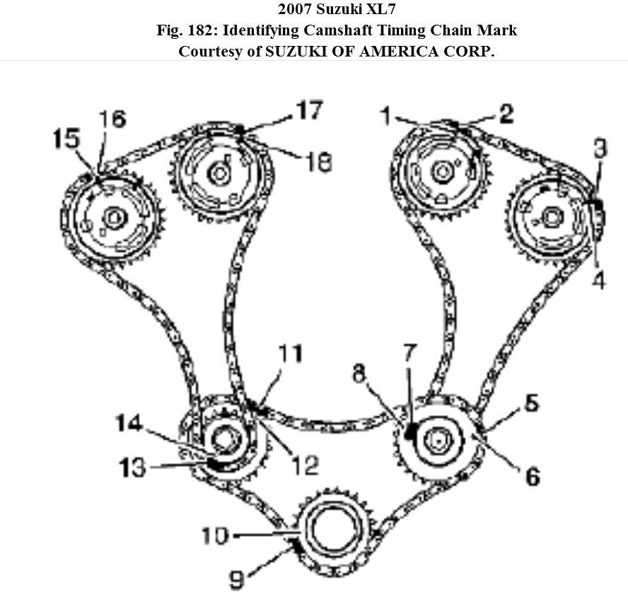

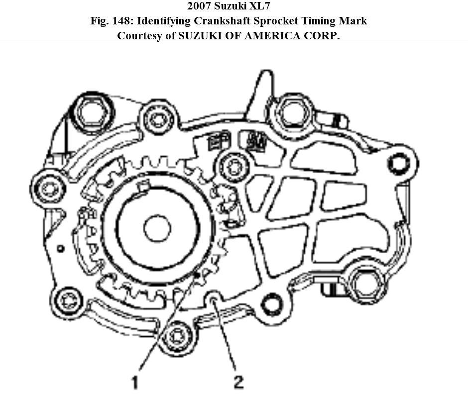

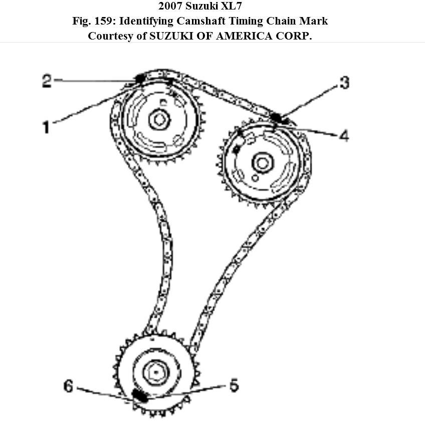

timing arrangement camshaft and cranshaft for xl7
2007 SUZUKI XL7
7,100 MILES
ALLOCATION AUTO
I need to set valve timing for suzuki xl7 2007 but it has two marks on cam gear, one point and other is triangle with is correct. send diagram and arrangement. l have already lost 48 pices of valves if possible a procedure 1 & 2 THANK YOU in advance

The diagrams we have is not very clear and I could not find any better than those I have here.
After installation of the timing chain, you should not crank the engine without testing it.
Remove the spark plugs and manually crank the crankshaft slowly and ensure there is no restrictons at any point. You need to crank the engine at least 360 dregrees to be sure and it is best to crank until the timing marks comes back to position to verify that all marks are correct.
