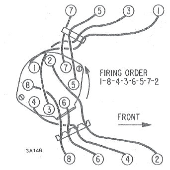

Cannot get to top dead center. engine pops and fire comes out of the carburetor. i have tried everything. i love my car can you help? Please

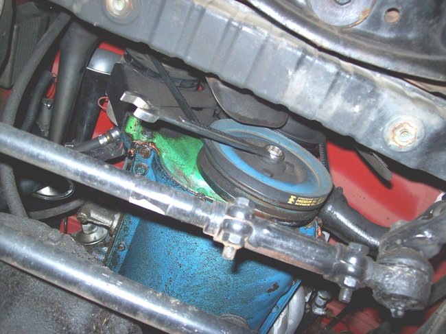

Rotate the engine with a wrench or ratchet. (see my 1st pic, my 6 cylinder Jeep CJ-5)

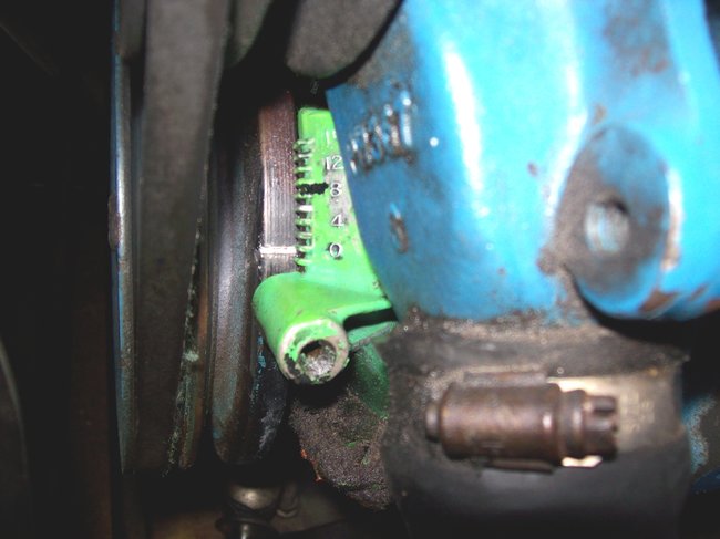

Ever so slowly rotate the engine in the normal direction it turns until your timing mark (line) lines up with zero. (see my 2nd Jeep Pic, white mark corresponds with "0").

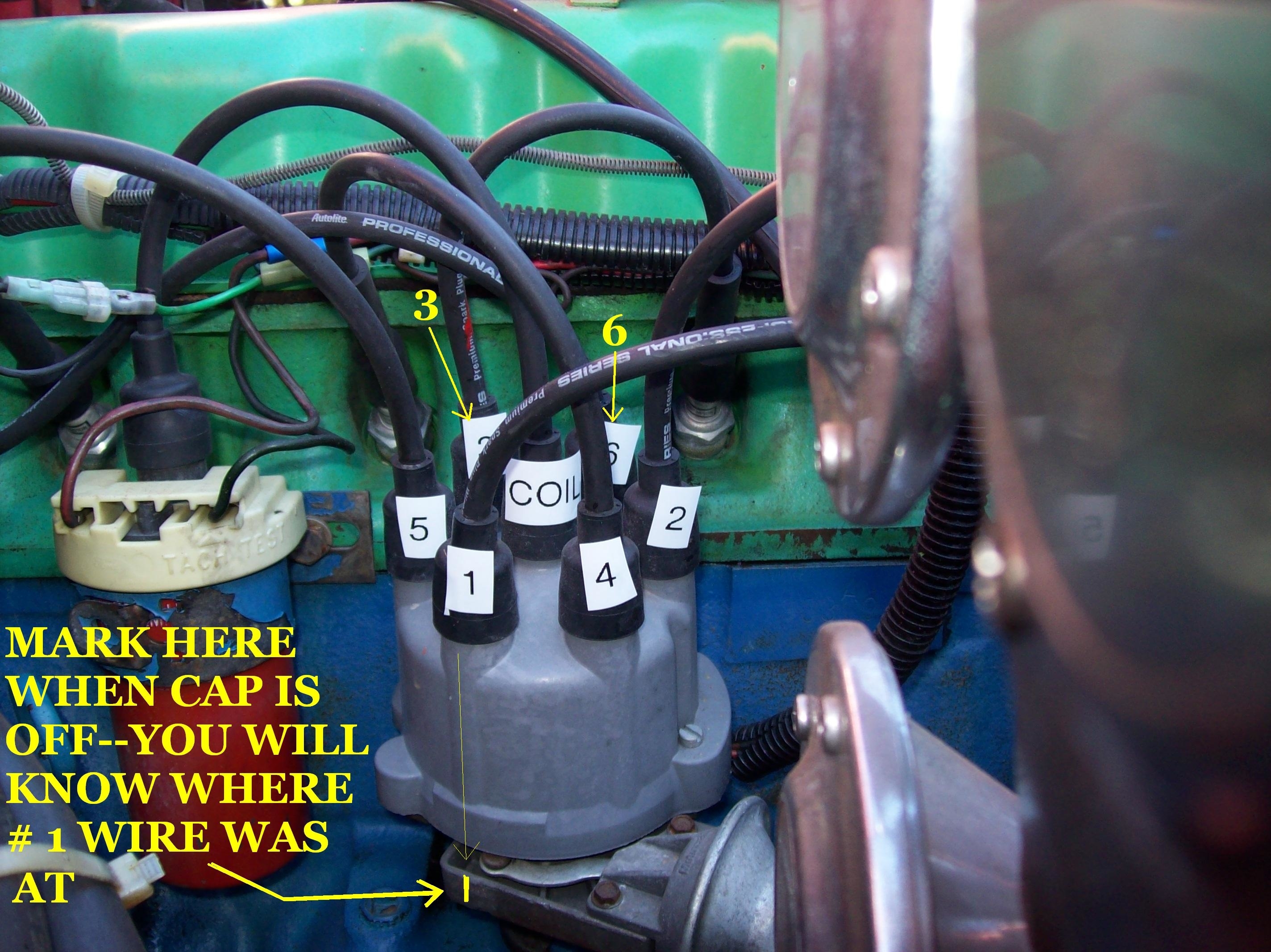

Now look at the rotor button,
it should be facing the "mark" you put on the distributor For textbook,
or which ever tower you chose to be number one (textbook or not).
You will see in my 3rd pic, "textbook #1 position" marked on my cap and distributor's base.
The 4th pic is your "textbook" setup.
The rotor should point toward # 1 without moving the engine.
Otherwise you must remove the distributor and set it down to where there rotor is pointing at #1!

As long as you were at TDC, you placed number one spark plug wire on "that tower" (the one that rotor is pointing to, whichever it is).
And your firing order starts there- and runs the sequence. It will "work".
Installing it "textbook" cuts down on confusion later on, as you may have forgotten the "deal"- simply hooking it all up like it shows in the book will make it easier in eight months. (but you have to install it textbook now)

timing chain was broke. new double roller timing set and crane fireball cam and your knowledge. my Bonneville runs. thank you guys. i almost gave up.
