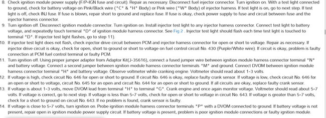

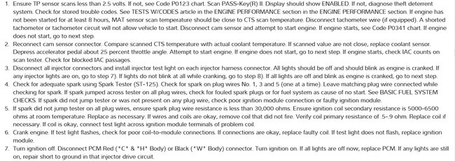

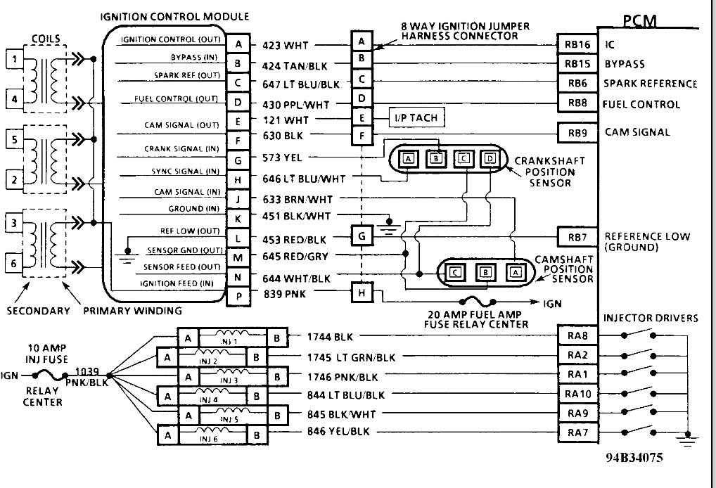

I messed up on this one. first scan for codes cross a and b on aldl then see pictures to help with diagnostics. we have had one tip to unplug oil pressure switch see if it will start. also check fuses for being blown. charts will tell you how to diagnose the problem.
