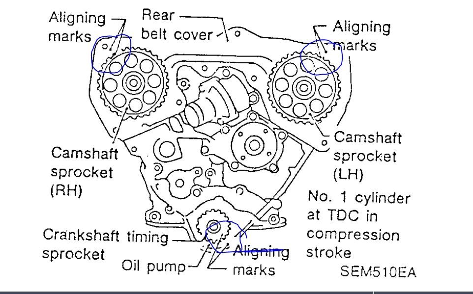

how to reset my timing get TDC?
Jul 11, 2020 at 4:41 AM
Good afternoon,
I attached a picture of the marks that need to be aligned.
Did the belt break? I hope you are using a belt kit with the tensioner and guides.
https://www.2carpros.com/articles/how-a-timing-belt-works
I am concerned that if the belt failed, you may have valve damage. The way you can tell is by installing the belt on the engine. then do a compression test on the cylinder to make sure you have 130-150 pounds.
If you do not, then the heads will have to come off and the valves replaced.
