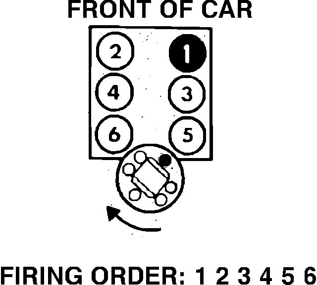

There is no OBD plug on this vehicle. I have removed the dash and searched everywhere, there is no tan wire on the passenger side under the glove box door mat or anywhere else. I need a photo of exactly where and what it is I need to disconnect to set the timing. I am desperate.

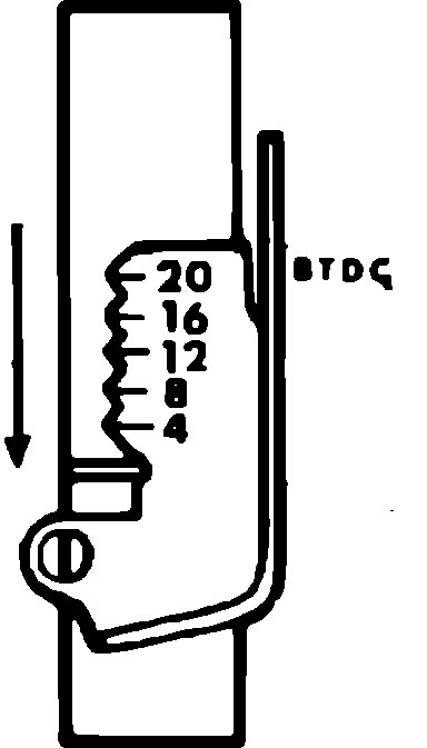

- Start the engine, and aim the timing light at the timing mark. The mark on the pulley should line up with the timing mark. See: Ignition Timing > Electrical
- If an adjustment is necessary:
- Loosen the distributor hold-down clamp bolt at the base of the distributor.
- While observing the mark with the timing light, slightly rotate the distributor until the mark indicates the correct timing.

If the advance on your vehicle is vacuum actuated, there are no wires to disconnect. If it has electronic spark timing (EST), there will be a 4 pin connector to the distributor and another connector from the coil. I looked everywhere for a pic of the wiring, but found nothing.
If you can, take a picture of the distributor and upload it so I can see what you are dealing with.

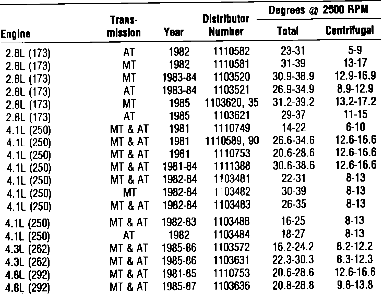

The last picture I attached indicates ignition timing in degrees based on year.
