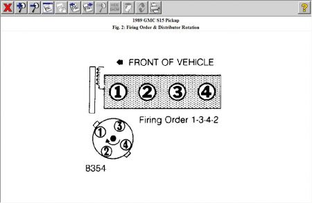

1989 GMC S15 firing order
1989 GMC S15
120,000 MILES • 4 CYL • 2WD • MANUAL
DONW59
i know the firing order is 1-3-4-2 but can not remeber where 1 is on the cap
Dec 12, 2007 at 3:14 PM
  • 75,992 POSTS
Merry Christmas see below
https://images.2carpros.com/forum/automotive_pictures/12900_distributor_1.jpg
