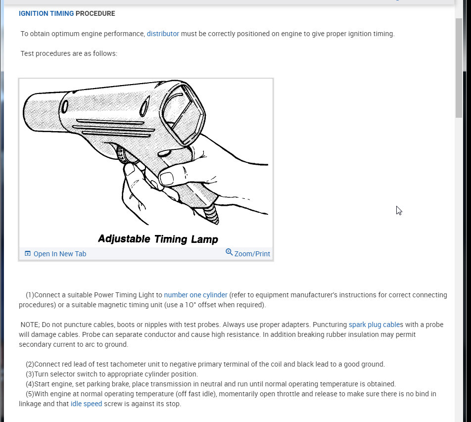

trying to find out what i should set the timing to, and what procedures prior to this i should perform? (unhook vacuum lines, etc.) It has been many years since last i did this.
Sep 17, 2020 at 7:32 AM

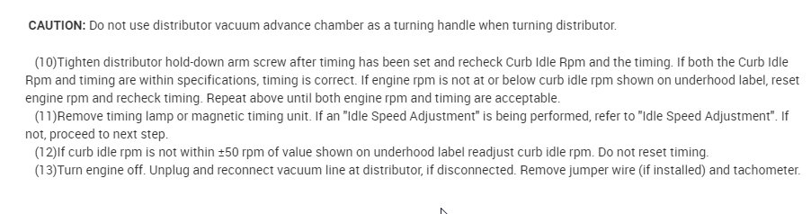

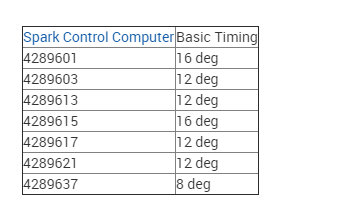

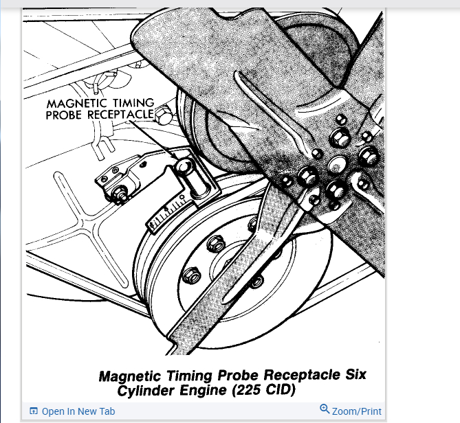

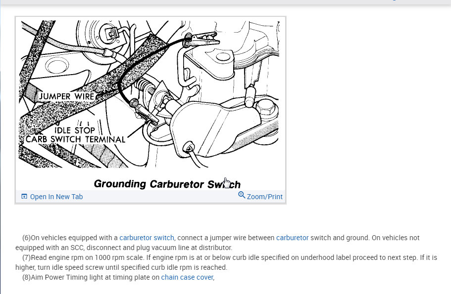

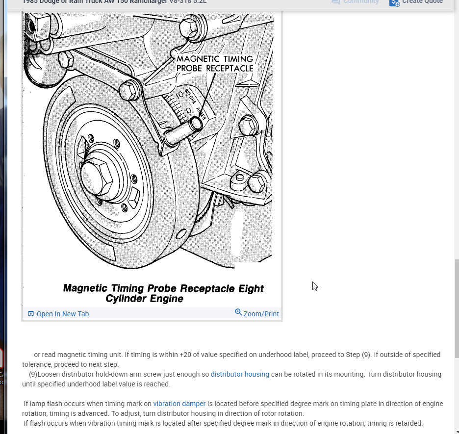

I attached the specs and process from the manual on how to adjust timing. Let me know if you have questions. Thanks
