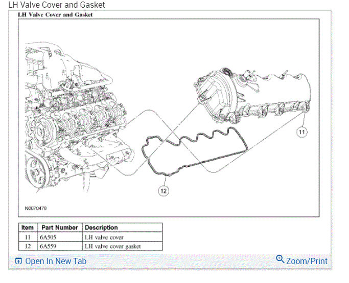

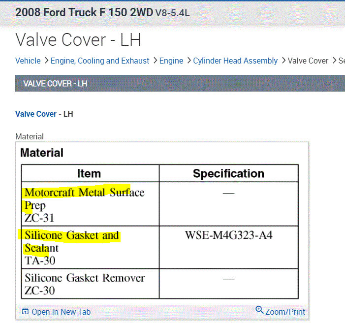

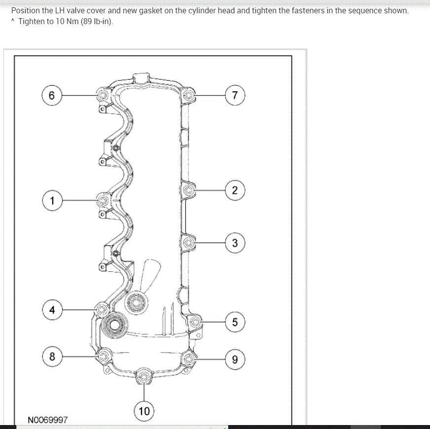

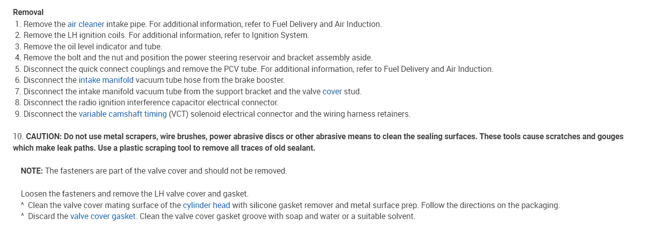

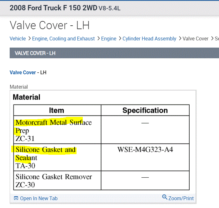

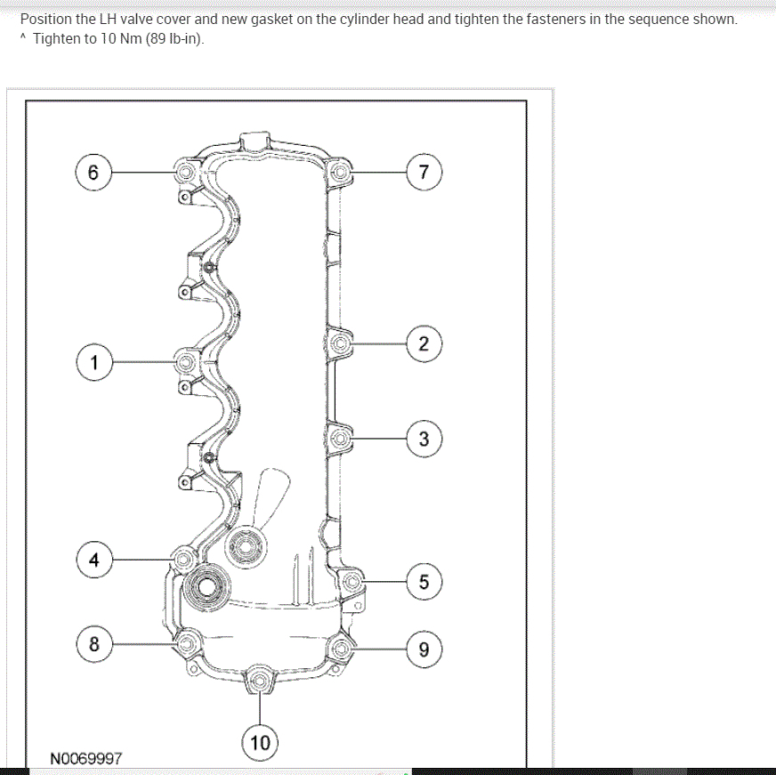

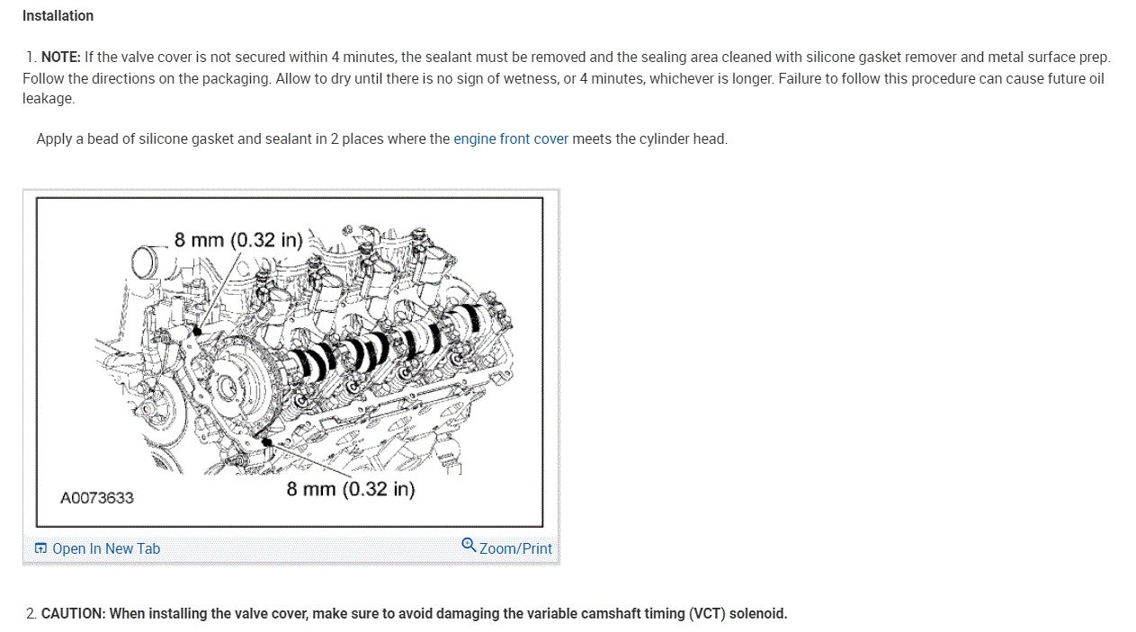

I totally forgot to put RTV on the timing cover. Should I take everything off and take the cover off and out RTV? Also, should it be on the valve covers too? And should I also change the cam position sensors?
May 26, 2022 at 11:23 PM
  • 110,248 POSTS
Ariana,

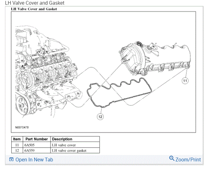

You always get things going. LOL As far as the RTV, the valve covers (where they meet the front cover (timing cover) meet. If you don't put it there, it will likely leak. It is similar where the timing chain cover meets the oil pan.
When you apply the RTV, you need to install the components (finger tight) within 4 minutes. Otherwise, you need to remove the RTV and re-prep the part.
I attached the directions for the LH valve cover. The RH is similar.
Let me know if I can help.
May 27, 2022 at 2:33 PM

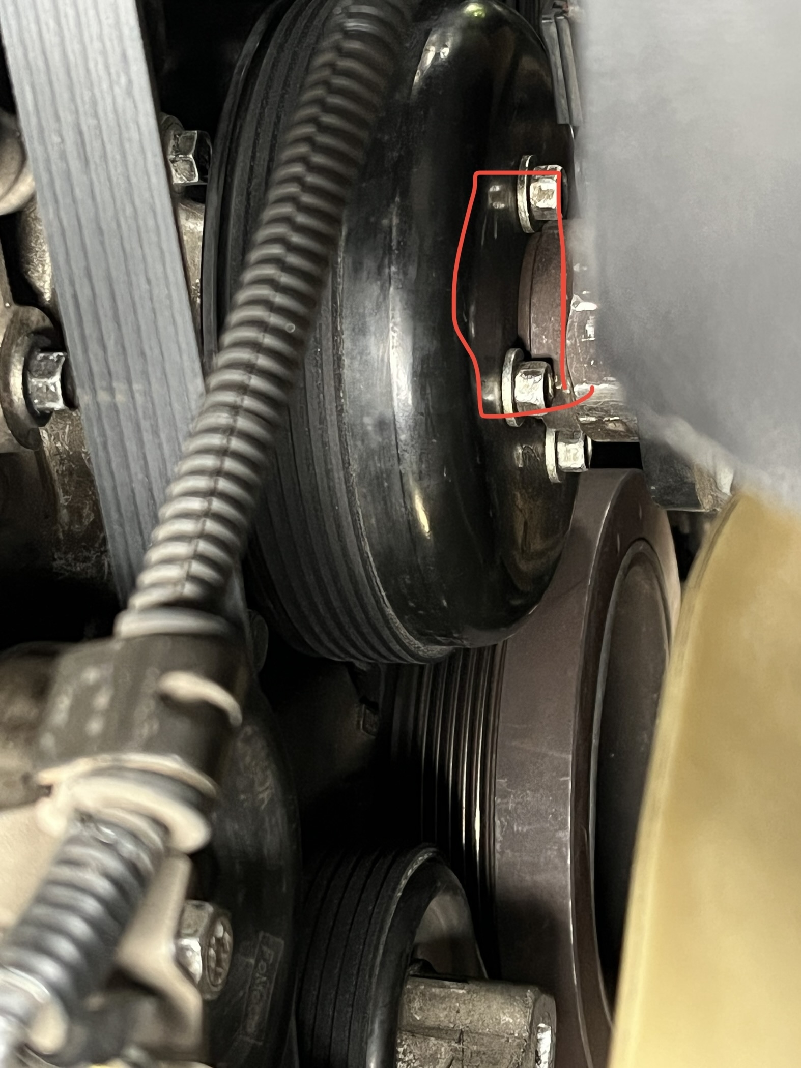

Should this be flush? Could that be why it’s shaking?

So, forget those last posts lol because I took it apart again fearing it was off a tooth and that’s why it was shaking and sure enough the right-hand chain has slack. Why is that? What did I do wrong? All the black links lined up perfectly.

Looking at the pulley pic, something is off. They should be flush. If one is sticking out further than the other, it's likely the pulley isn't fully seated, or something is under it.
Yes, that will cause a vibration. With the engine running, watch to see if it wobbles.
As far as the loose chain is concerned, make sure the tensioners are in place. The tensioners on this engine are hydraulic and depend on oil pressure to function. Are they new or did you reuse the old ones?

I took it apart and it turns out the pulley is fine because there’s like a little ring on the water pump that’s rusted to the same color as the fan clutch, so it makes it look like it’s not flush, but it is. Also, I had a moment of exhaustion because the chain wasn’t loose. It had gotten a little slack because when I was taking the balancer bolt off it moved back very slightly so that was why there was slack, lol. Everything I did was fine, and it was still in time. Tensioners are new. Phasers oil pump gaskets chains and guided all new. Along with spark plugs VVT solenoids cam sensors crank sensor and crank connector so the only thing I can think of is maybe some debris got into the spark plug holes. I noticed the fuel injector retaining clip was bent. Could that cause the vibration?

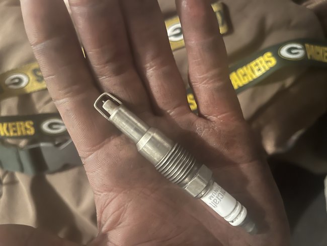

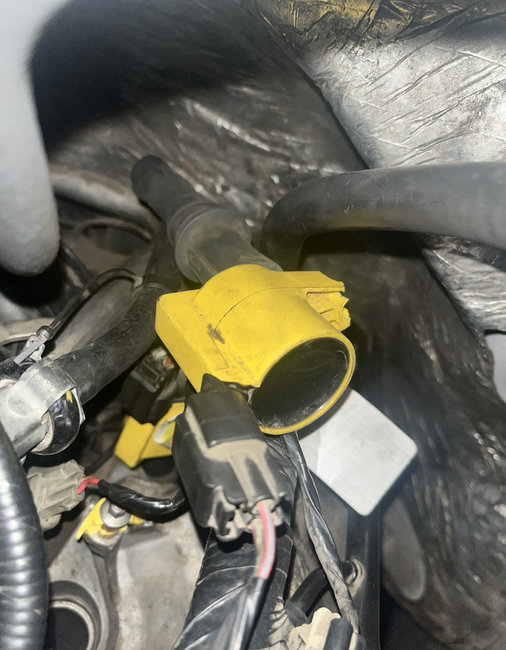

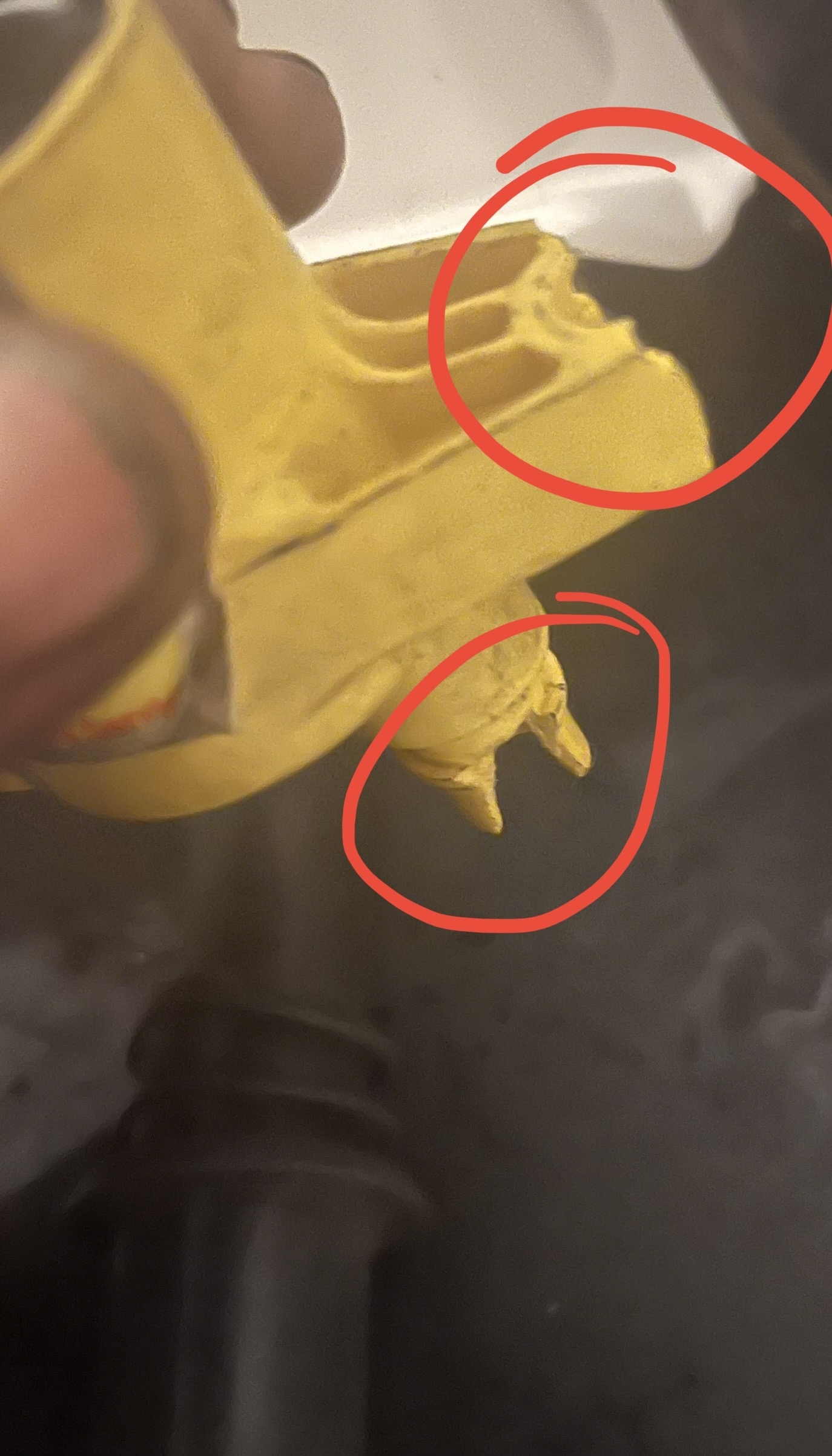

Um, heard a really loud pop and then found this.
Jun 1, 2022 at 4:24 PM
ARIANADANIELLE5345
  • 402 POSTS

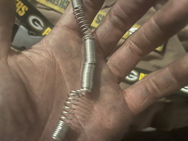

The plug itself looks fine to me, but here’s what broke.
Jun 1, 2022 at 5:29 PM
ARIANADANIELLE5345
  • 402 POSTS
Crazy.
Jun 1, 2022 at 5:31 PM
  • 110,248 POSTS
Ariana,
Did the spark plug stay in the head? These engines have a reputation for having the spark plugs blowing out of the heads.
Was the coil bolted down? I see the housing is broken.
Let me know. I think you found your rough idle.
Jun 2, 2022 at 9:15 AM
ARIANADANIELLE5345
  • 402 POSTS
The plug wasn’t broken at all but no it wasn’t in the head. Threads back in perfectly and tightens and everything. I’m pretty sure it was the ignition coil because that would explain a lot of the stuff the owner of the car was telling me he was experiencing.
Jun 2, 2022 at 10:39 AM
ARIANADANIELLE5345
  • 402 POSTS
Actually, I don't know because I changed everything including spark plugs then tried it and had rough idle. Then I removed the spark plugs again and then installed them again and that’s when it blew out. It didn’t break or anything but blew out as soon as I started the car. The only thing that happened in between was the battery dying and me charging it. So, the rough idle was before I removed them and put them back and apparently either over or under torquing them.
Jun 2, 2022 at 10:44 AM
  • 110,248 POSTS
Be careful with over-tightening. They can strip easily (aluminum head and not too many threads).
For the coil to shoot out, I would think the spark plug came with it. Plus, it looks like the coil fell apart. Did you replace it yet?

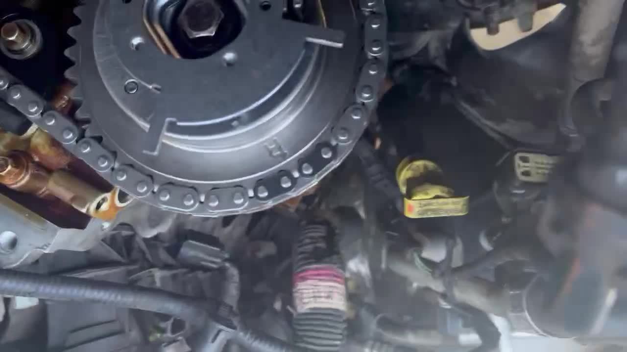

It’s not the timing though because the dark links matched up. So, idk but I’m scared to start it. Here’s a video from right after I was done timing it.
Jun 3, 2022 at 12:05 AM
  • 110,248 POSTS
You do nice work. Everything looks clean and ready to go!!! Many years ago, my first shop teacher always said, "Make it look like someone lives here." In other words, make it clean, organized, and neat. That's what I've always done, but most are not like that anymore. You, on the other hand, do nice work.
What are you afraid of? If you worry about something causing interference internally, simply turn the crank by hand several revolutions. If there is an interference, it will stop turning and won't go further. (don't force it if that happens).
Ariana, just make sure not to cross-thread the spark plugs or overtighten it. I would replace that coil. It looks beyond repair.
Never be afraid. The worst case is it won't start, or you may hear a backfire. LOL If you do, stop and recheck the timing. If everything is aligned, it will start.
Take care of yourself, be confident, and don't worry. I know you took your time and it's right.
