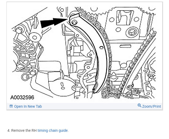

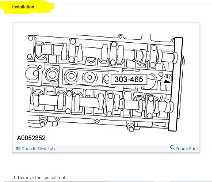

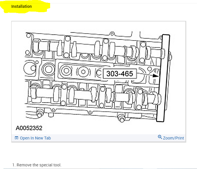

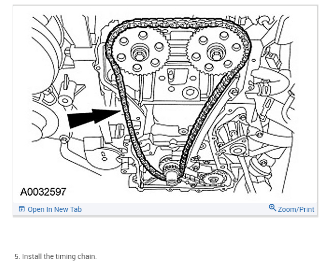

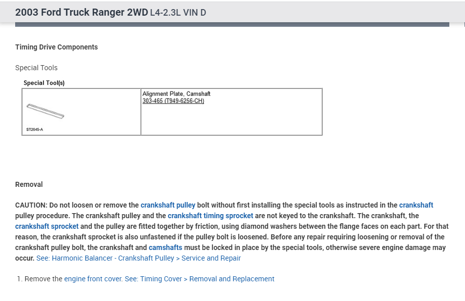

I need to get the truck back into the right timing after tearing the timing belt.
Aug 21, 2023 at 9:24 AM
  • 110,244 POSTS

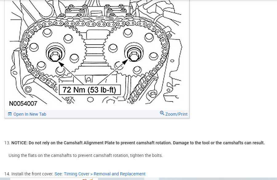

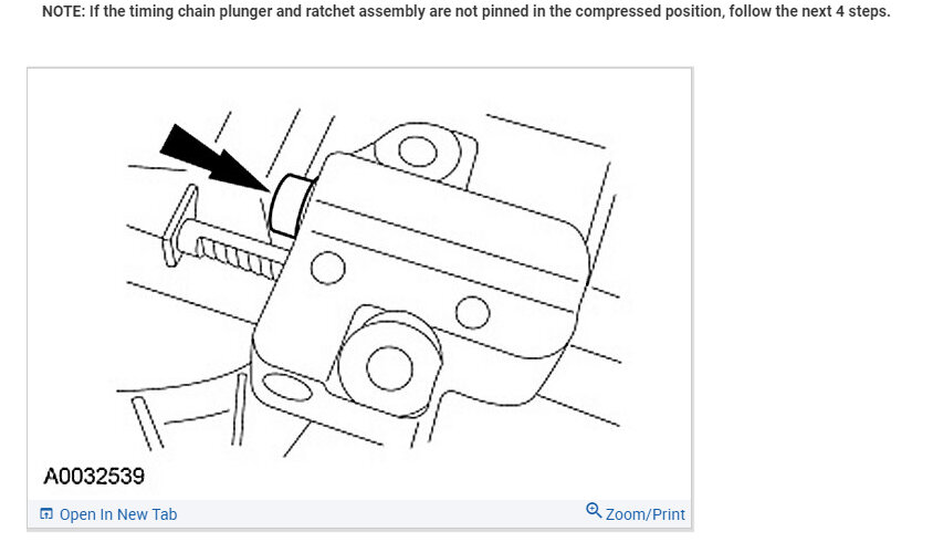

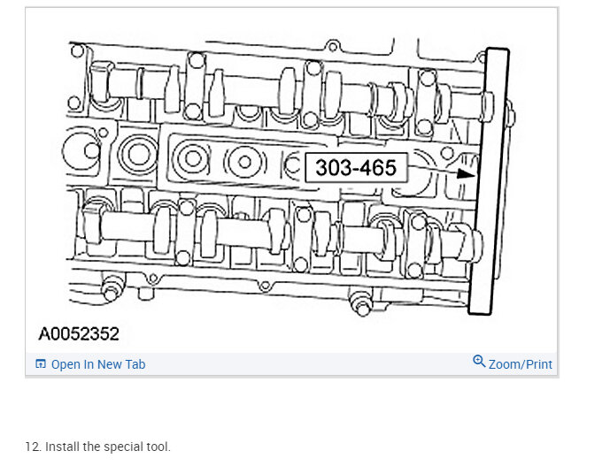

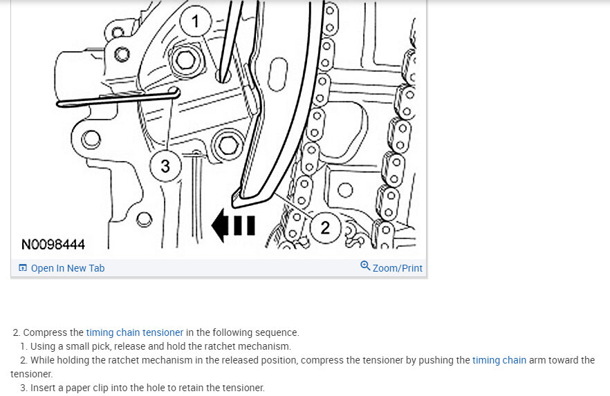

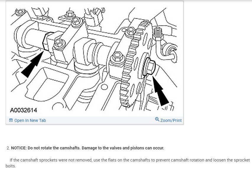

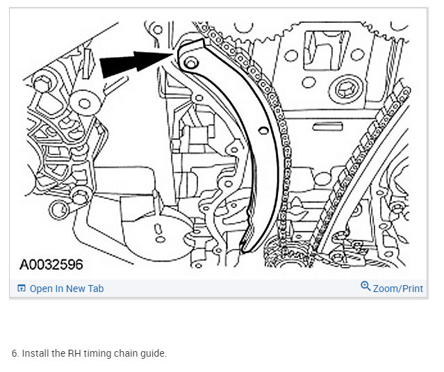

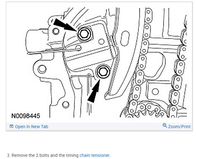

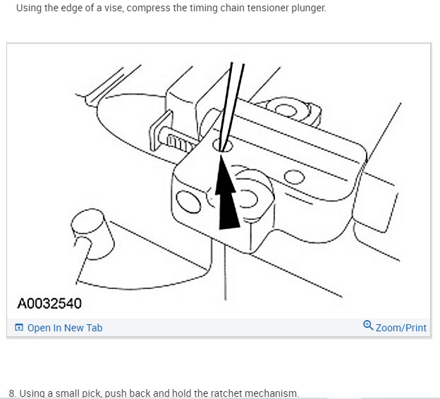

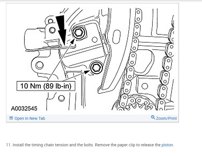

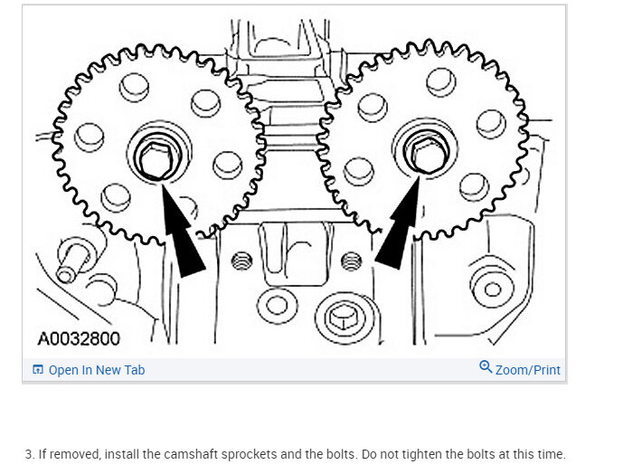

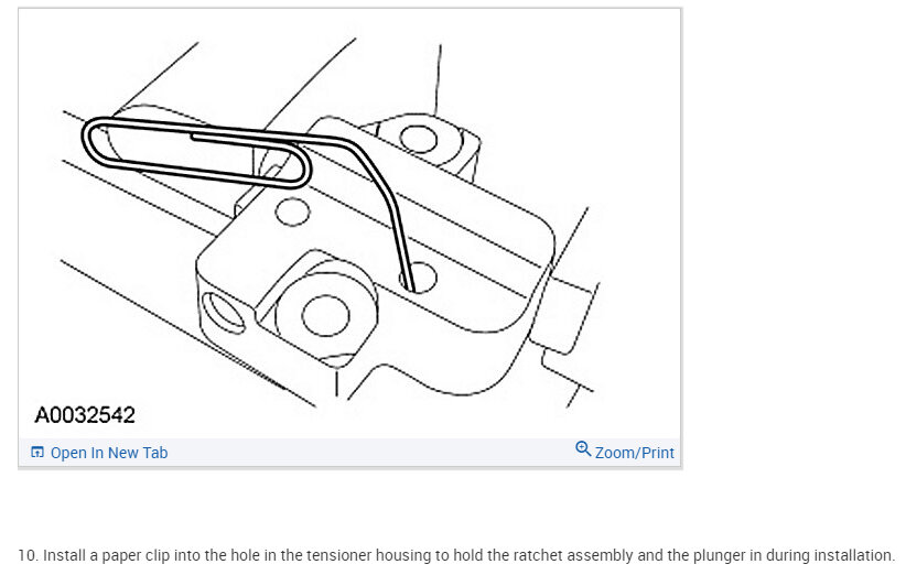

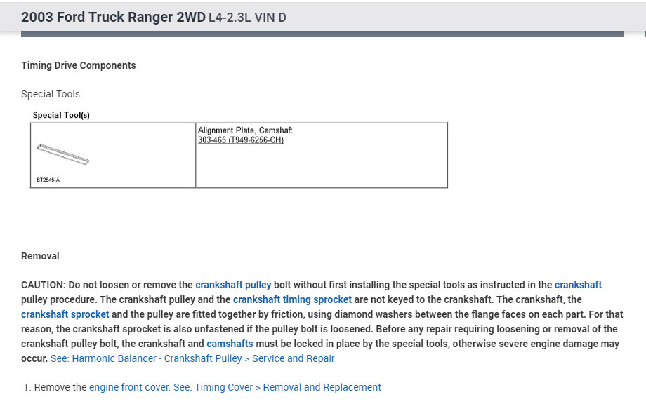

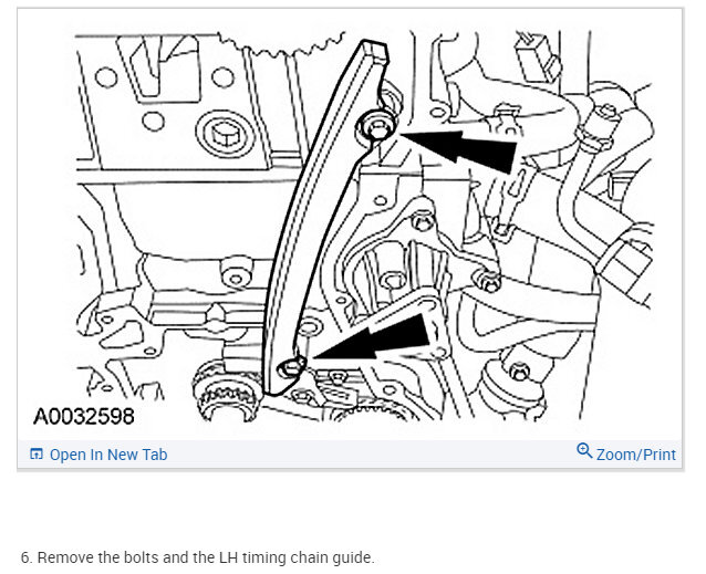

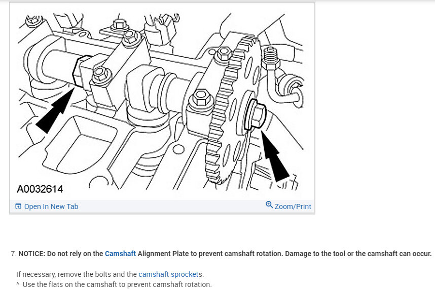

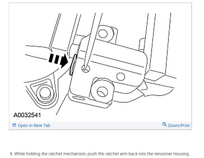

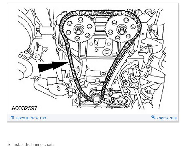

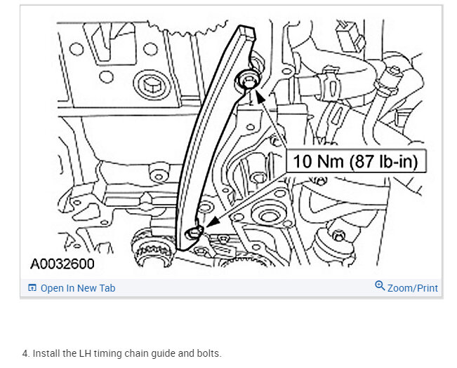

This engine has a timing chain. Are you sure it is the timing, or could it be the serpentine belt?
As far as the timing chain, I attached the directions below. You will need a special tool to hold the camshafts in a specific position, but most parts stores will lend one to you.
Take a look and let me know if this is what you needed.
Take care.,
