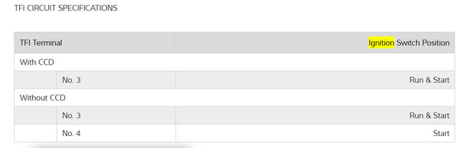

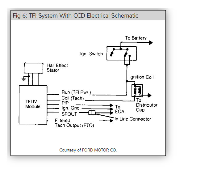

I need to know how to;
Set the timing without timing light. Diagnose any wiring and/or vacuum line issues.
Sep 18, 2019 at 6:08 AM
SCGRANTURISMO
  • 4,897 POSTS

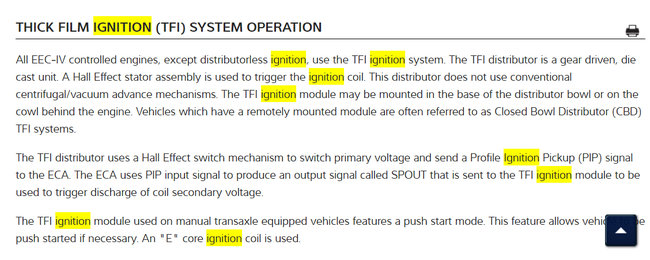

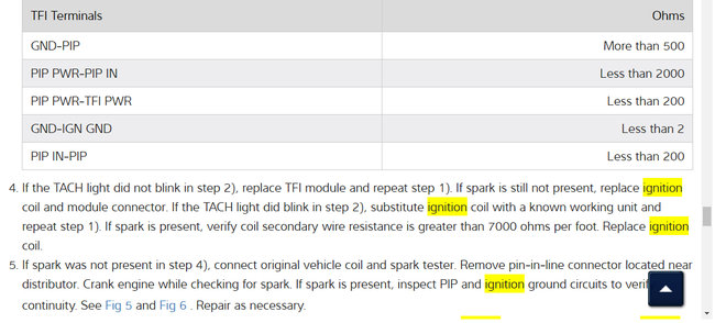

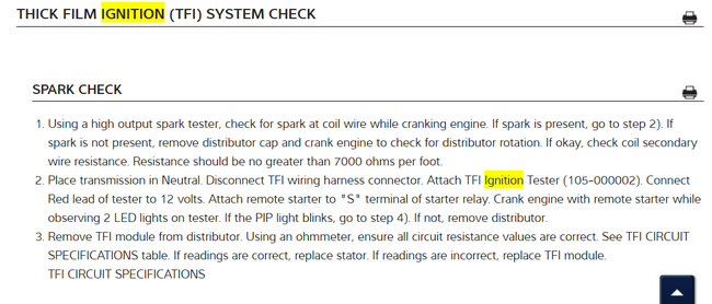

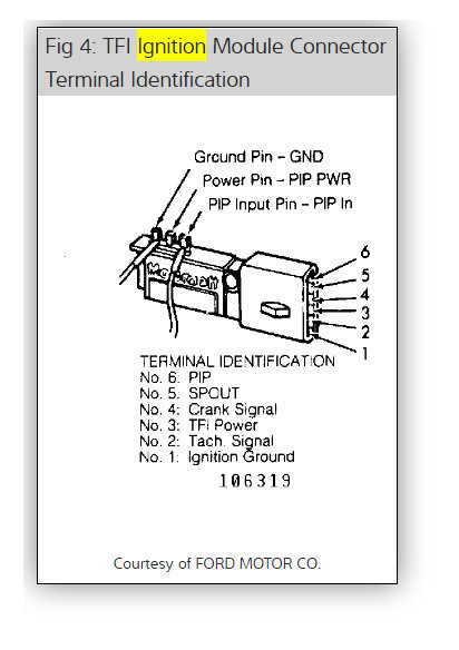

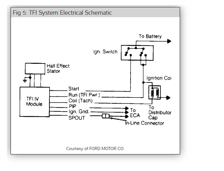

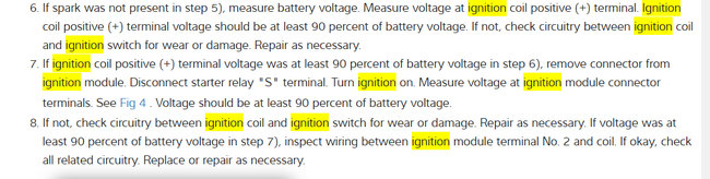

In the diagrams down below I have included a guide to the Thick Film Ignition (TFI) that your vehicle uses. What exactly is going on with your vehicle so I know what to help with.
