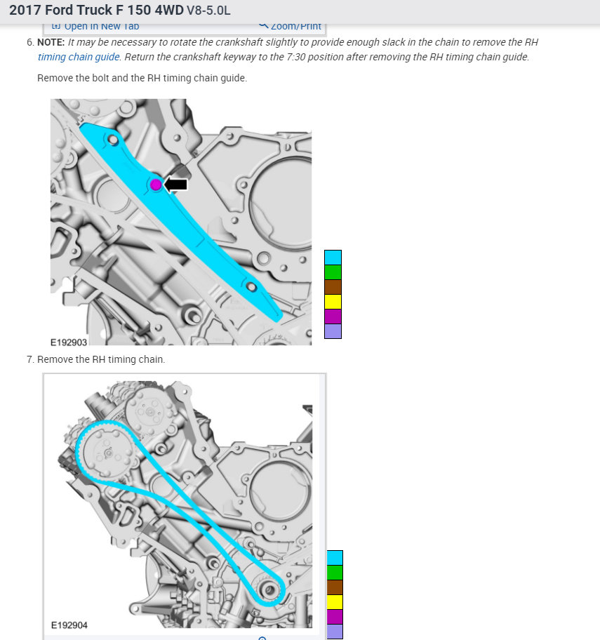

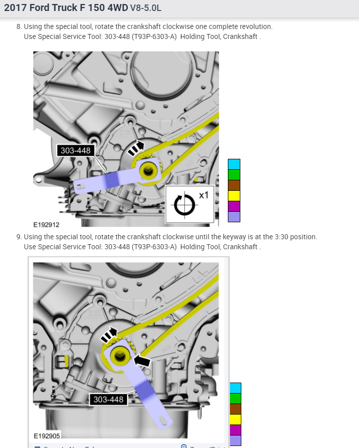

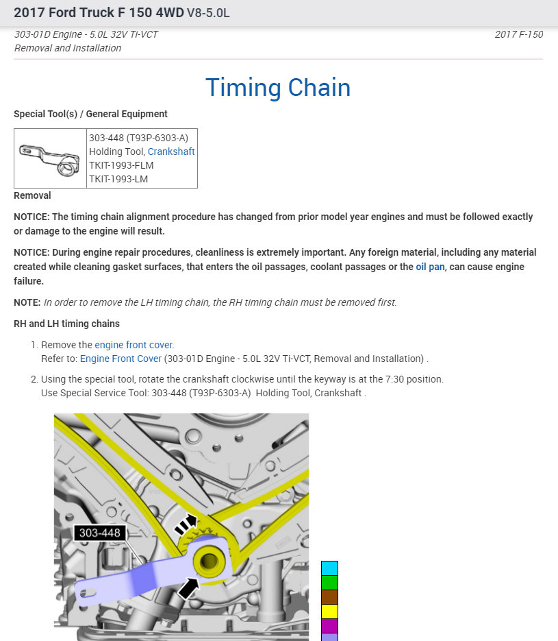

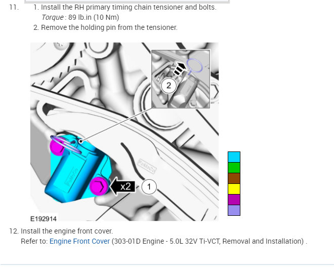

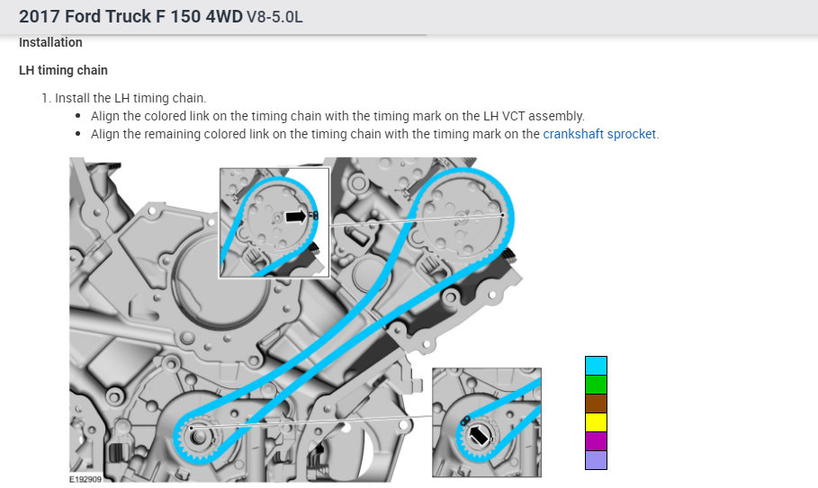

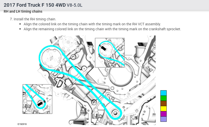

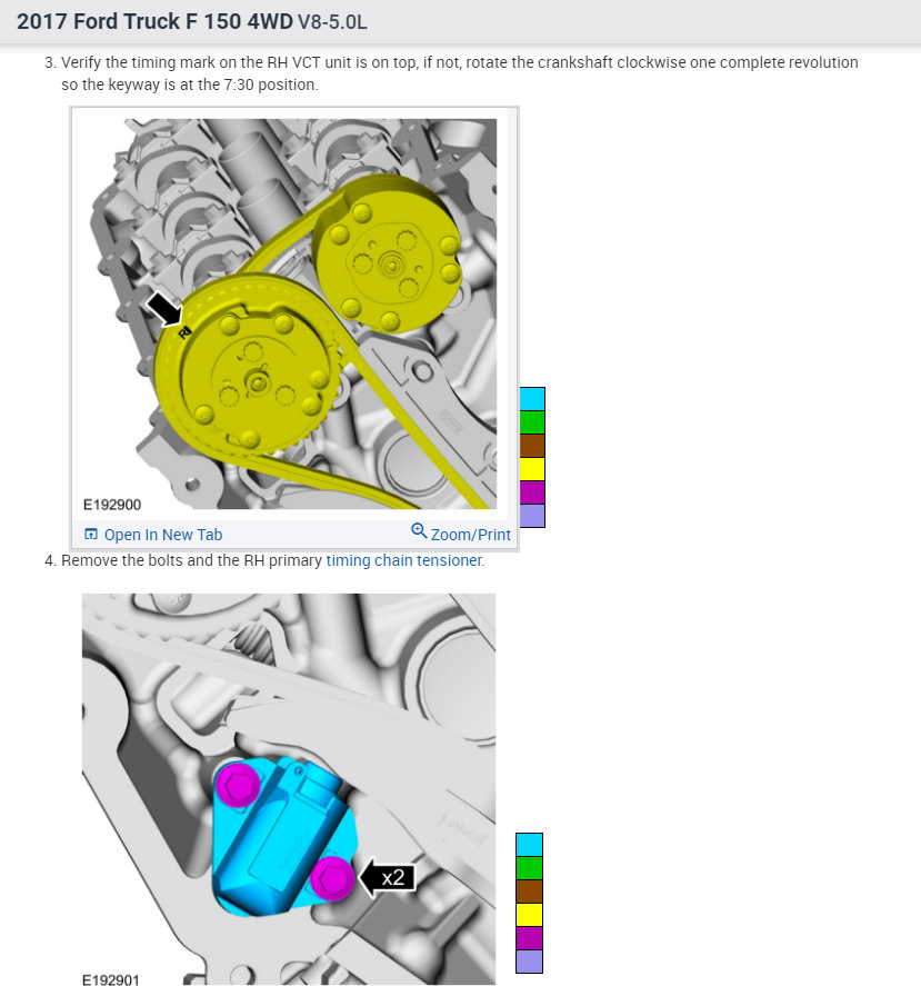

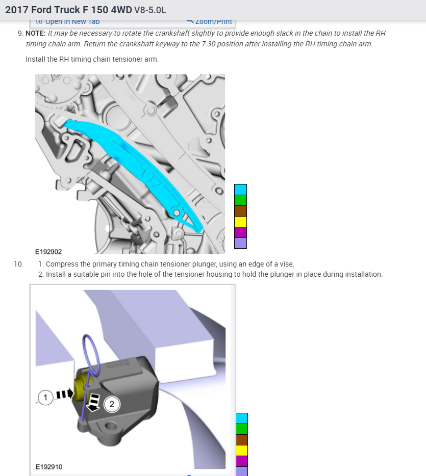

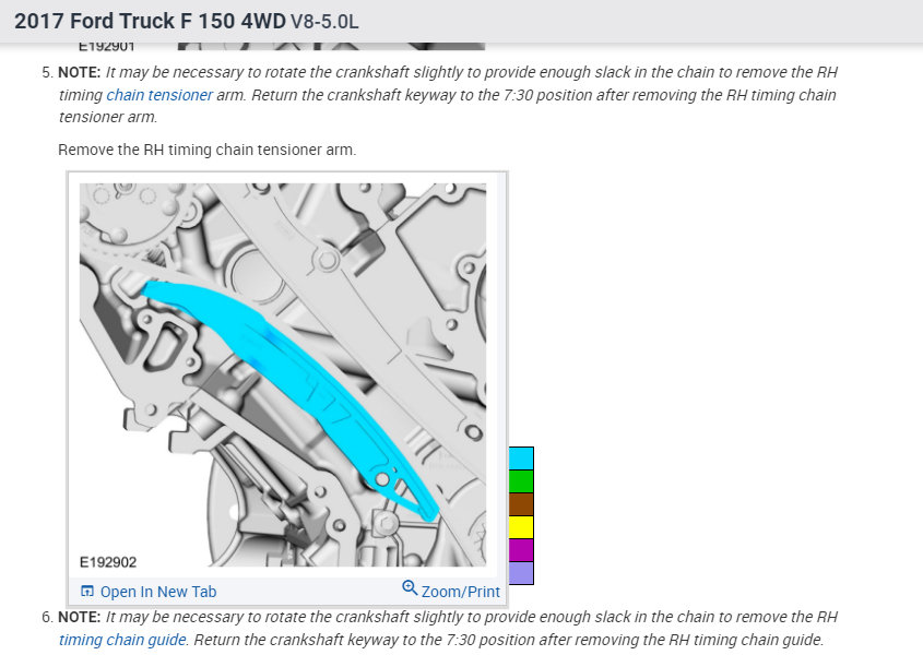

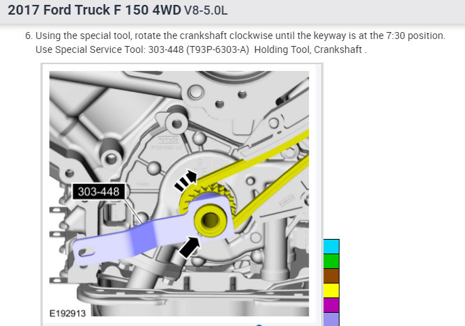

I’m trying to figure out where my timing marks need to be to take the old timing chain off and put the new one on with all new phasers and Solenoids.
May 30, 2022 at 9:22 PM
SQM
  • 6,383 POSTS

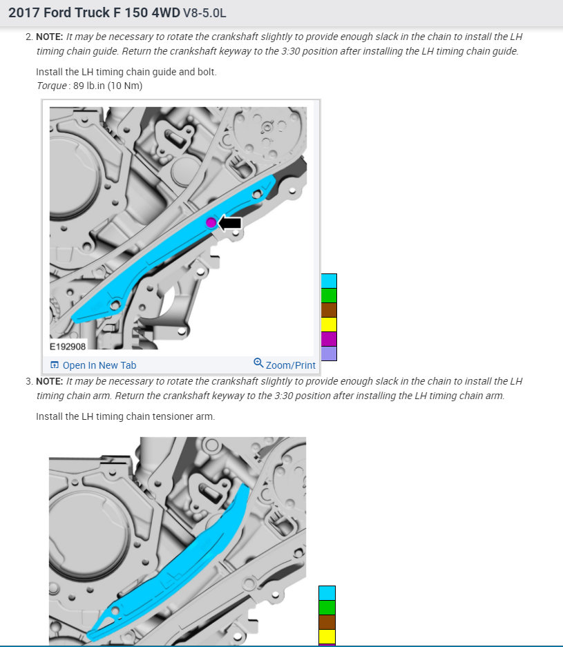

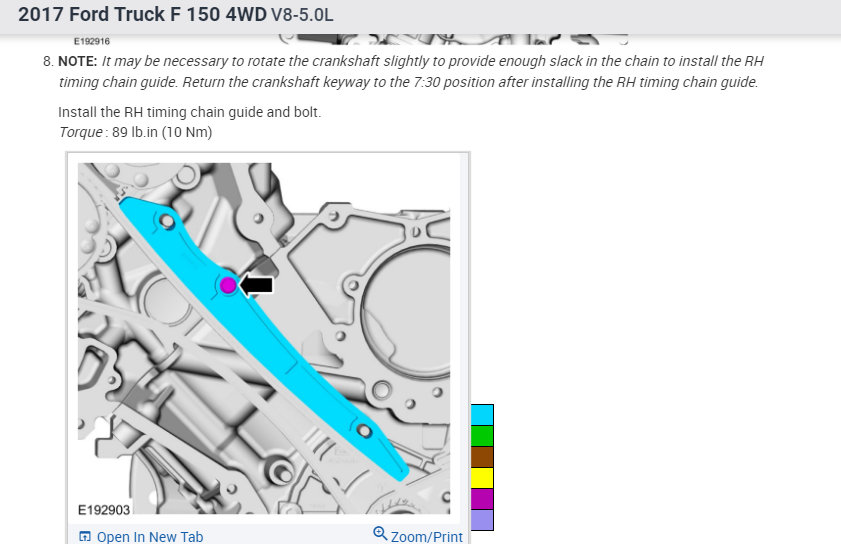

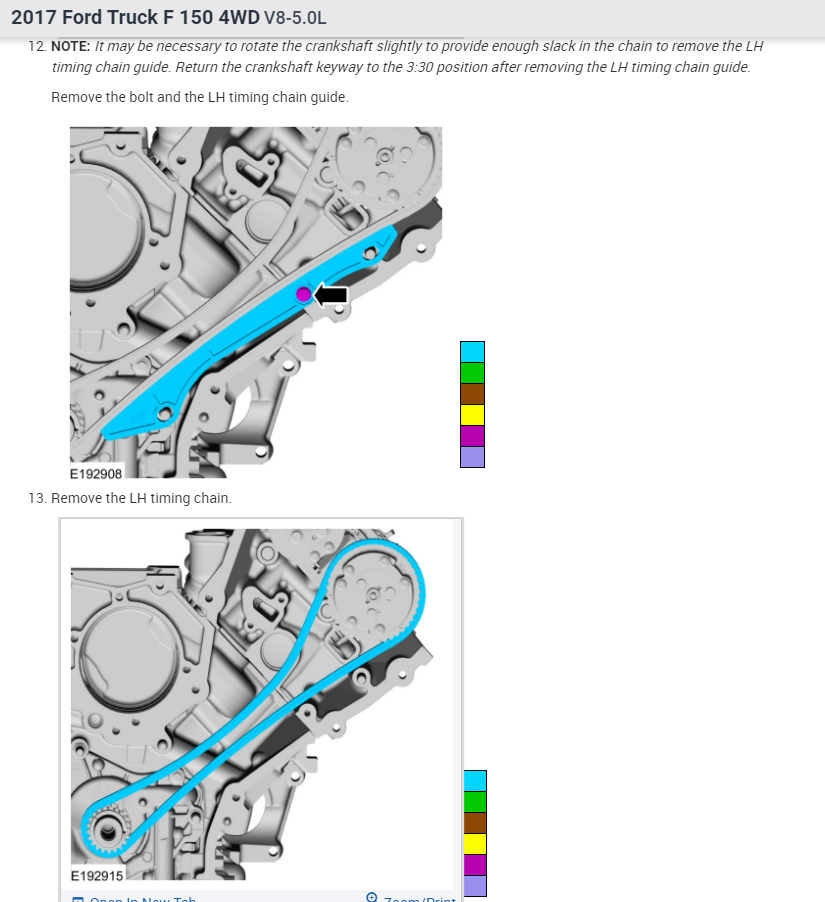

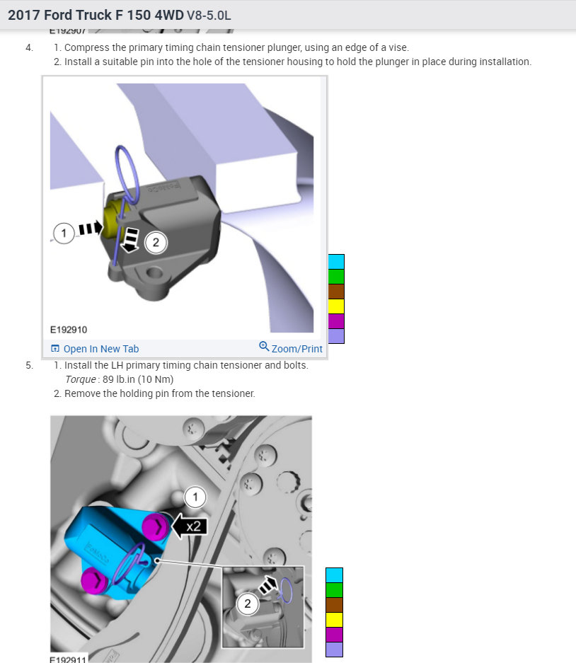

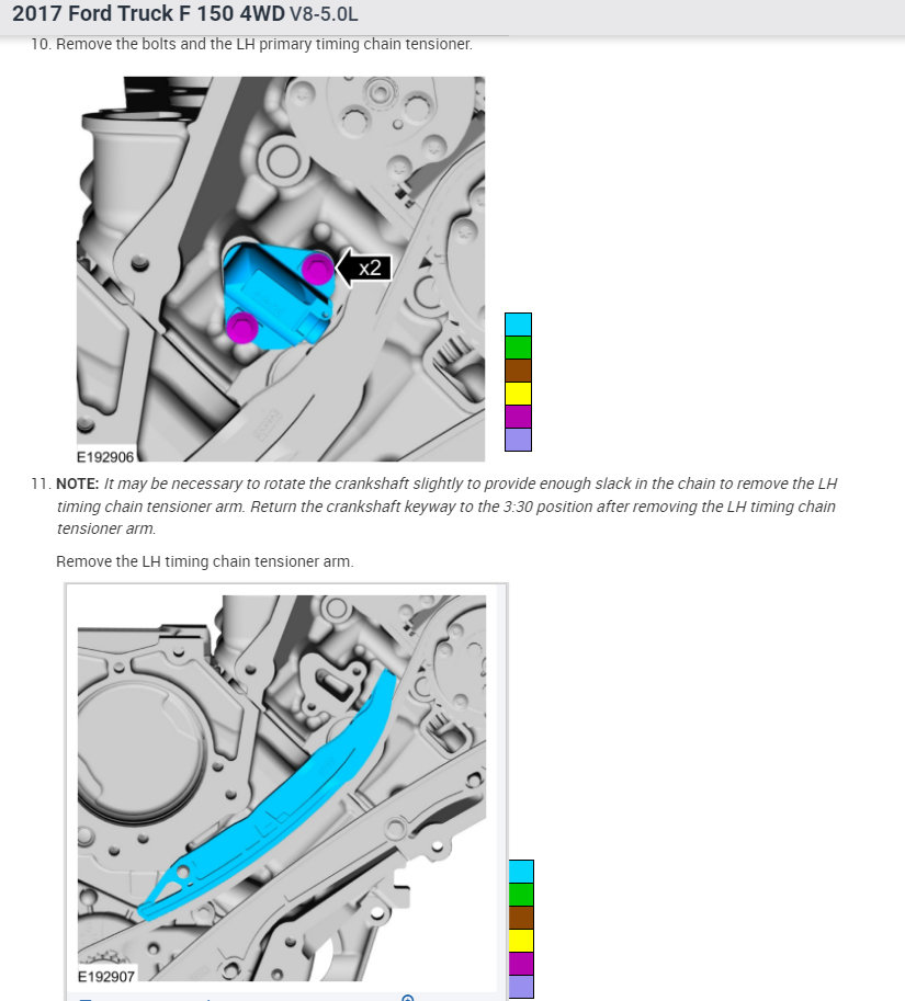

Replacing the timing chain requires following certain steps from removal to installation.
Look below, I have attached the timing chain replacement procedure, it includes the markings and other specifications.
Let me know of any questions.
