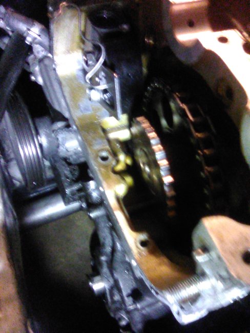

AZDANNO04
  • 378 POSTS
My neighbor had a fuel pressure tester and while he was checking everything else had me turn the crankshaft to be TDC. When he turned it he noticed some noise underneath the valve cover and had me remove it. Sure enough the chain had too much play and the center sprocket hardly had any teeth left. I have a timing kit when I replaced the upper tensioner but didn't change anything else. But I believe that was the one sprocket that didn't come with the kit which is the variable timing sprocket. Which I just ordered.
Mar 23, 2021 at 8:53 AM

AZDANNO04
  • 378 POSTS
When I took the camshaft cover off. That's where I saw the upper tensioner that I had replaced 8 months ago. I guess the vibration backed the two 10mm bolts out and it was pushing the chain against the idler sprocket wearing down the teeth. I looked at the upper tensioner still good but I did have to re thread one the bolts and was wondering should I use the blue for vibrations lock-tite? I also have the timing kit the chains etc., in a bucket of new engine oil till I finish taking off the harmonic balancer. Hopefully I don't need to take the water pump off or housing to replace the lower tensioner. It looks like I can...

AZDANNO04
  • 378 POSTS
The worn down sprocket.now trying to get the timing cover off. Then the fuel rail and intake manifold to remove the.heads to see what damage it has done. Hopefully just one piston if that's why I found a piece of a valve in the oil pan.
