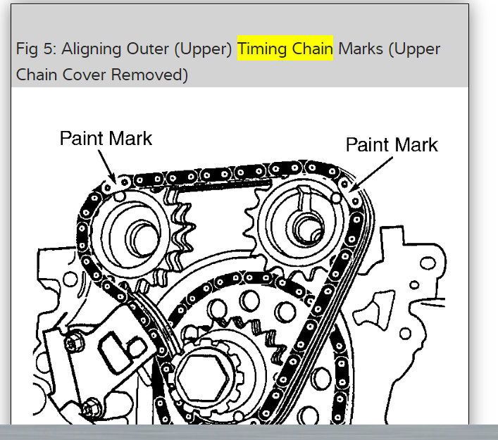

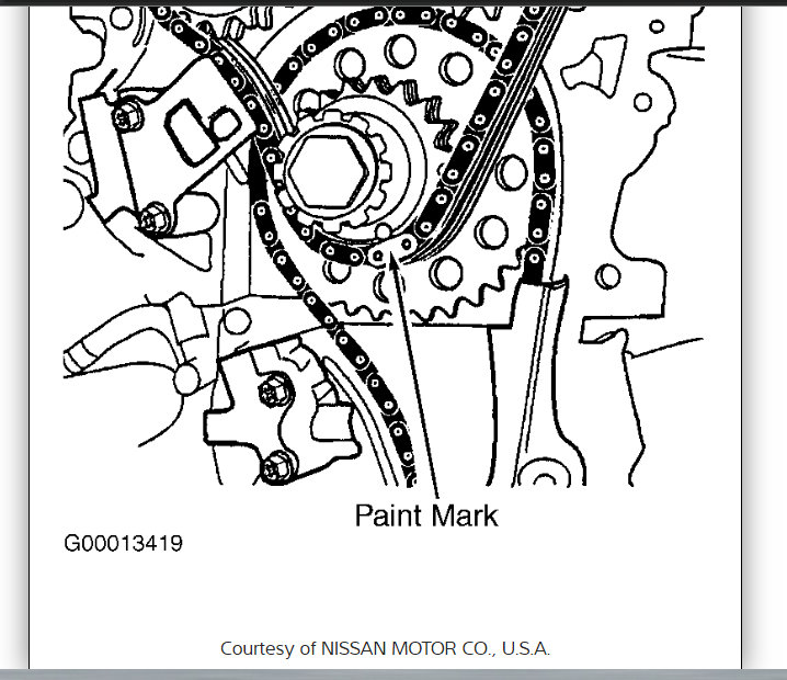

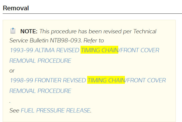

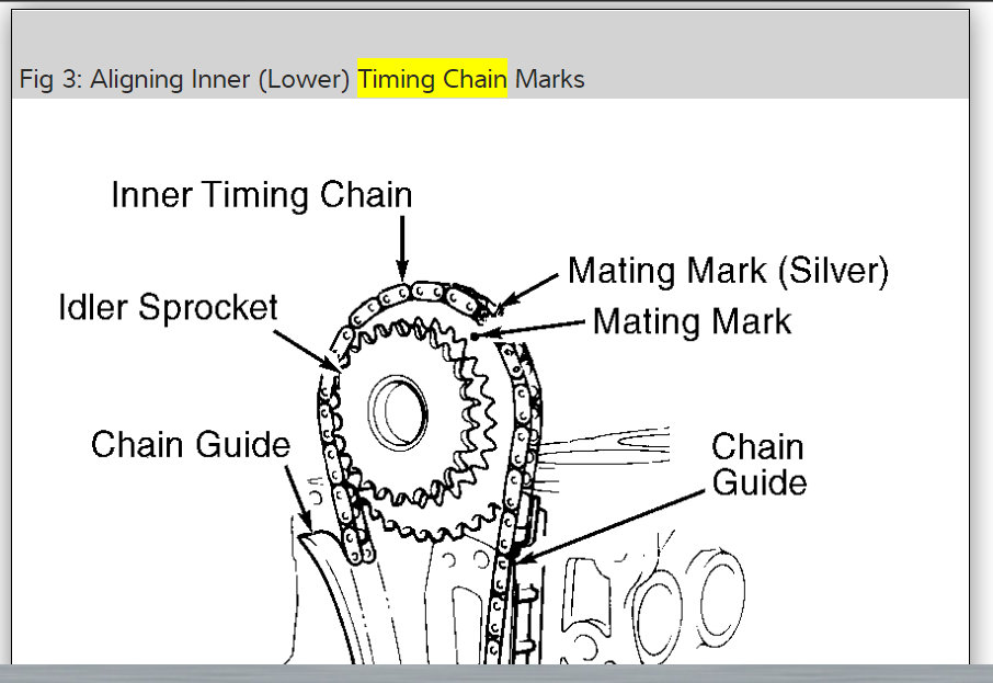

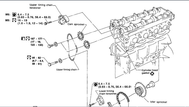

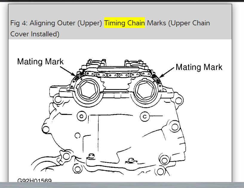

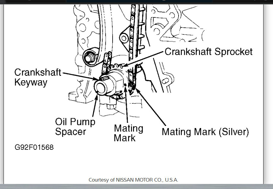

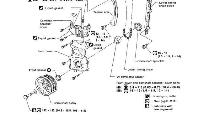

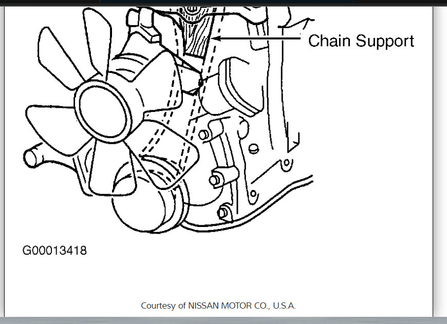

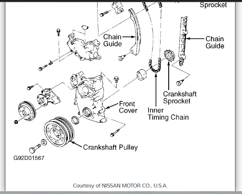

Putting back together a project that someone else had started, replacing the timing (belt? chain?), and don't know how to set the timing. Also do not know which position the cams need to sit at? Like 12 O'clock etc?

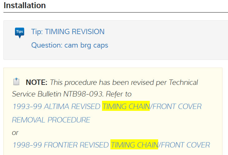

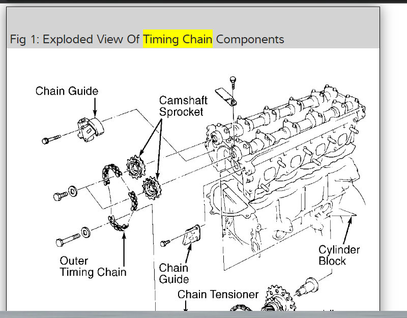

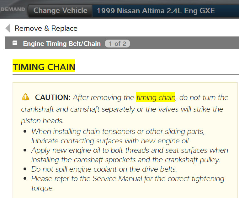

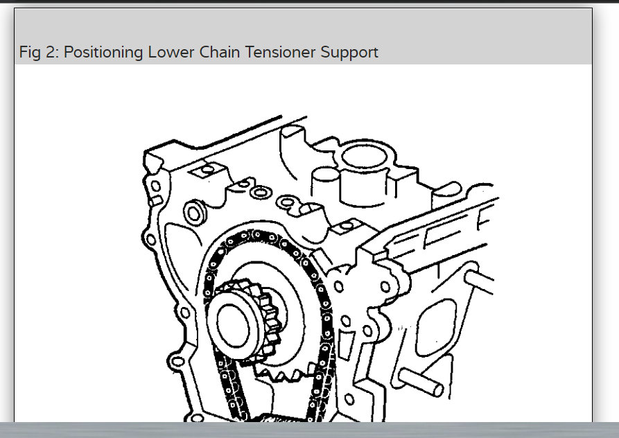

I have included in the diagrams down below the instructions for how to change your vehicle's timing belt. Please go through the guide and get back to us with how everything turns out, or if you have any more questions, or need any more help.
