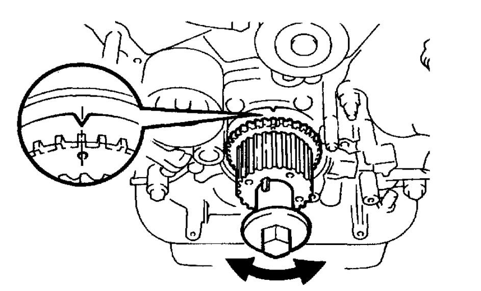

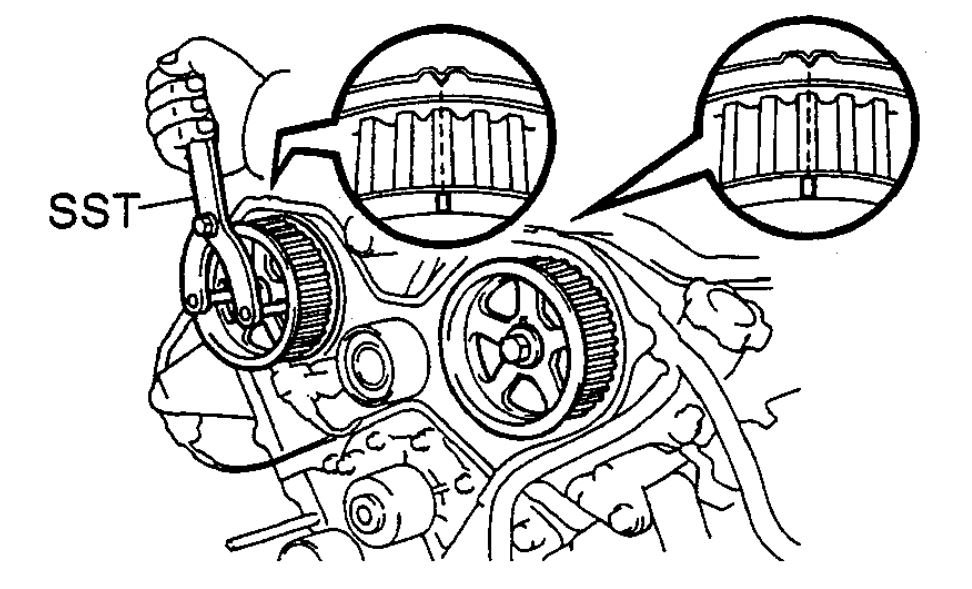

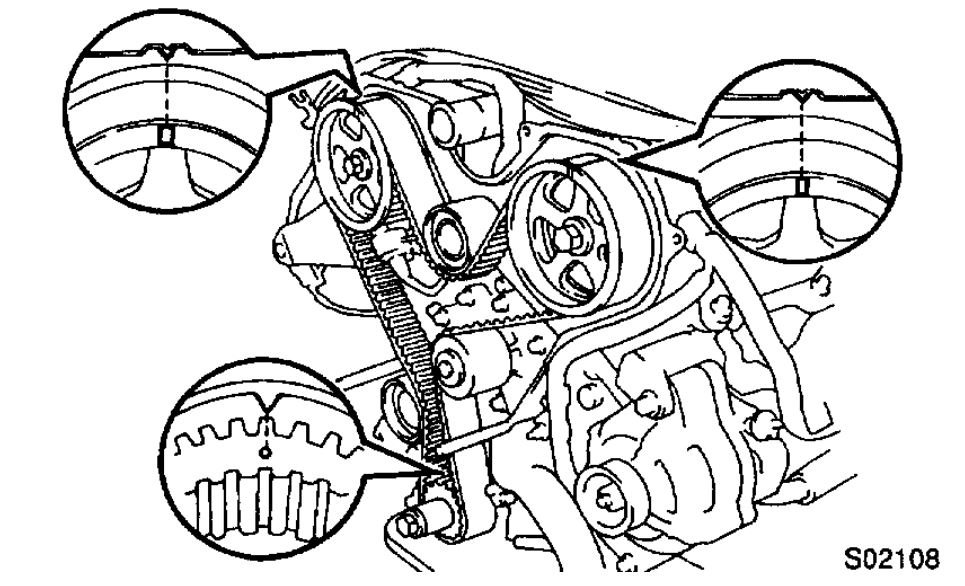

First time replacing water pump and timing. If I get the timing off do I need to take the belt off again to set timing?
Wednesday, December 19th, 2018 AT 3:56 AM
3 Replies
MECHANIC
52,797 POSTS
Good morning,
Yes, if the belt is not installed correctly, it will have to be removed to reset.
