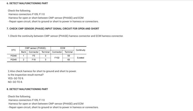

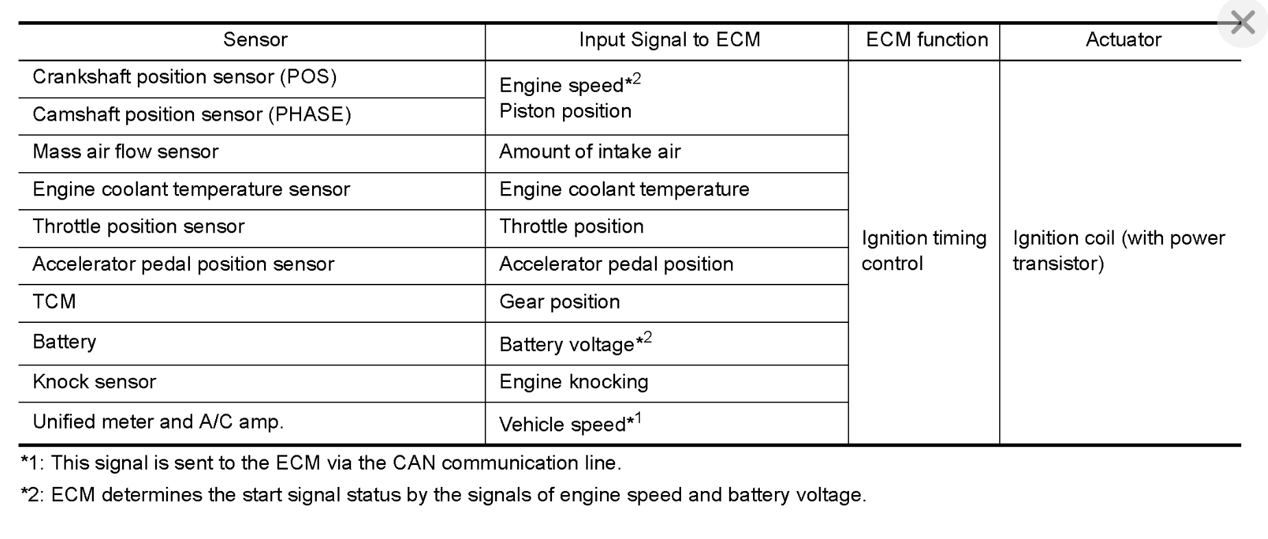

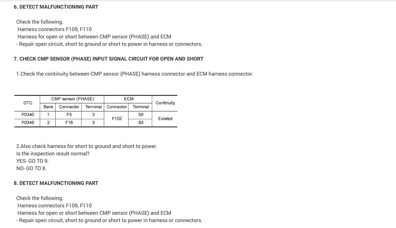

But unhook the camshaft sensor and will start. is there a strong chance my car has jump timing?
Jan 30, 2020 at 8:15 PM
SCGRANTURISMO
  • 4,897 POSTS

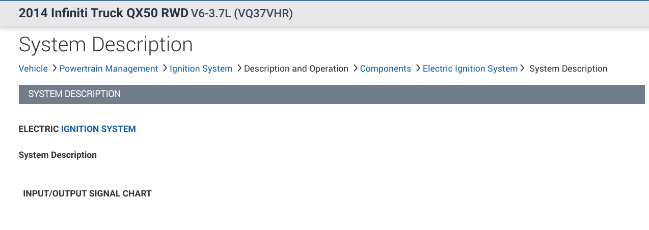

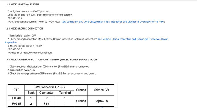

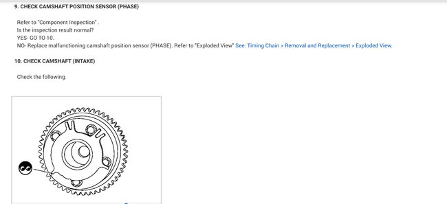

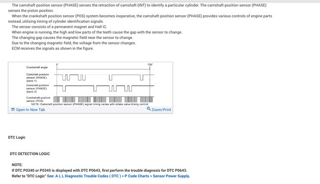

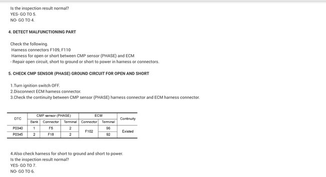

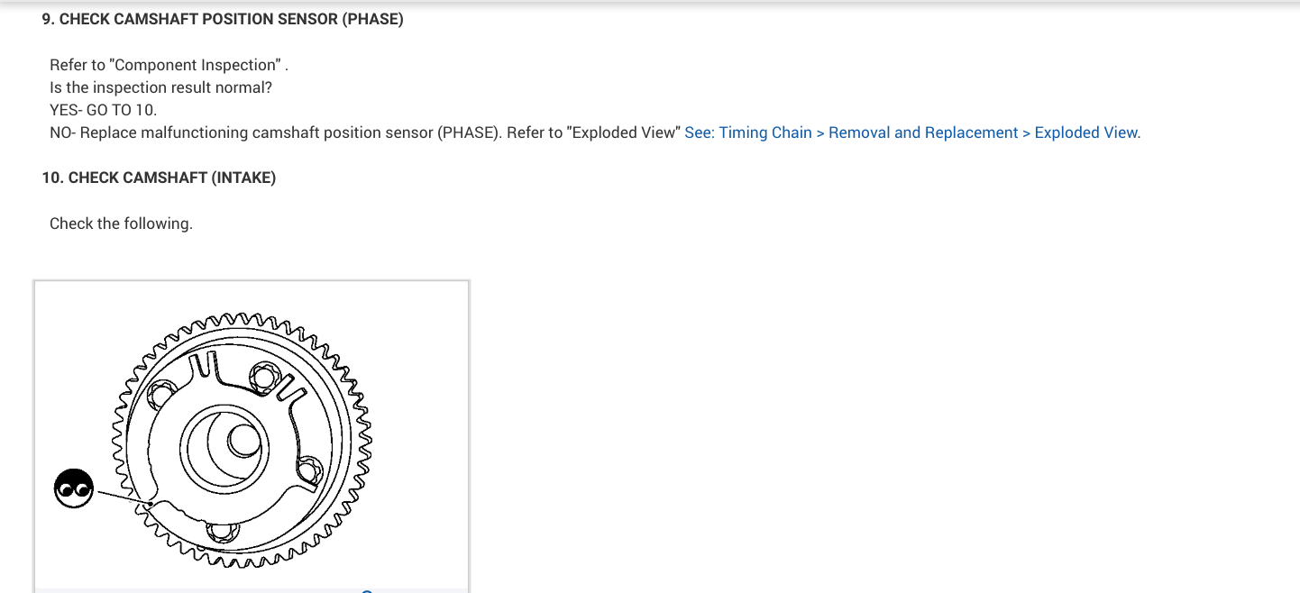

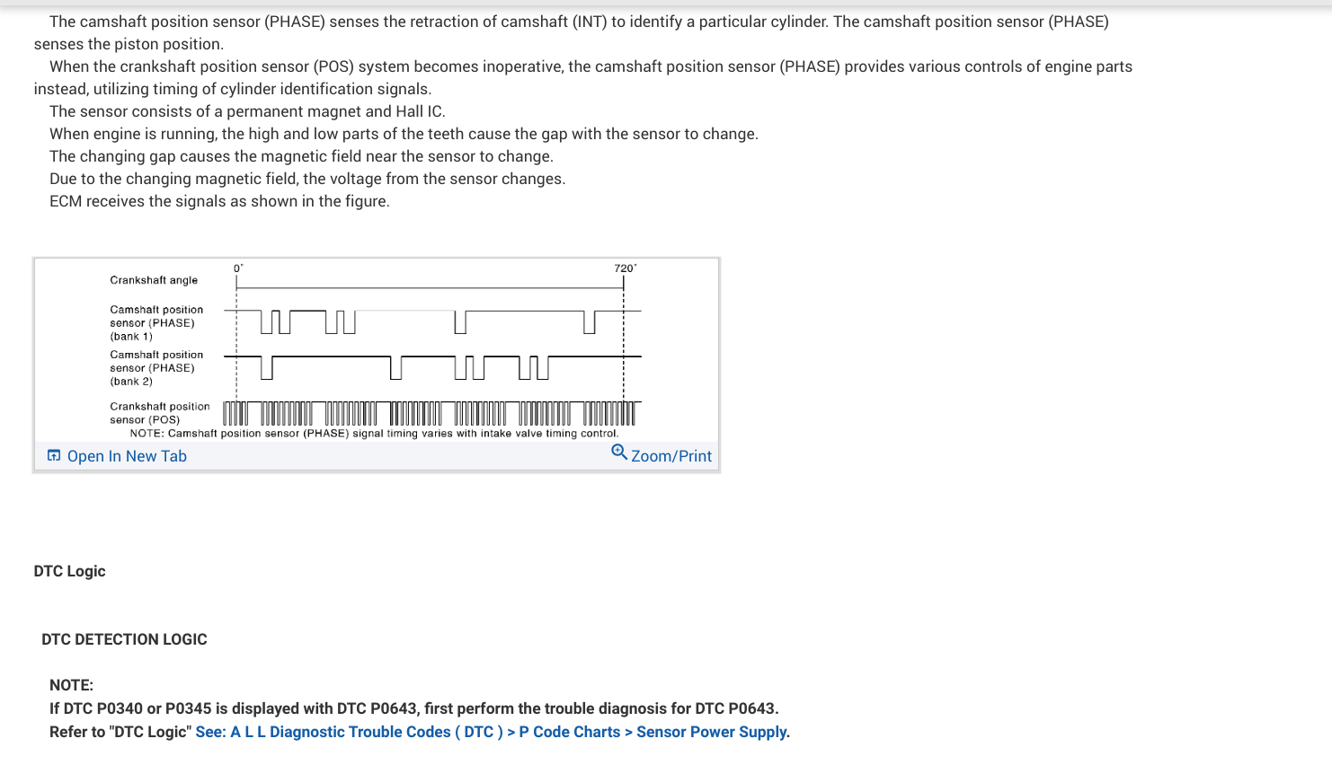

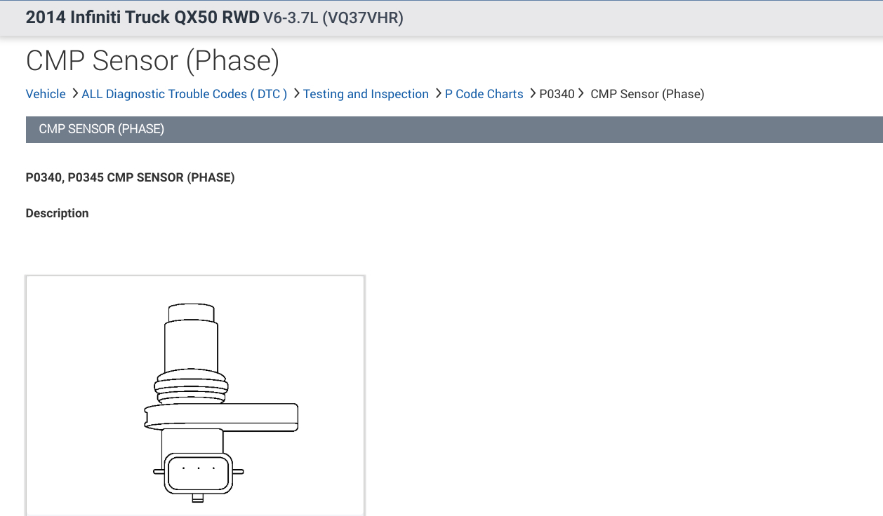

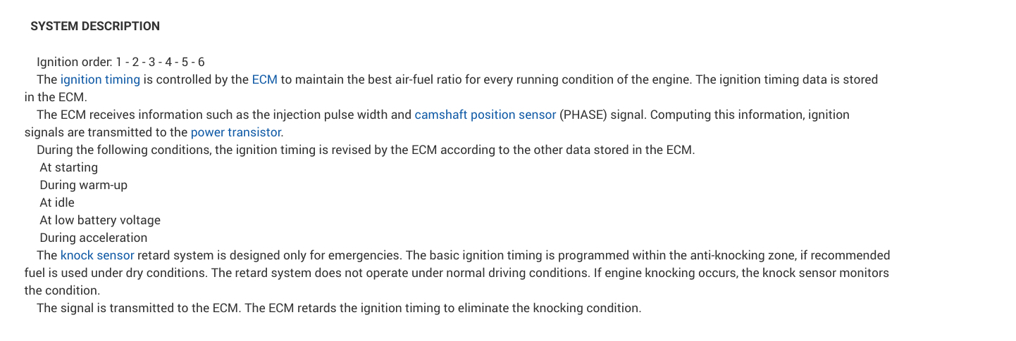

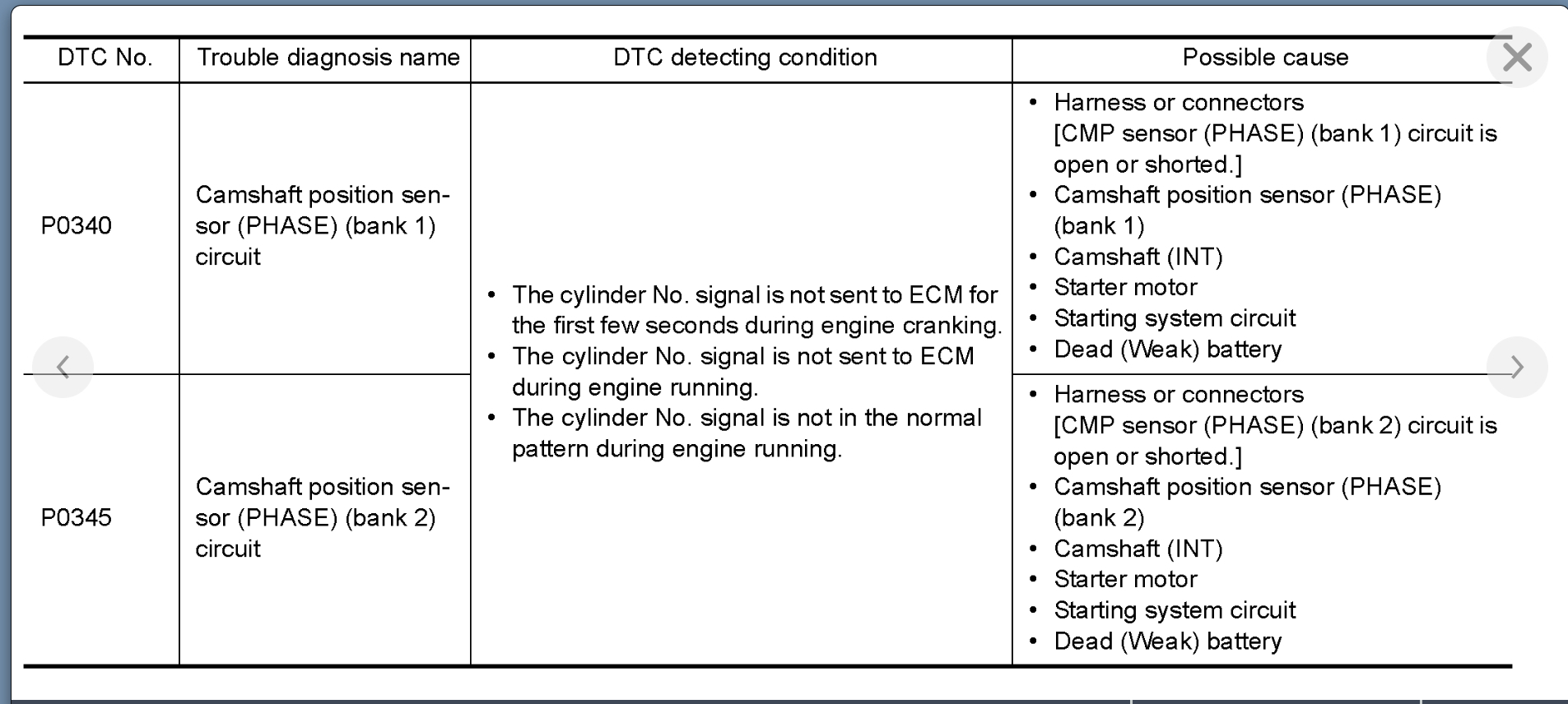

I don't think that this is because your timing chain has jumped time. In the diagrams down below I have included the diagnostic troubleshooting procedures for your vehicle's Camshaft Position Sensor[CMP]. Please go through this guide and get back to us with what you are able to find out.
