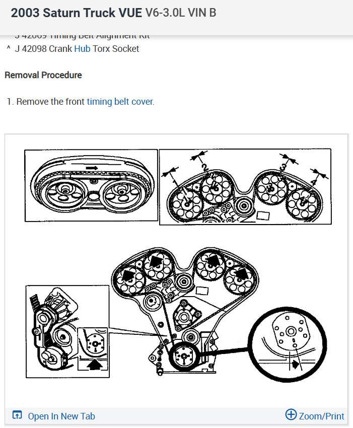

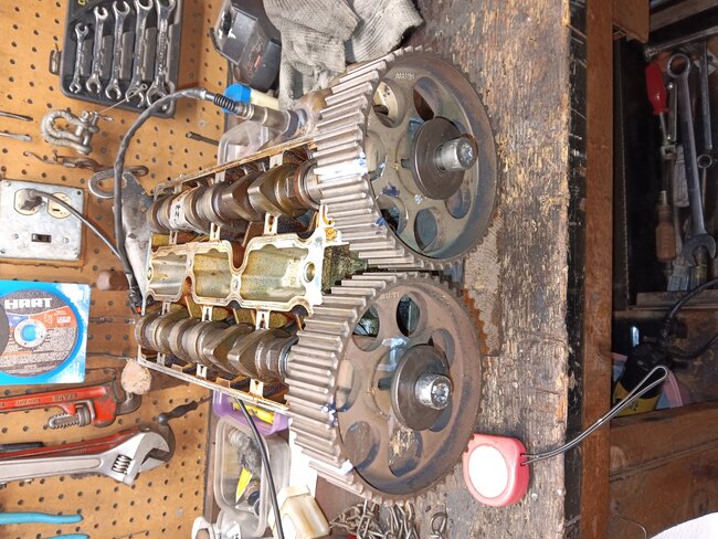

Need to know which way the sprockets go on the camshaft or if it matters.
Feb 14, 2025 at 1:19 AM
  • 55,423 POSTS

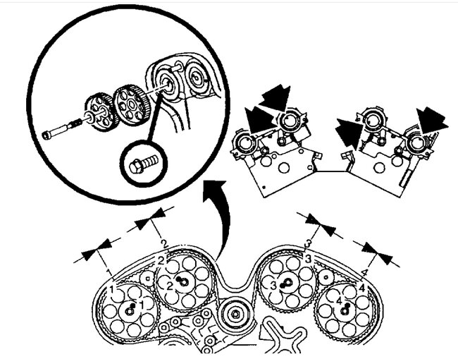

It might not matter; can you see any differences? Here are the diagrams of how the sprockets go on the camshafts. Check out the images (below). Please upload pictures or videos in your response of any problems so we can see what to help you with.

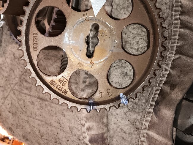

I need to know with way the dowel on the cam is pointed in the notch in the sprocket.

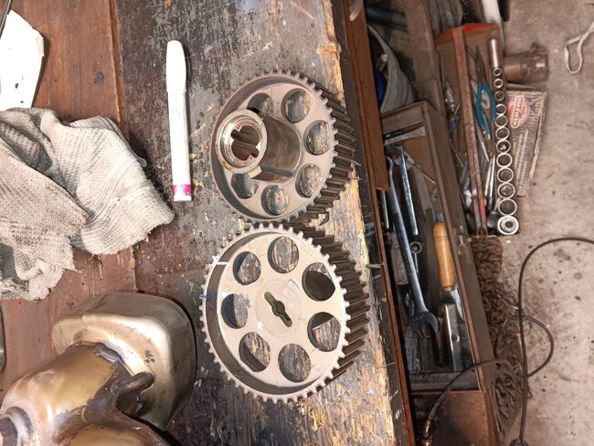

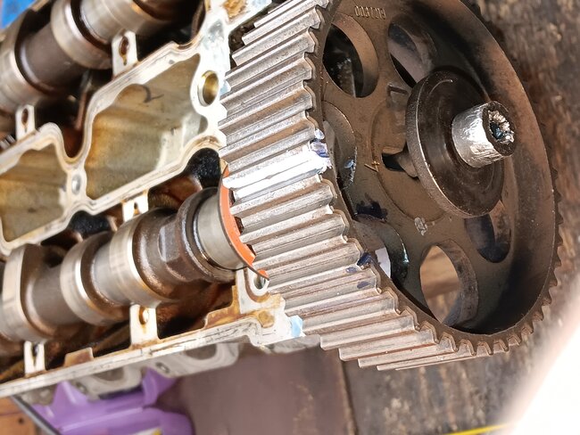

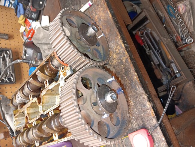

Here is some pictures.

I can see in one of the images the sprocket has a number 4 do the rest have numbers as well? If so, you can see the numbers in the diagrams I provided. Here is another diagram, zoom in you can see the dowels.

Does the number on cam gear go to the dial pin?
Feb 20, 2025 at 5:09 AM
  • 55,423 POSTS
The numbers should stick out.

This is the #3 camshaft pulley does the dial pin go where the arrow is pointing?

Correct, and you will use the #3 timing mark as well, they used one sprocket of two positions, 3 and 4.

Thanks, I got it now.
