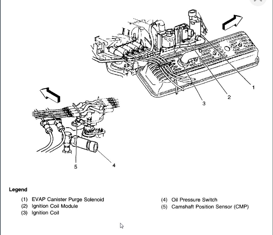

When I give it gas it loses power and runs rough. changed the spark plugs still no change.

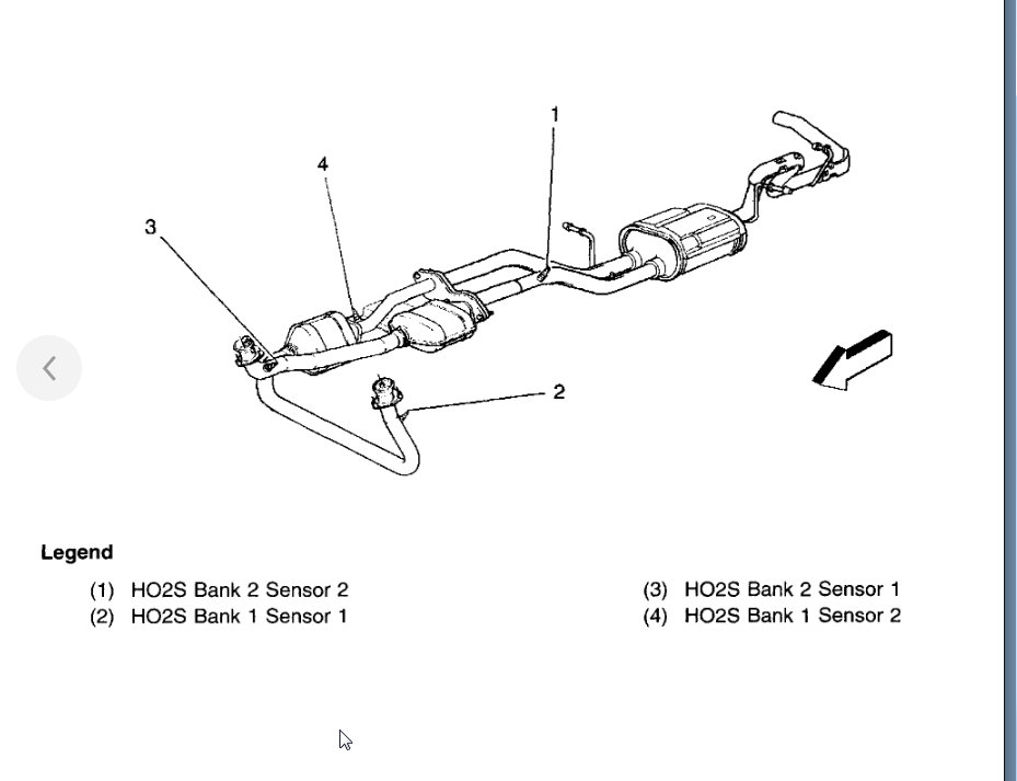

All four O2 sensors are bad and camshaft sensor location.
Aug 11, 2019 at 10:56 AM
Attached are the o2 sensor locations and the camshaft sensor location which is the top rear center of the engine. Let me know if you need more information. Thanks
