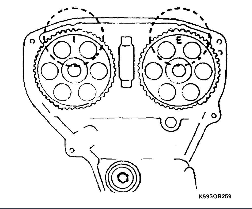

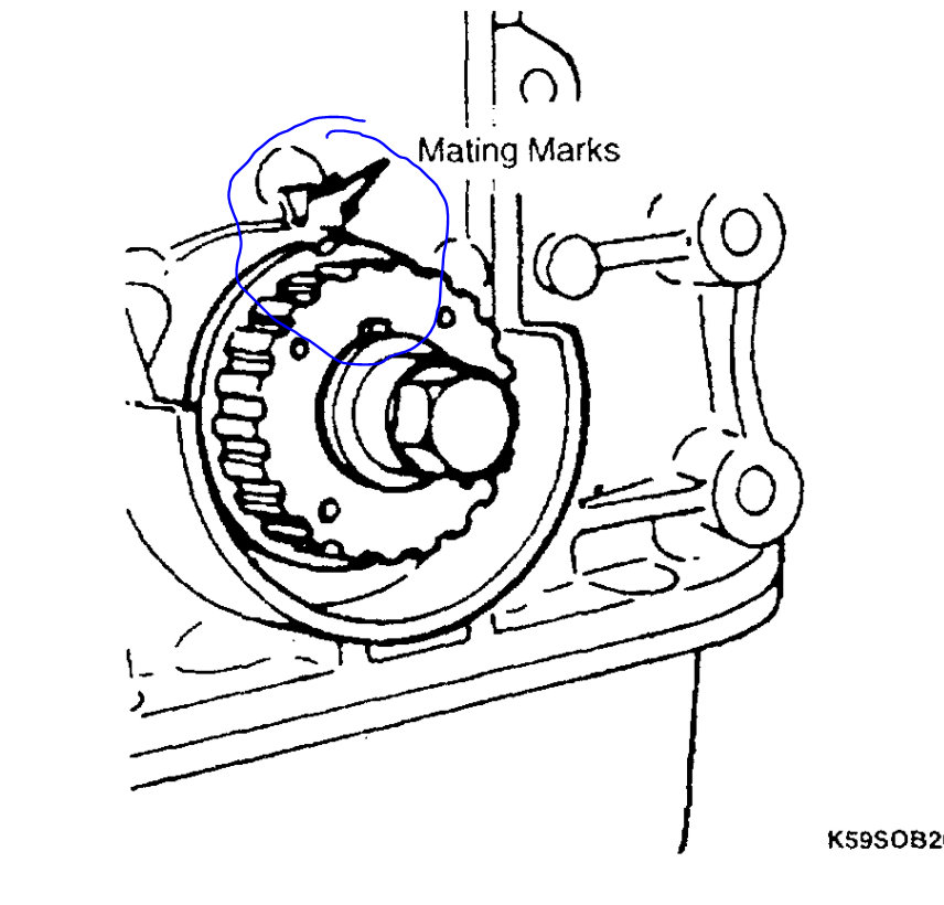

All i need to know is how do i reset the timing on my vehicle listed above.

Good afternoon,
I attached the procedure for the timing belt and the marks that need to be aligned.
If your belt moved, once you install the belt, you will have to do a compression test to be sure there are no damaged valves as this is an interference motor.
The marks are attached below that have to match up.
