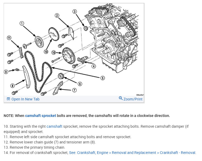

where are the timing marks?
2008 CHRYSLER SEBRING
134,025 MILES • 2.7L • V6 • AUTOMATIC
WILLIAM7899
Timing marks.
Dec 12, 2021 at 11:37 AM
SQM
  • 6,383 POSTS

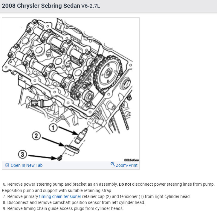

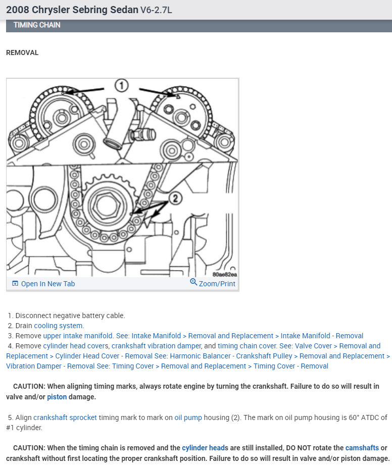

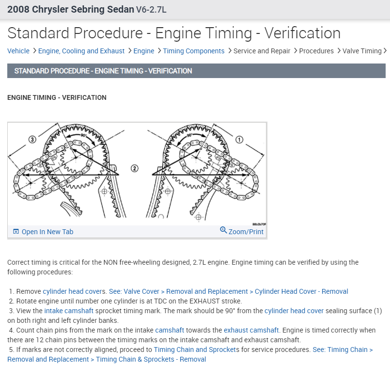

The timing marks are on the camshaft sprocket and the crankshaft sprocket.
The timing cover needs to be removed in order to verify the timing.
I have attached diagrams that show the timing mark locations, for your reference.
Also included is the timing set verification for the 2.7L engine.
