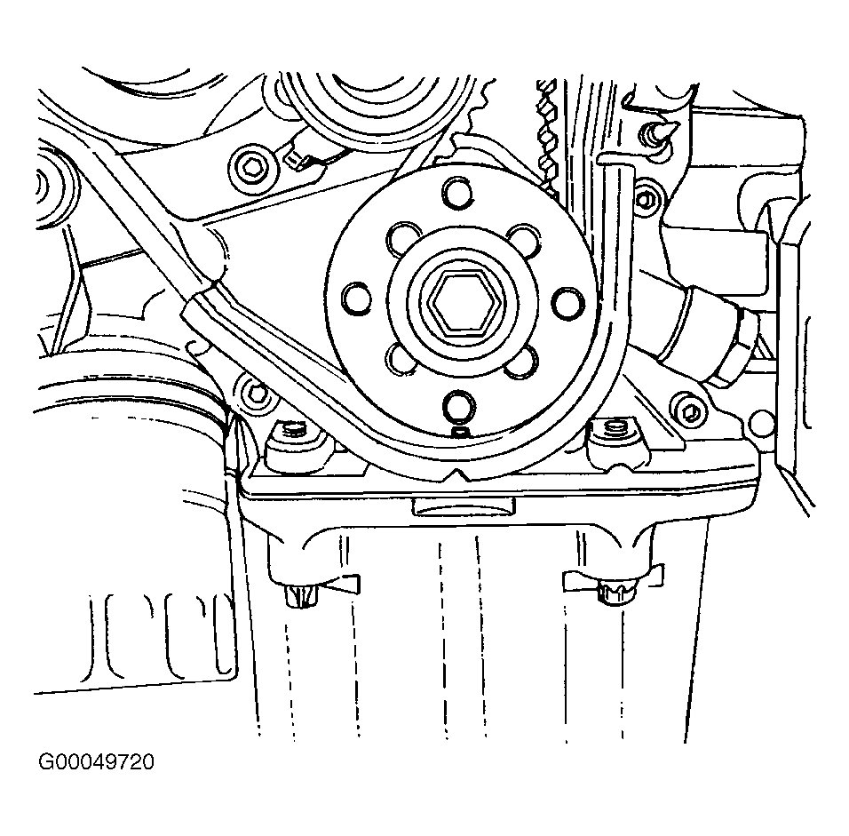

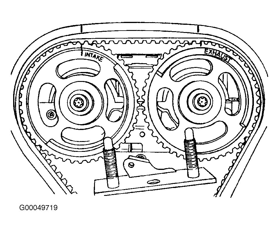

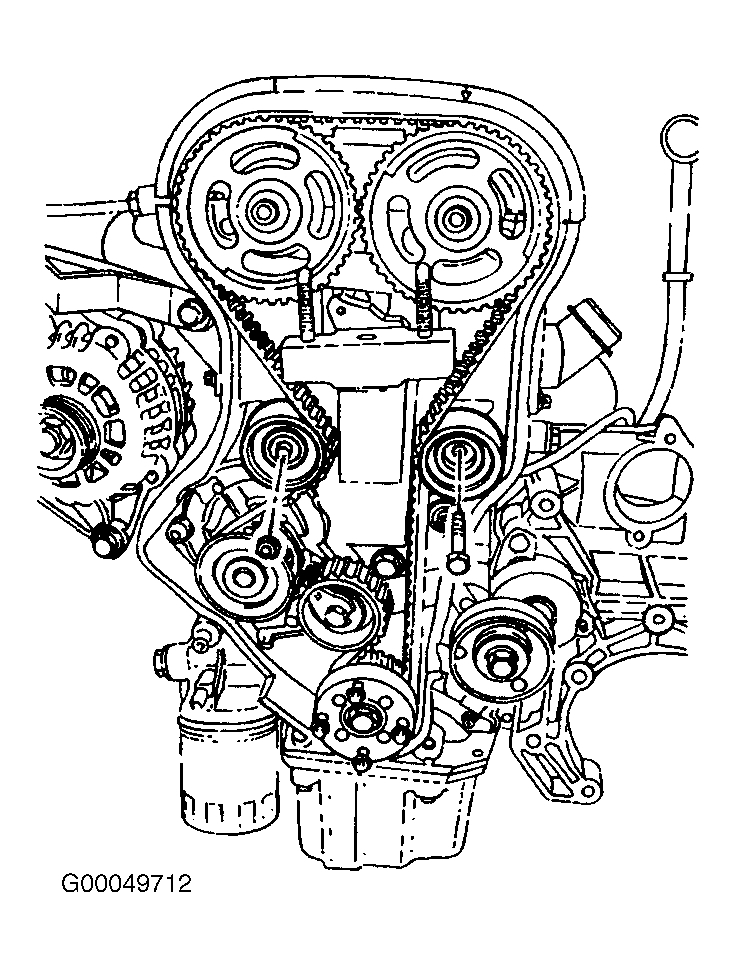

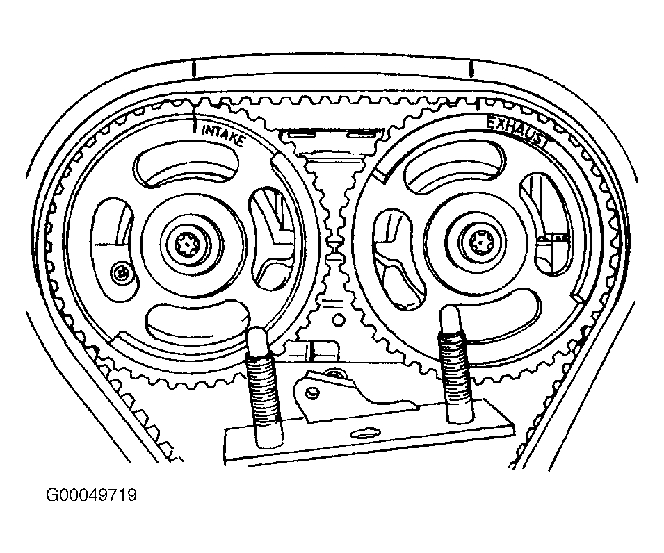

How to do the timing should key in crank shaft be pointing up or down?

There should be a notch in the crank pulley that points toward the mark on the lower cover. Basically straight down. Here is the company pictures.
