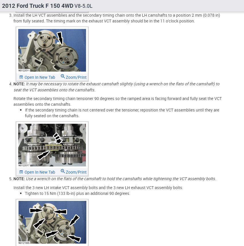

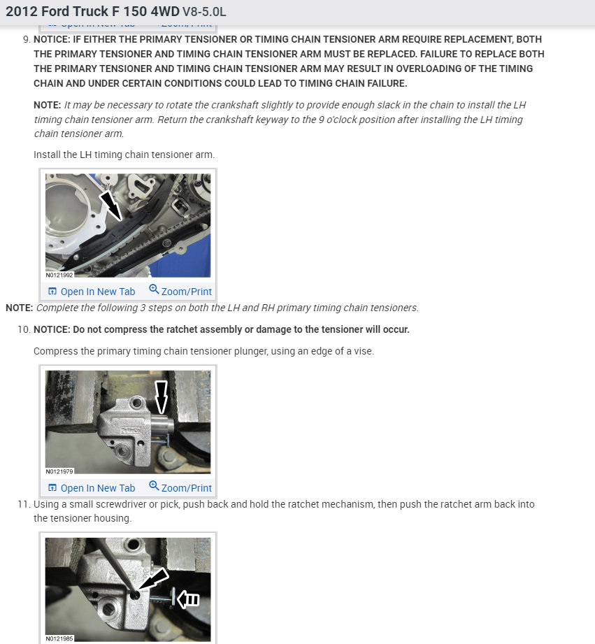

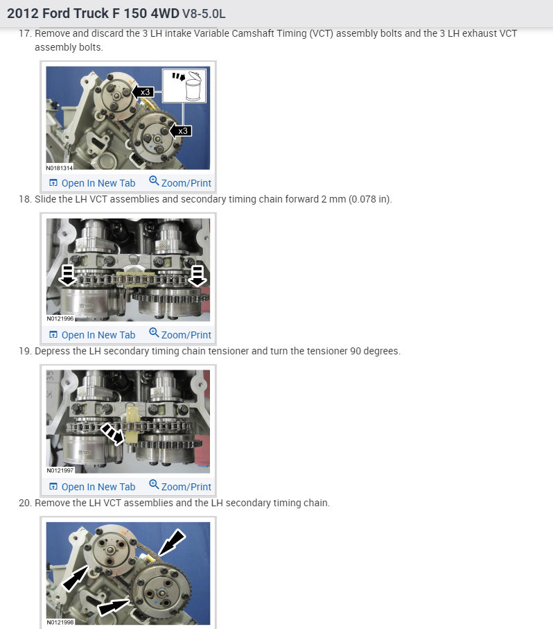

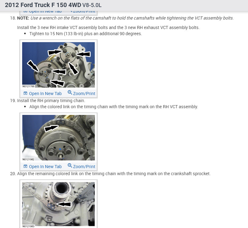

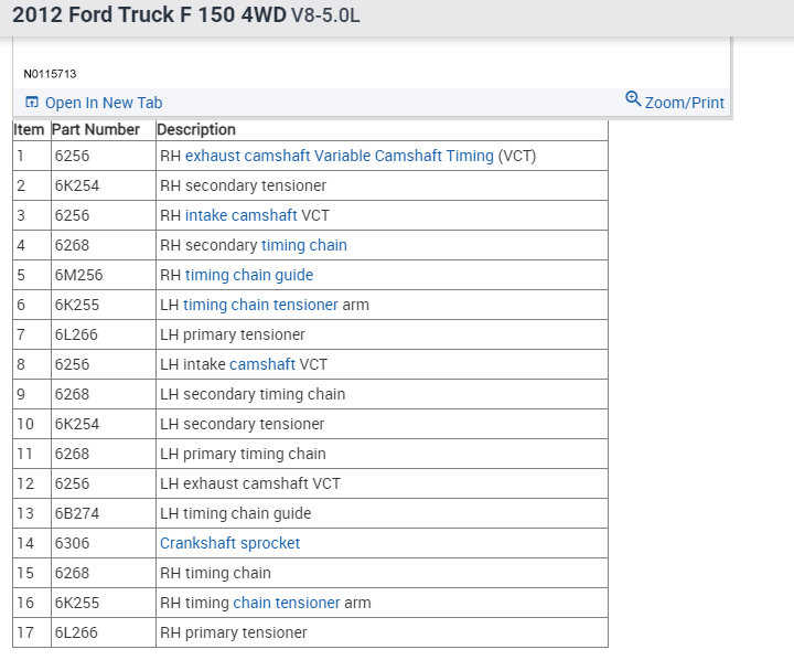

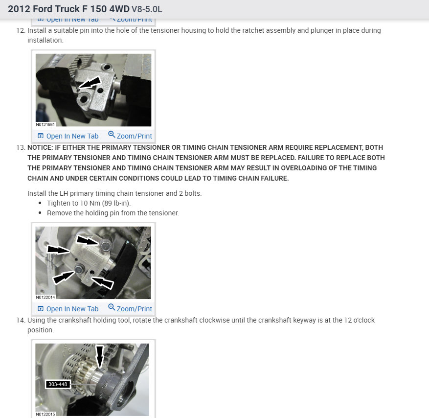

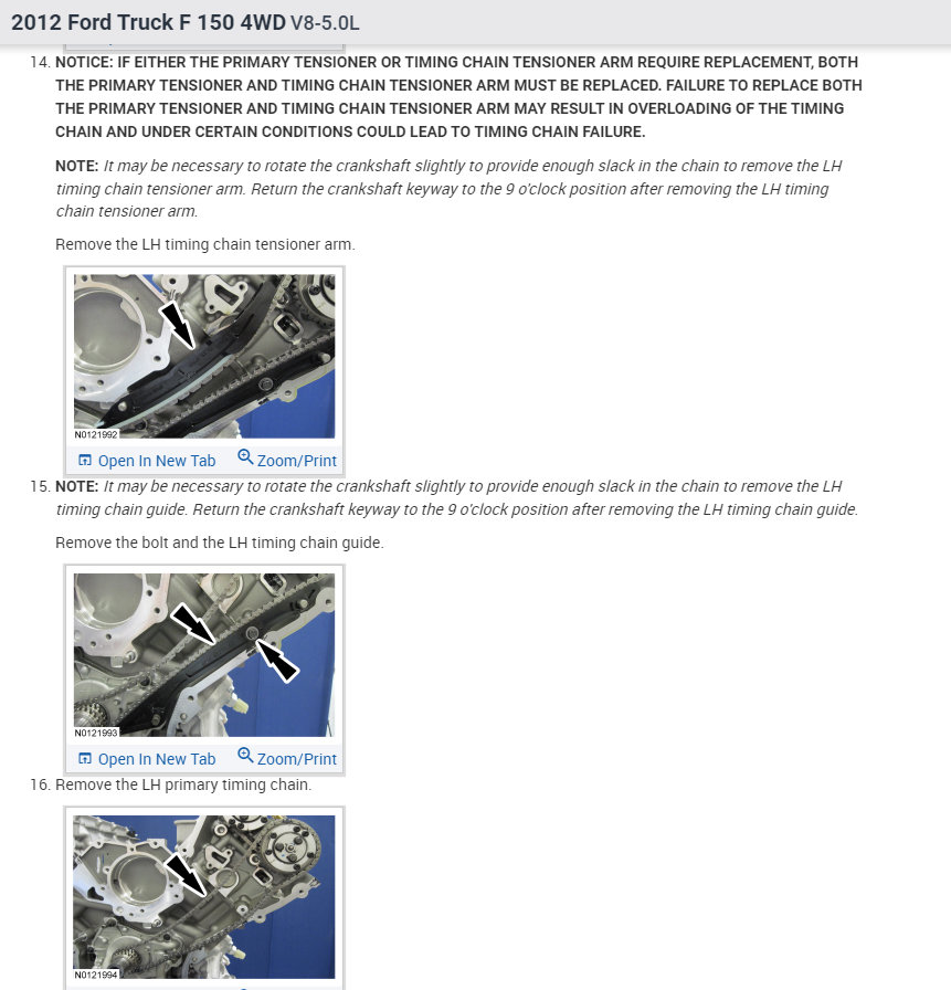

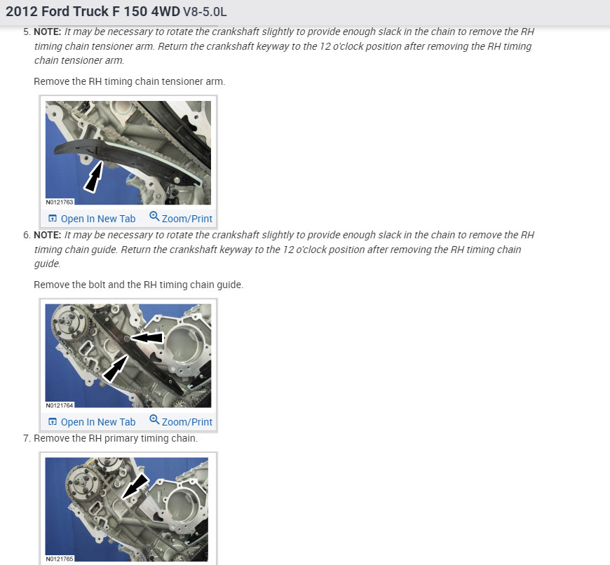

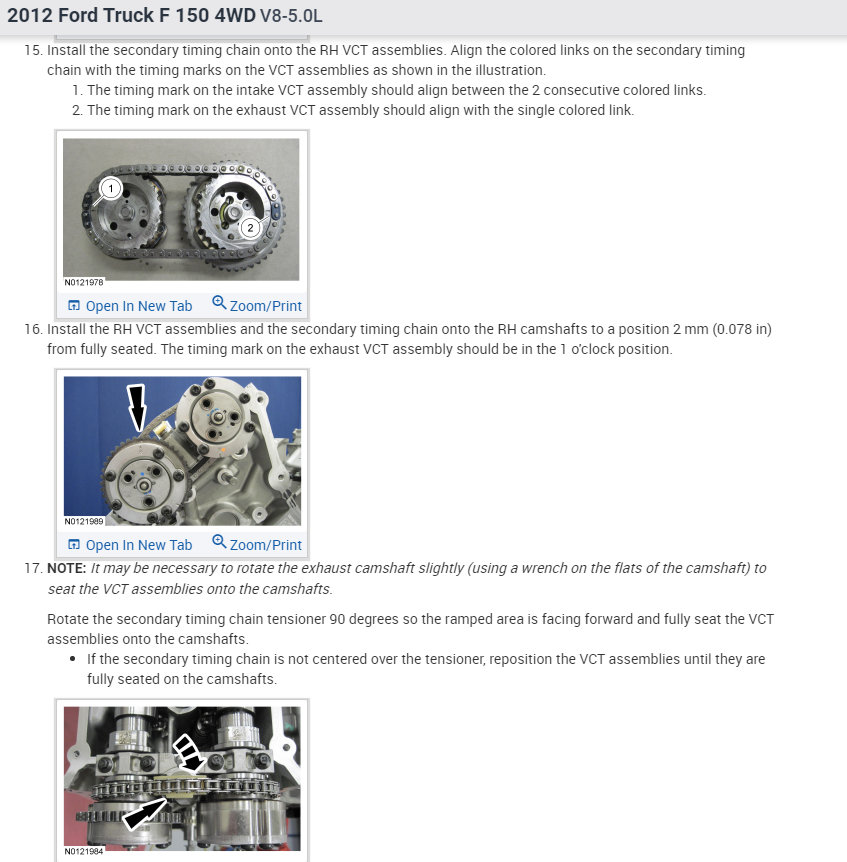

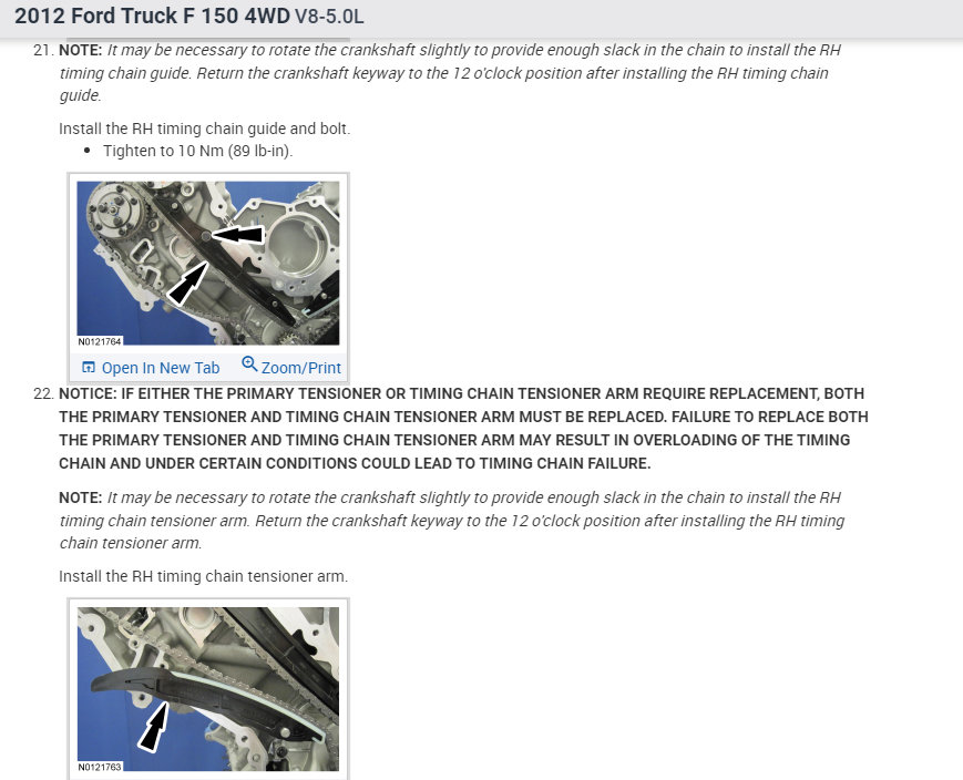

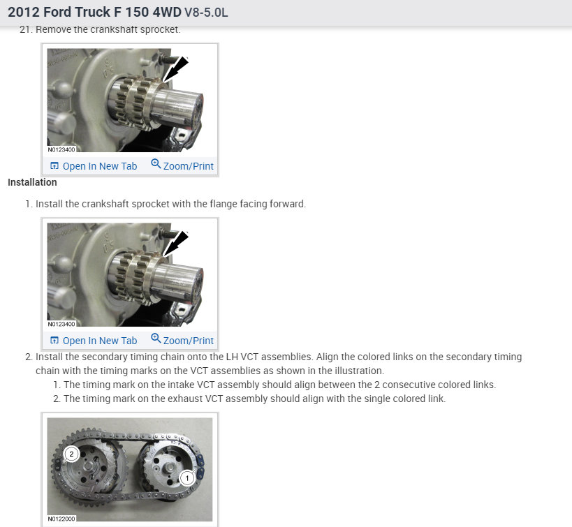

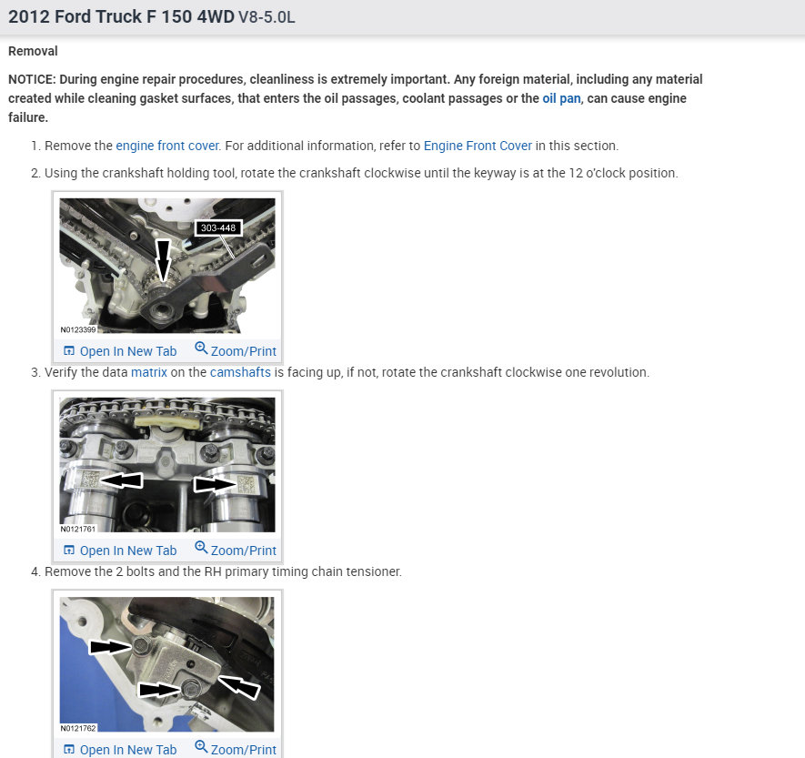

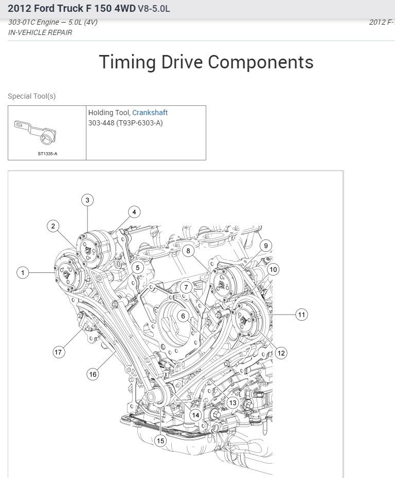

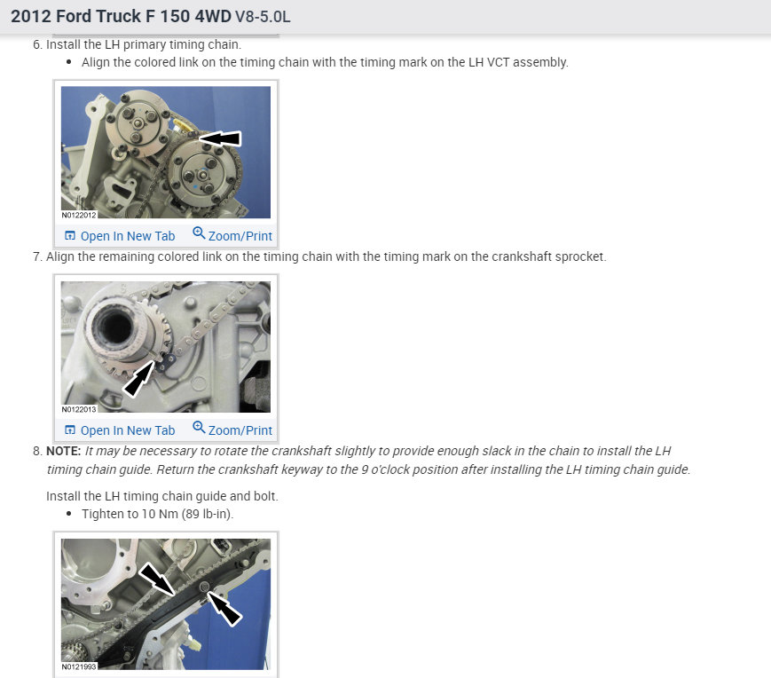

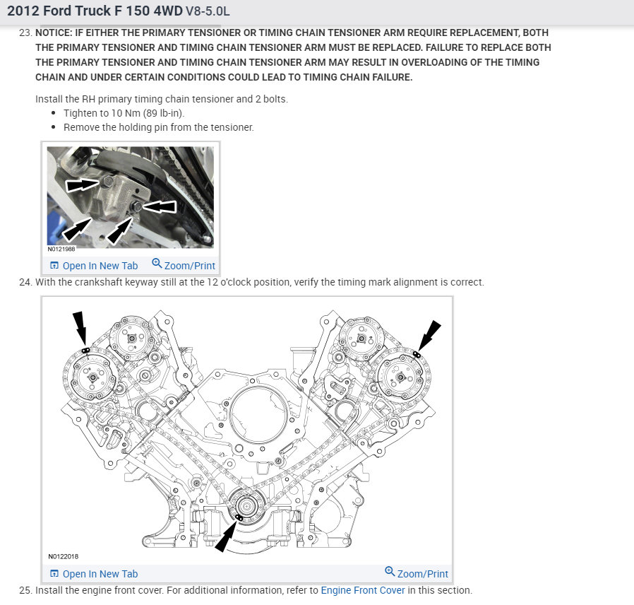

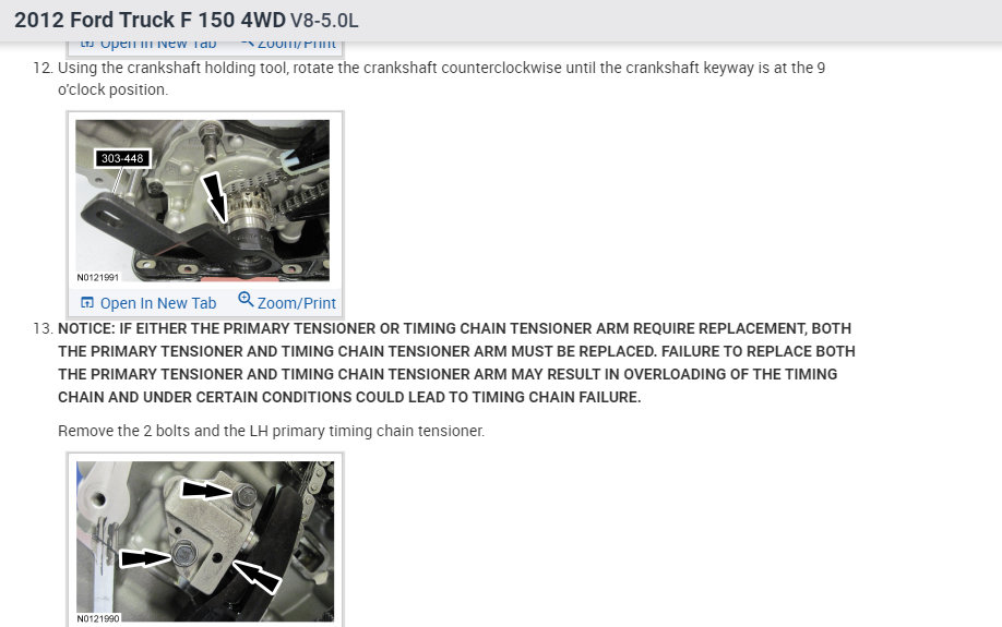

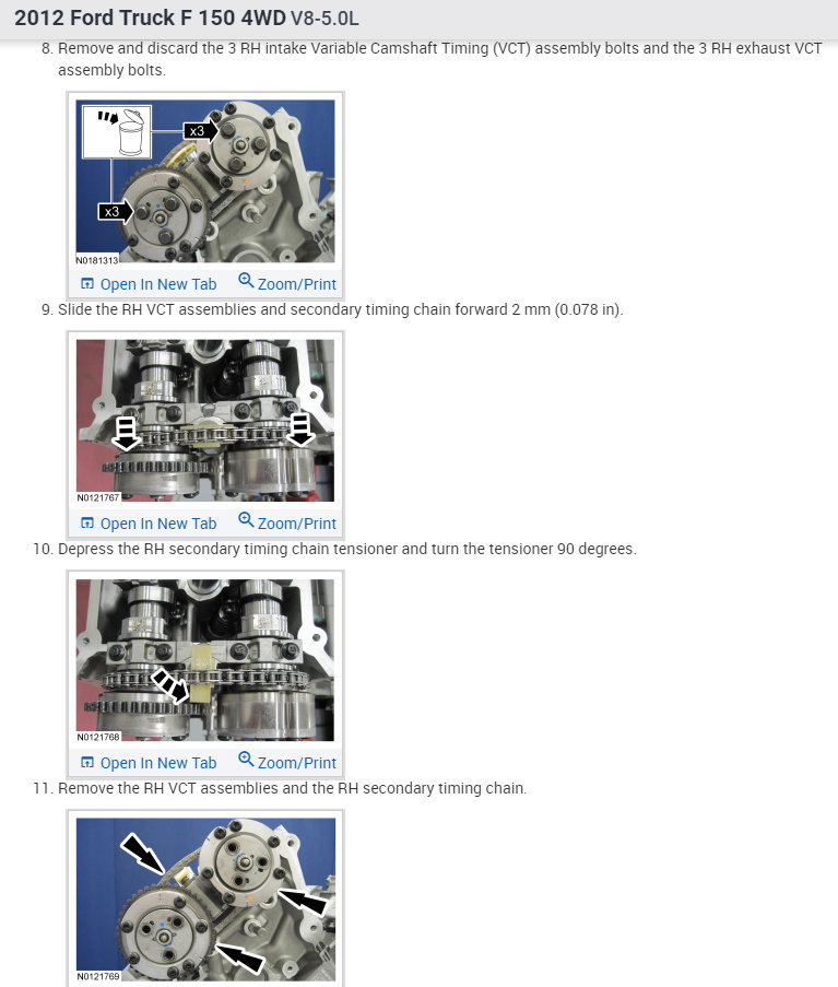

Need timing mark diagram for the truck listed above.
May 20, 2022 at 8:46 PM
SQM
  • 6,383 POSTS
There are a few steps that need to be completed in order to get the timing mark properly.
I have attached the complete timing chain procedure including all the marks and steps below. That way you can get the information you need.
Let me know of any questions.
