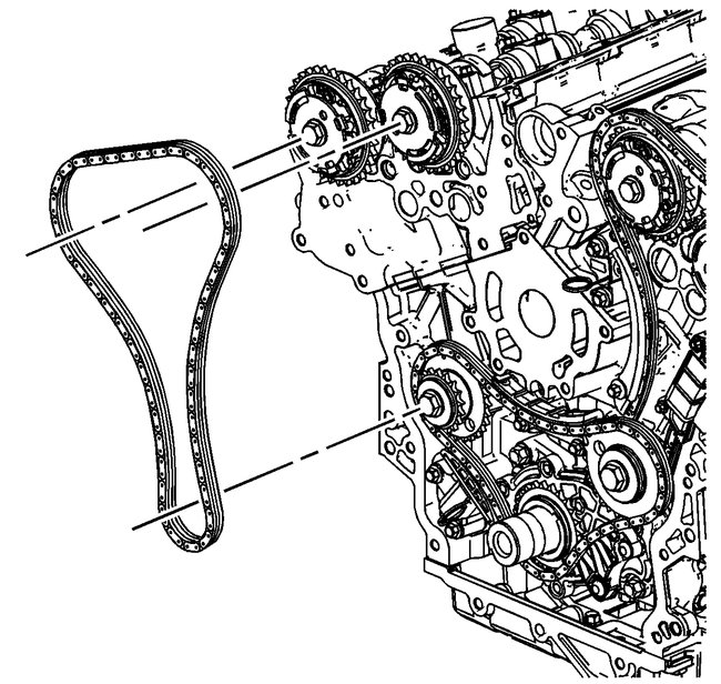

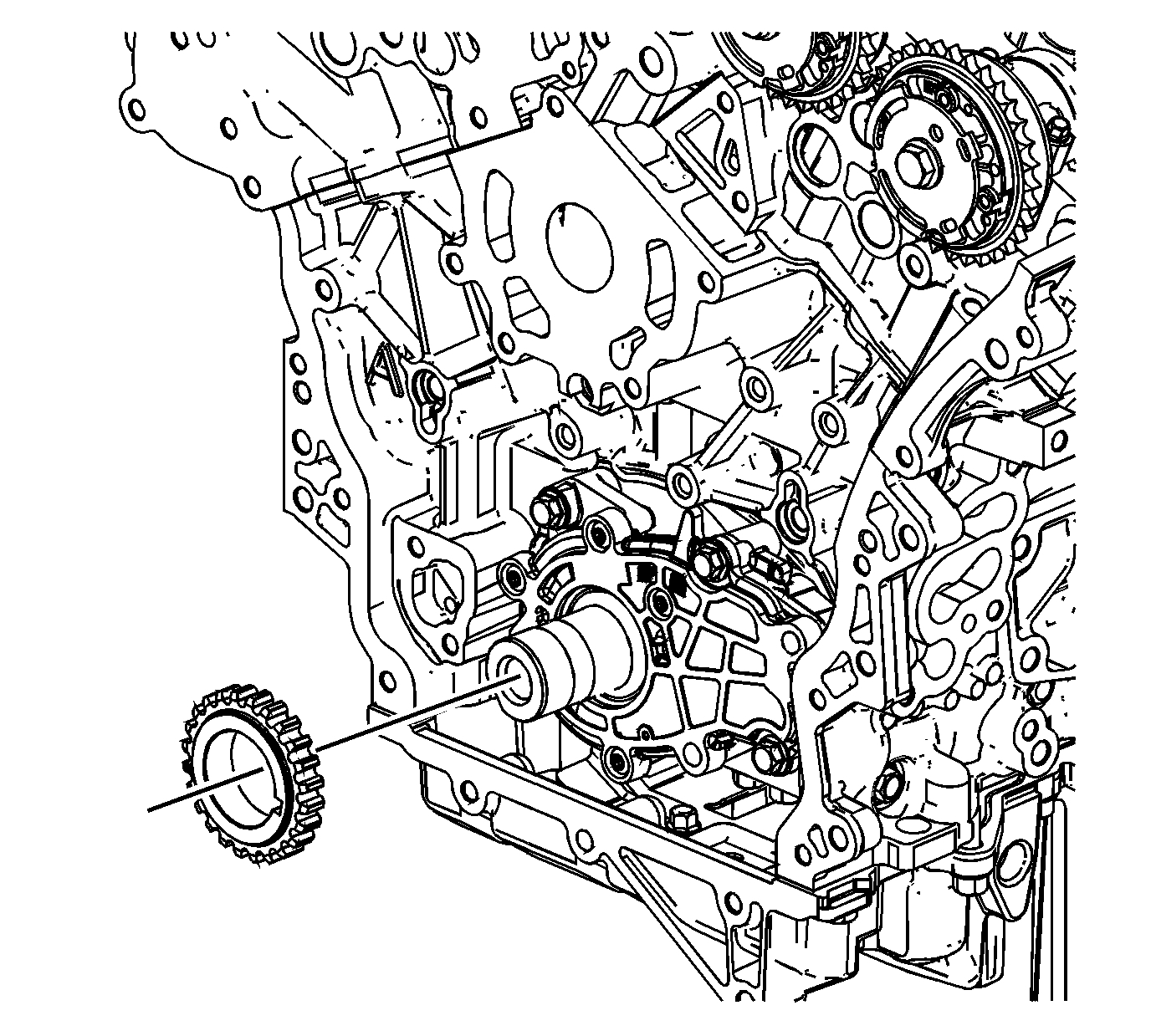

I am getting ready to changing the timing chain on my vehicle and I was wondering which side do you start on. Side one or side too from the tear down.
Oct 6, 2018 at 10:08 AM
  • 110,241 POSTS

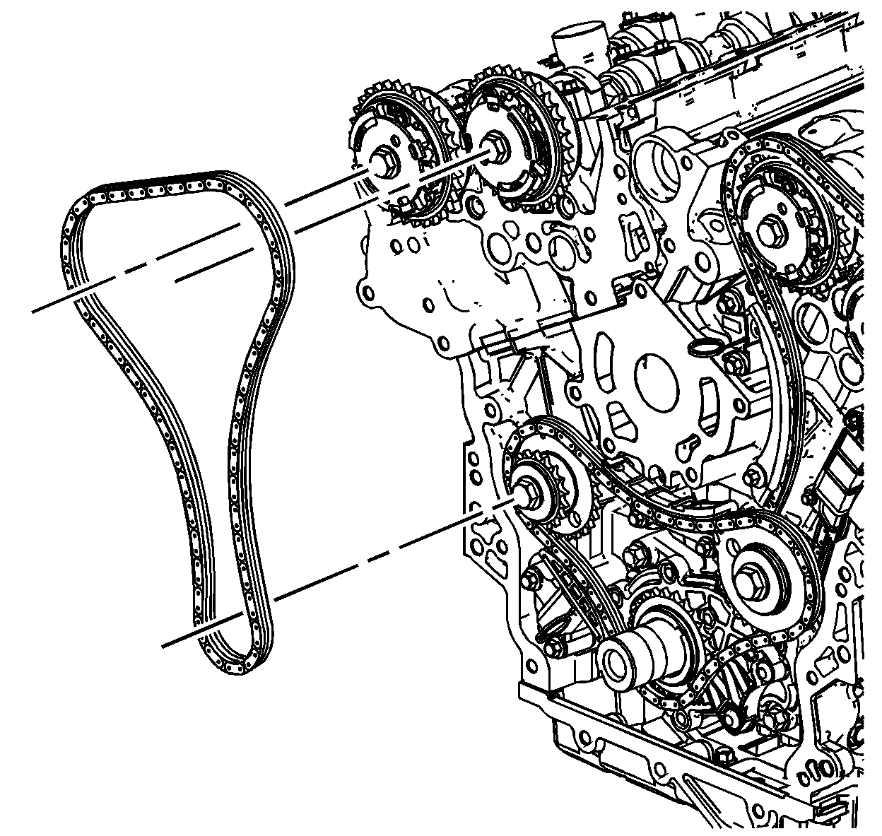

The right side (passenger side) cam chain has to come off first and is installed last. Take a look at picture 1. It shows how the chains are in place. Here are the directions. The directions are for the primary chain, left cam and right cam. Starting with picture 2, all pictures correlate with these directions.
_________________________
Primary Camshaft Drive Chain and Sprockets Replacement
Special Tools
EN 46111 Crankshaft Rotation Socket
Removal Procedure
1. Remove the engine front cover. Refer to Engine Front Cover Replacement (See: Timing Cover > Removal and Replacement > Engine Front Cover Replacement).
2. Remove the spark plugs in order to ease crankshaft/engine rotation. Refer to Spark Plug Replacement (See: Spark Plug > Removal and Replacement).
3. Remove the right bank secondary camshaft drive chain tensioner. Refer to Secondary Timing Chain Tensioner Removal - Right Side (See: Engine > Overhaul).
4. Remove the right bank secondary camshaft drive chain shoe. Refer to Secondary Camshaft Drive Chain Shoe Removal - Right Side (See: Engine > Overhaul).
5. Remove the right bank secondary camshaft drive chain guide. Refer to Secondary Timing Chain Guide Removal - Right Side (See: Engine > Overhaul).
6. Remove the right bank secondary camshaft drive chain. Refer to Secondary Camshaft Intermediate Drive Chain Removal - Right Side (See: Engine > Overhaul).
7. Remove the primary camshaft drive chain tensioner. Refer to Primary Camshaft Intermediate Drive Chain Tensioner Removal (See: Engine > Overhaul).
8. Remove the primary camshaft drive chain upper guide. Refer to Primary Timing Chain Guide Removal - Upper (See: Engine > Overhaul).
9. Remove the primary camshaft timing chain. Refer to Secondary Camshaft Intermediate Drive Chain Removal - Right Side (See: Engine > Overhaul).
10. Remove the crankshaft sprocket from the nose of the crankshaft.

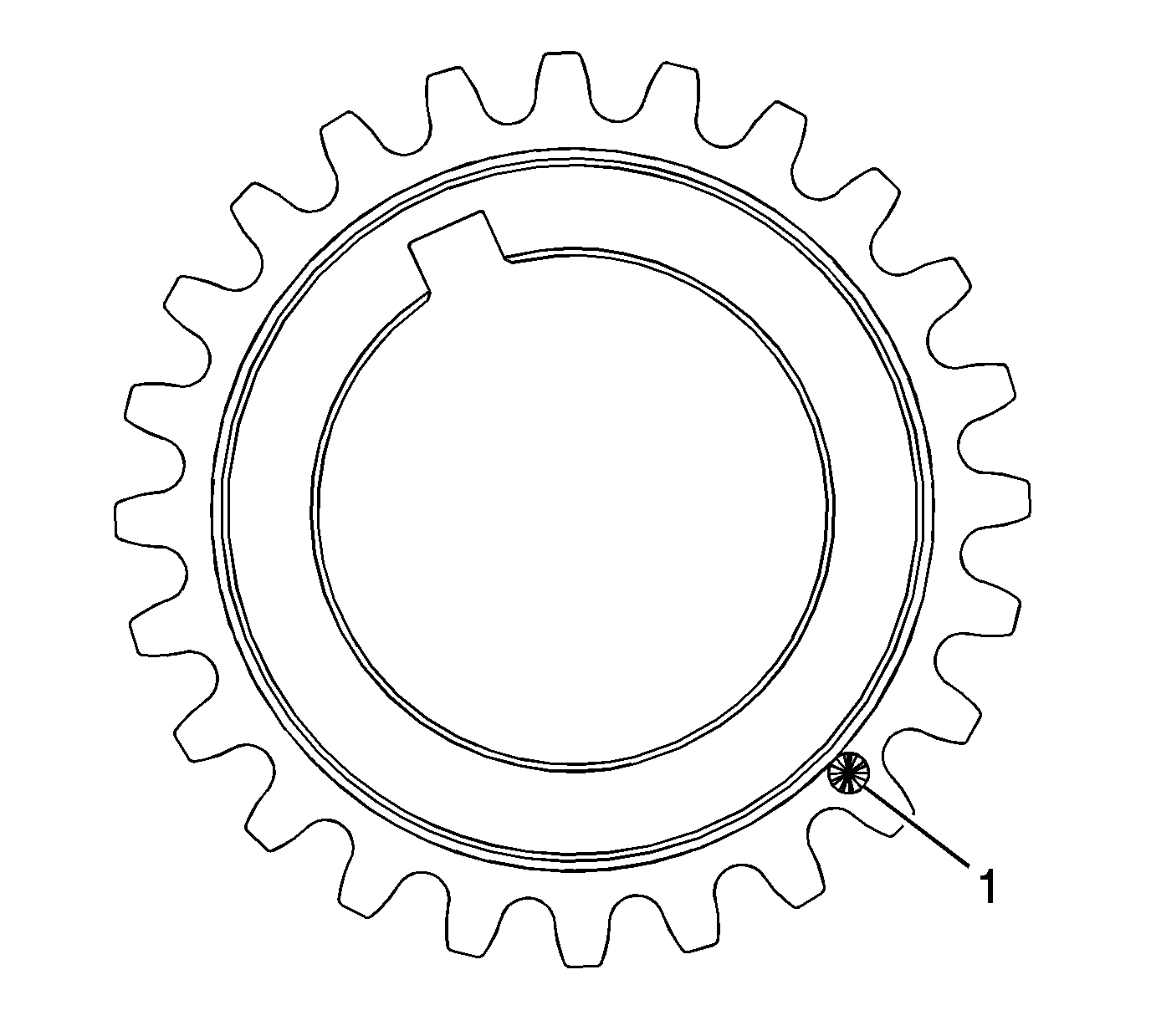

1. Ensure the crankshaft sprocket is installed with the timing mark (1) visible.
2. Install the crankshaft sprocket on to the nose of the crankshaft.
3. Align the notch in the crankshaft sprocket with the pin in the crankshaft.
4. Slide the crankshaft sprocket on the crankshaft nose until the crankshaft sprocket contacts the step in the crankshaft.

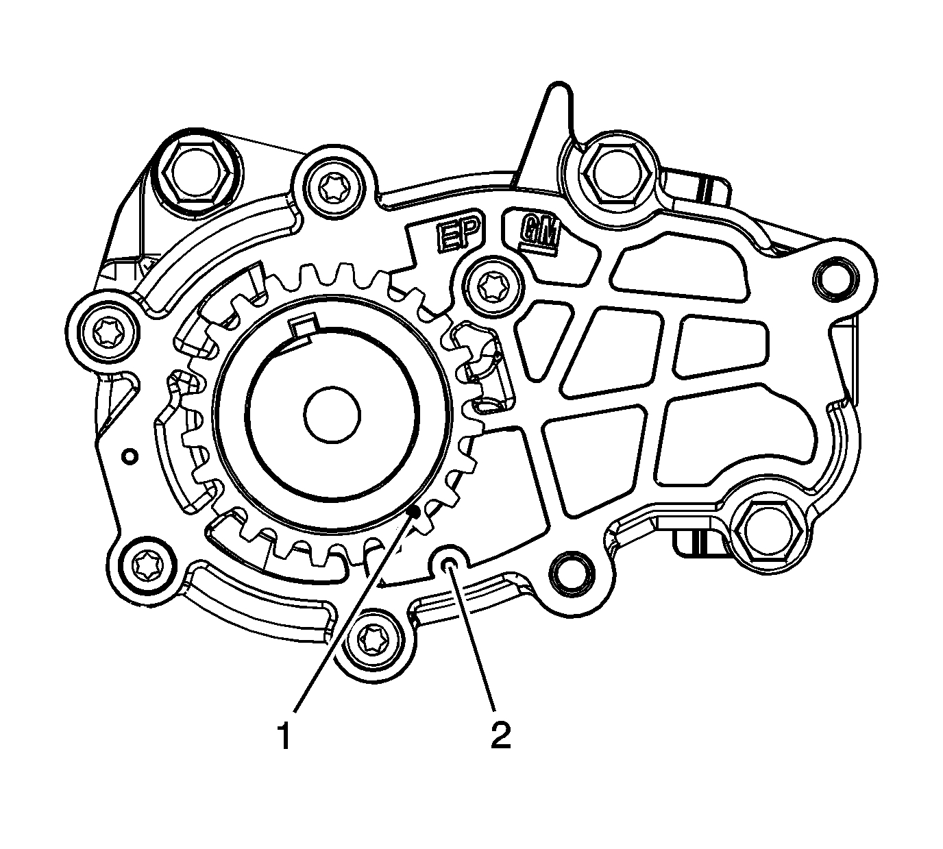

5. Ensure the crankshaft is in the stage one timing position with the crankshaft sprocket timing mark (1) aligned to the stage one timing mark on the oil pump cover (2) using the EN 46111 . Refer to Timing Chain Alignment Diagram (See: Timing Component Alignment Marks > Components) - Stage One.
6. Install the primary camshaft timing chain. Refer to Primary Camshaft Intermediate Drive Chain Installation (See: Engine > Overhaul).
7. Install the primary upper camshaft drive chain guide. Refer to Primary Timing Chain Guide Installation - Upper (See: Engine > Overhaul).
8. Install the primary camshaft drive chain tensioner. Refer to Primary Camshaft Intermediate Drive Chain Tensioner Installation (See: Engine > Overhaul).
9. Install the right bank secondary camshaft drive chain. Refer to Secondary Camshaft Intermediate Drive Chain Installation - Right Side (See: Engine > Overhaul).
10. Install the right bank secondary camshaft drive chain guide. Refer to Secondary Timing Chain Guide Installation - Right Side (See: Engine > Overhaul).
11. Install the right bank secondary camshaft drive chain shoe. Refer to Secondary Camshaft Drive Chain Shoe Installation - Right Side (See: Engine > Overhaul).
12. Install the right bank secondary camshaft drive chain tensioner. Refer to Secondary Timing Chain Tensioner Installation - Right Side (See: Engine > Overhaul).
13. Install the spark plugs. Refer to Spark Plug Replacement (See: Spark Plug > Removal and Replacement).
14. Install the engine front cover. Refer to Engine Front Cover Replacement (See: Timing Cover > Removal and Replacement > Engine Front Cover Replacement).

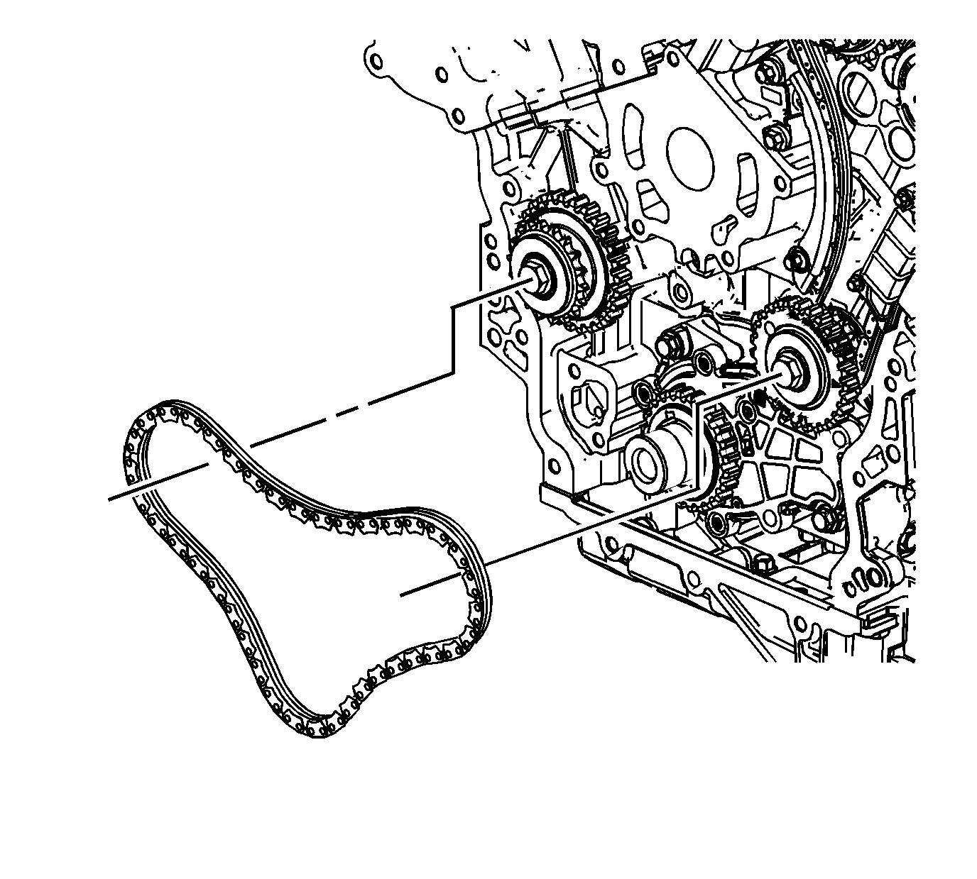

Left Cam Chain
SECONDARY CAMSHAFT INTERMEDIATE DRIVE CHAIN REPLACEMENT - LEFT SIDE
Secondary Camshaft Intermediate Drive Chain Replacement - Left Side
Removal Procedure
2. Remove the right bank secondary camshaft drive chain tensioner. Refer to Secondary Timing Chain Tensioner Removal - Right Side (See: Engine > Overhaul).
3. Remove the right bank secondary camshaft drive chain shoe. Refer to Secondary Camshaft Drive Chain Shoe Removal - Right Side (See: Engine > Overhaul).
4. Remove the right bank secondary camshaft drive chain guide. Refer to Secondary Timing Chain Guide Removal - Right Side (See: Engine > Overhaul).
5. Remove the right bank secondary camshaft drive chain. Refer to Secondary Camshaft Intermediate Drive Chain Removal - Right Side (See: Engine > Overhaul).
6. Remove the primary camshaft drive chain tensioner. Refer to Primary Camshaft Intermediate Drive Chain Tensioner Removal (See: Engine > Overhaul).
7. Remove the primary upper camshaft drive chain guide. Refer to Primary Timing Chain Guide Removal - Upper (See: Engine > Overhaul).
8. Remove the primary camshaft drive chain. Refer to Primary Camshaft Intermediate Drive Chain Removal (See: Engine > Overhaul).
9. Remove the right bank camshaft intermediate drive chain idler. Refer to Timing Chain Idler Sprocket Removal - Right Side (See: Engine > Overhaul).
10. Remove the left bank secondary camshaft drive chain tensioner. Refer to Secondary Timing Chain Tensioner Removal - Left Side (See: Engine > Overhaul).
11. Remove the left bank secondary camshaft drive chain shoe. Refer to Secondary Camshaft Drive Chain Shoe Removal - Left Side (See: Engine > Overhaul).
12. Remove the left bank secondary camshaft drive chain guide. Refer to Secondary Timing Chain Guide Removal - Left Side (See: Engine > Overhaul).
13. Remove the left bank camshaft intermediate drive chain idler. Refer to Timing Chain Idler Sprocket Removal - Left Side (See: Engine > Overhaul).
14. Remove the left bank secondary camshaft drive chain. Refer to Secondary Camshaft Intermediate Drive Chain Removal - Left Side (See: Engine > Overhaul).
15. Clean and inspect all of the camshaft timing drive components. Refer to Camshaft Timing Drive Components Cleaning and Inspection (See: Engine > Overhaul). Replace components as necessary.
Installation Procedure
1. Install the left bank secondary camshaft drive chain. Refer to Secondary Camshaft Intermediate Drive Chain Installation - Left Side (See: Engine > Overhaul).
2. Install the left bank camshaft intermediate drive chain idler. Refer to Timing Chain Idler Sprocket Installation - Left Side (See: Engine > Overhaul).
3. Install the left bank secondary camshaft drive chain guide. Refer to Secondary Timing Chain Guide Installation - Left Side (See: Engine > Overhaul).
4. Install the left bank secondary camshaft drive chain shoe. Refer to Secondary Camshaft Drive Chain Shoe Installation - Left Side (See: Engine > Overhaul).
5. Install the left bank secondary camshaft drive chain tensioner. Refer to Secondary Timing Chain Tensioner Installation - Left Side (See: Engine > Overhaul).
6. Install the right bank camshaft intermediate drive chain idler. Refer to Timing Chain Idler Sprocket Installation - Right Side (See: Engine > Overhaul).
7. Install the primary camshaft drive chain. Refer to Primary Camshaft Intermediate Drive Chain Installation (See: Engine > Overhaul).
8. Install the primary upper camshaft drive chain guide. Refer to Primary Timing Chain Guide Installation - Upper (See: Engine > Overhaul).
9. Install the primary camshaft drive chain tensioner. Refer to Primary Camshaft Intermediate Drive Chain Tensioner Installation (See: Engine > Overhaul).
10. Install the right bank secondary camshaft drive chain. Refer to Secondary Camshaft Intermediate Drive Chain Installation - Right Side (See: Engine > Overhaul).
11. Install the right bank secondary camshaft drive chain guide. Refer to Secondary Timing Chain Guide Installation - Right Side (See: Engine > Overhaul).
12. Install the right bank secondary camshaft drive chain shoe. Refer to Secondary Camshaft Drive Chain Shoe Installation - Right Side (See: Engine > Overhaul).
13. Install the right bank secondary camshaft drive chain tensioner. Refer to Secondary Timing Chain Tensioner Installation - Right Side (See: Engine > Overhaul).

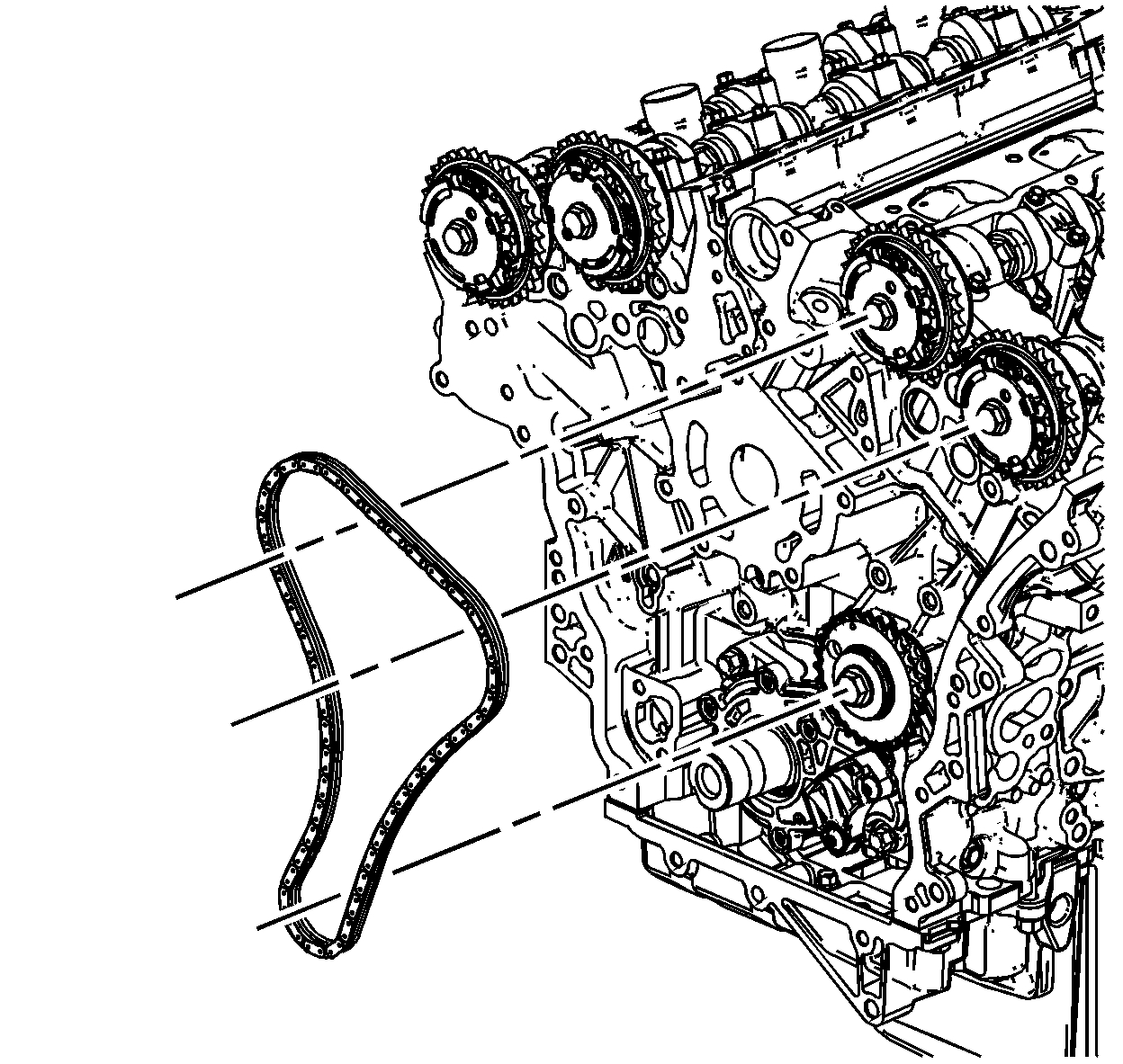

RIght Cam Chain
Secondary Camshaft Intermediate Drive Chain Replacement - Right Side
Removal Procedure
1. Ensure the stage 1 camshaft timing is correct. Refer to Setting Camshaft Timing (See: Timing Components > Procedures > Setting Camshaft Timing).
2. Install the right bank secondary camshaft drive chain. Refer to Secondary Camshaft Intermediate Drive Chain Installation - Right Side (See: Engine > Overhaul).
3. Install the right bank secondary camshaft drive chain guide. Refer to Secondary Timing Chain Guide Installation - Right Side (See: Engine > Overhaul).
4. Install the right bank secondary camshaft drive chain shoe. Refer to Secondary Camshaft Drive Chain Shoe Installation - Right Side (See: Engine > Overhaul).
5. Install the right bank secondary camshaft drive chain tensioner. Refer to Secondary Timing Chain Tensioner Installation - Right Side (See: Engine > Overhaul).
6. Install the spark plugs. Refer to Spark Plug Replacement (See: Spark Plug > Removal and Replacement).
7. Install the engine front cover. Refer to Engine Front Cover Replacement (See: Timing Cover > Removal and Replacement > Engine Front Cover Replacement).
