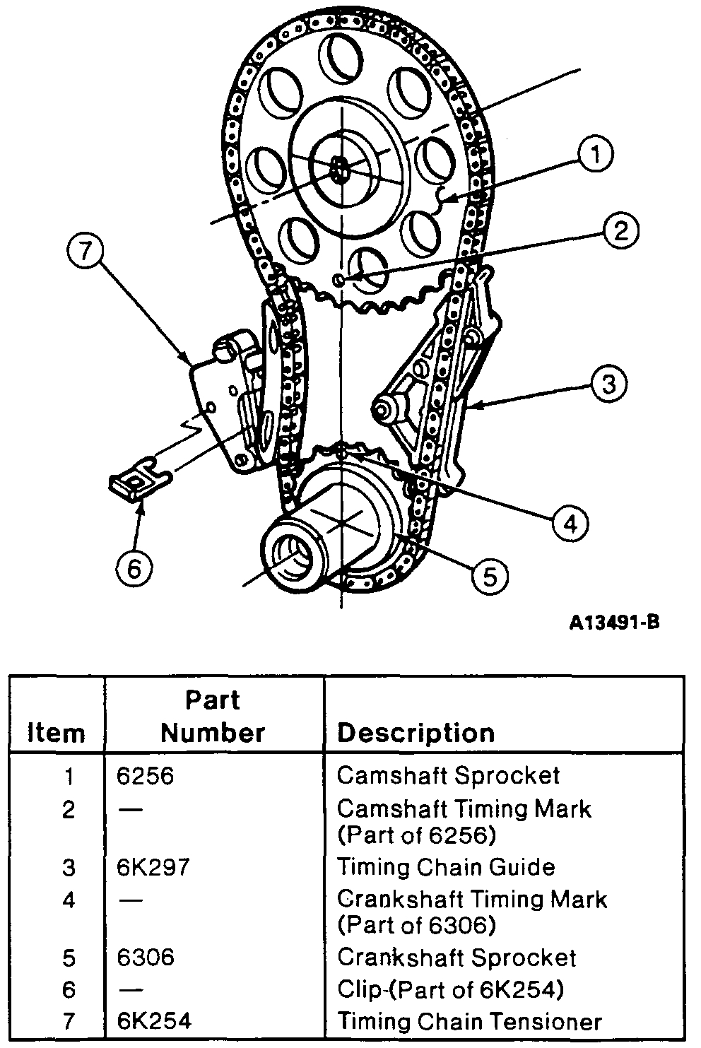

Hi, I did a upper engine replace heads new, timing chain, oil pump. All back together no compression. Did leak down all cylinder all at 25 to 30%.
TDC I have the timing mark on crank on top and cam mark at bottom. Should the cam mark be at top also, on TDC
As of now when I rotate the engine so the timing mark on crank is at top and the cam mark is at top the exhaust valve on number one starts to open.
I think I may have the timing 180 degrees out.
Please help. Thanks, Tony

Hi and thanks for using 2CarPros.com
It sounds like you did it right. The cam mark is at 6 and crank at 12. If you have no compression, maybe the chain jumped. That is where I would start. The engine was running and now no compression. If you were 180 out ( and I don't think that is possible on this engine) it never would have run.

I do not know if you need them, but here are the directions for chain replacement. It shows where the marks go. Also, make sure the tension-er is good.
_______________________
REMOVAL
NOTE: It is necessary to replace the oil pan gasket when removing and installing engine front cover. It is necessary to remove the engine to remove the oil pan.
1. Remove engine front cover.
2. Push timing chain tension-er into the retracted position and install retaining clip.
3. Remove the camshaft sprocket retaining bolt and the crankshaft sprocket key.
Timing Chain And Gears
4. Remove the crankshaft sprocket and camshaft sprockets with the timing chain.
5. Remove the timing chain and timing chain guide as required.

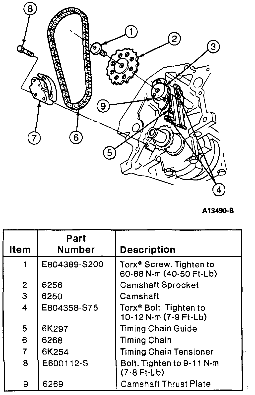

INSTALLATION
1. Install the timing chain guide to the cylinder block with the pin of the guide inserted into the oil hole in the block. Install the two retaining bolts, and tighten to 10-12 Nm (7-9 ft lb).
2. Position the camshaft so the timing mark will align with the crankshaft. Position the crankshaft so the timing mark will align with the camshaft.
3. Install the crankshaft sprocket, camshaft and timing chain together.
NOTE: Make sure that the tension-er side of the timing chain is held inward, and that the guide side of the chain is straight and tight.
Timing Chain Alignment Marks
4. Install the crankshaft key and check the timing marks on the crankshaft sprocket and camshaft sprocket for correct alignment.
5. Install the camshaft sprocket retaining bolt, and tighten to 60-68 Nm (44-50 ft lb).
6. Remove the clip from the timing chain tension-er.
7. Check the camshaft end play.

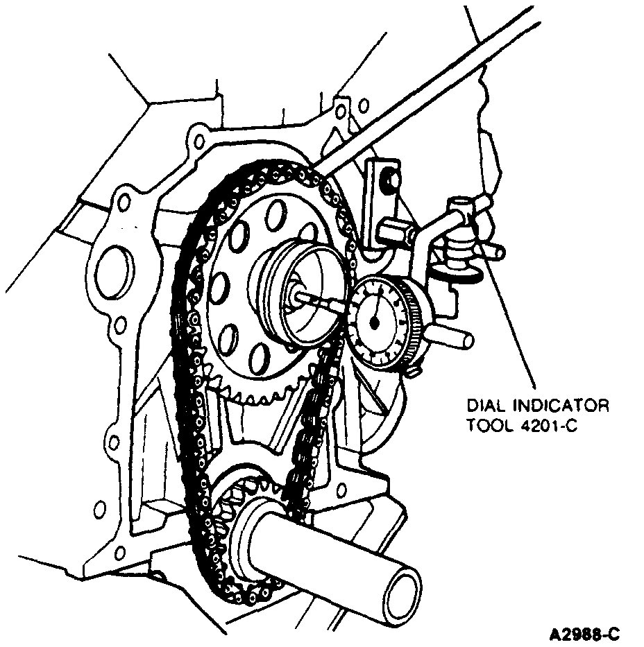

a. Push camshaft toward rear of engine. Install Dial Indicator TOOL-4201-C or equivalent so indicator point is on camshaft sprocket attaching screw.
b. Zero dial indicator. Pull camshaft forward and release it. Compare dial indicator reading with specifications. Camshaft end play specification is 0.0203-0.1016 mm (0.0008-0.004 in) and camshaft end play service limit is 0.2286 mm (0.009 in). If end play is excessive, replace camshaft thrust plate.
c. Remove dial indicator.
d. After replacing thrust plate, check end play again. If it is still out of specified range, inspect camshaft and cylinder head/cylinder block for excessive wear.

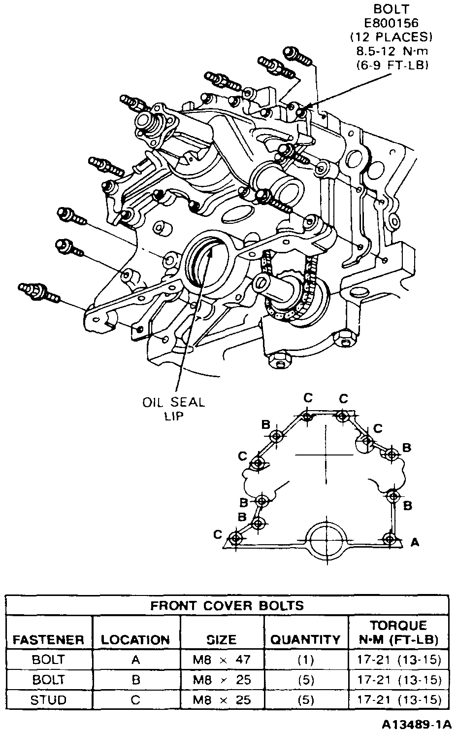

Engine Front Cover
8. Install the engine front cover tighten bolts to 17-21 Nm (13-15 ft lb).

Thanks, all in the timing chain is new and I have checked and timing has not jumped. I have done timing jobs a lot, I will say most were GM, but as my family has grown over the years I have worked in depth of a lot others. This one has me baffled! Tomorrow I am going to shim the rocker arm rail up. I really think the issue is in the machine boss that the rail sits on. That it is machine to low making the valves opening and closing to soon. It is the only other thing I can think of, unless you can think of something else?

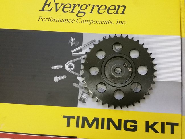

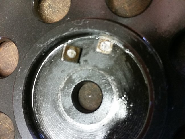

TONY KEITH
Update: after a lot of pulling apart I found the cam gear alignment pin was spot weld and came loose this was a new gear.
Sep 27, 2018 at 7:26 AM
  • 110,244 POSTS
Wow! That is the problem. I hope it did not damage anything else. One has to wonder where parts are made anymore. Chances are Ford (Mazda) did not make that one here.

TONY KEITH
Joe thanks for all the help you guys are great. This is the first time I have ever seen this. I am 65 been doing this all my life. here is a new picture:
