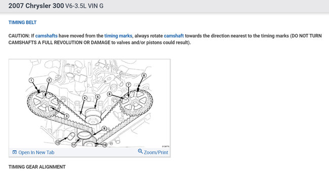

I replaced my water pump yesterday and the timing belt. well, somehow my timing belt is off.

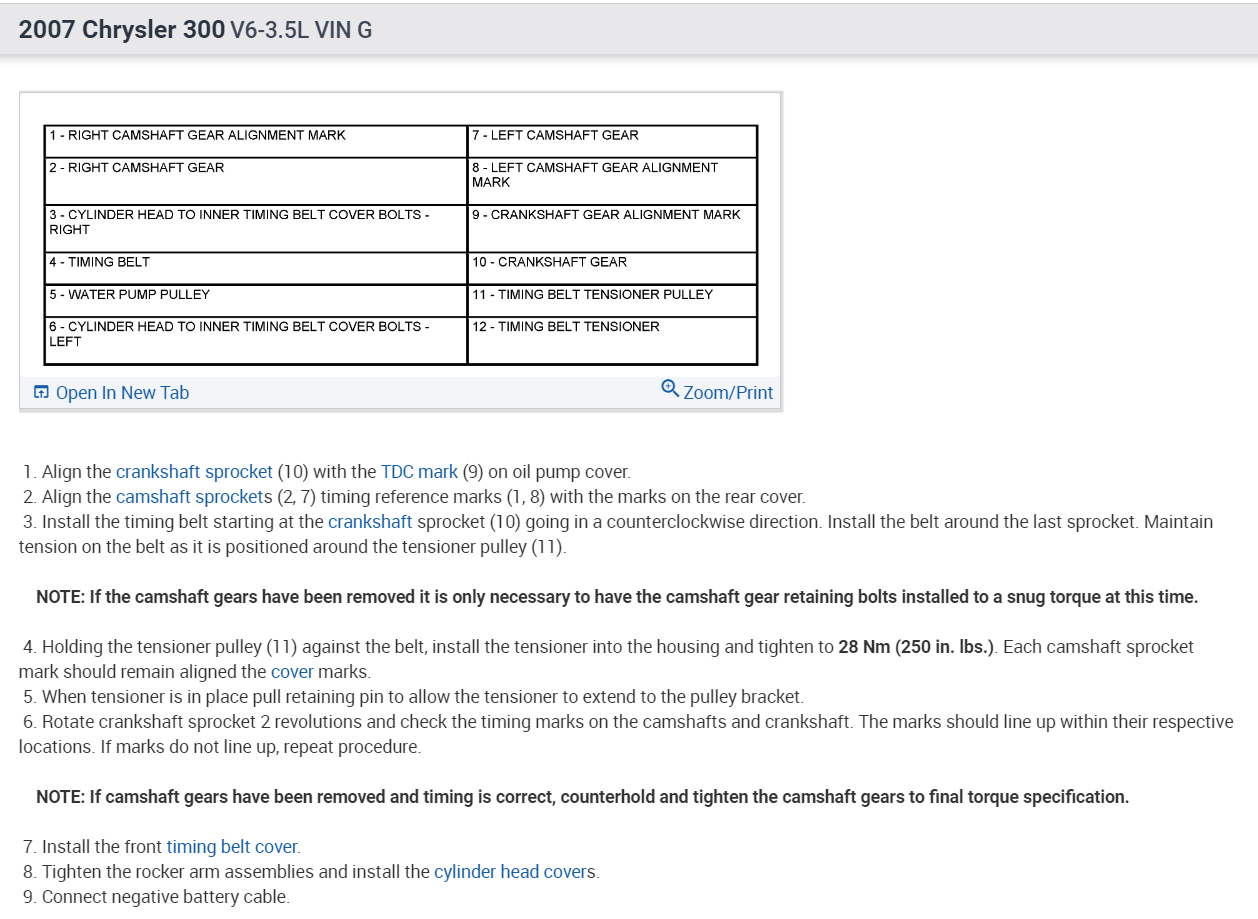

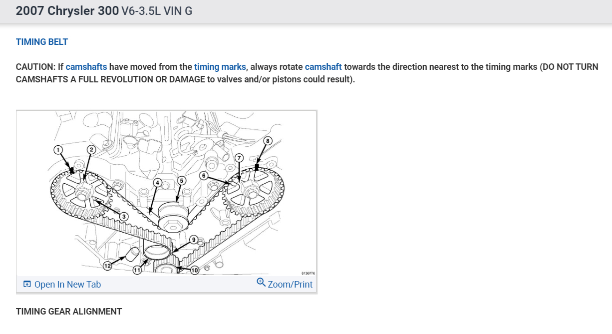

Here are the timing marks for the timing belt for your engine in the diagrams below. Check out the diagrams (below). Please let us know if you need anything else to get the problem fixed.
