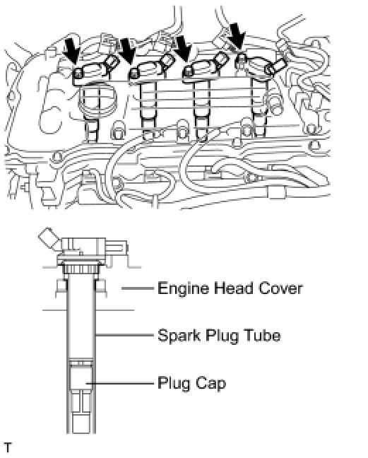

I want to set the time in my car to the right time. How do i go about it? Also, when can i change my spark plugs?
Oct 23, 2017 at 12:19 AM
  • 55,766 POSTS
The timing is set by the computer so there is nothing to set. Here is a guide on how too change your spark plugs.
https://www.2carpros.com/articles/how-to-change-spark-plugs
Video on how to gap
https://youtu.be/c9_NVXiwvYg

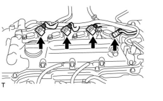

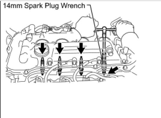

Here are some diagrams on how it will be on your car.
Torque : 10 Nm (102 kgf-cm, 7 ft-lbf)
(below)

How do I change the spark plugs on a 2010 Toyota Corolla with a 1.8 liter engine? I have tried several different spark plug wrenches but none of them seat on the spark plug.
Oct 25, 2017 at 1:15 PM (Merged)
JDL
  • 16,098 POSTS
Did you talk to the people at the autostore? Tell them you want to see a spark plug for your year--make--model and engine size, Then tell them you want a socket to fit it. It usually doesn't have to be a spark plug socket, the spark plug socket probably has more protection for the spark plug. I'll look around, see if I can find a size?
JDL
  • 16,098 POSTS
If I was looking at the right spark plug, 9/16 inch or 14.3mm, hex size.
Sometimes you have to clean out the plug-well before the socket will fit. Wear safety glasses, if you use compressed air.
