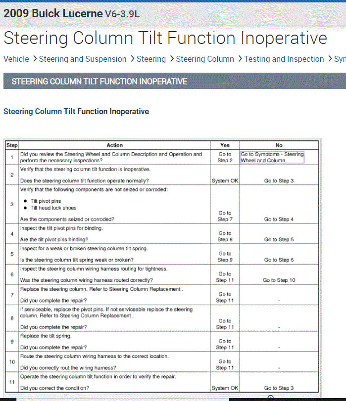

The tilt column lever does nothing when moved to adjust the tilt. what happened?
May 11, 2021 at 12:54 AM
  • 110,241 POSTS
Does it move at all? I ask because it could be a few things. Also, did it happen all at once?
There are a few things in the steering column that could have failed. There are screws called pivot pins that may be corroded or stuck. There is a spring that may be weak or broken, and a few other things.

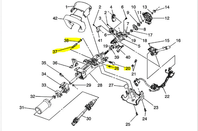

If you look at pic 1 below, it is the diagnostics for identifying an inoperative tilt wheel. In pic 2, I highlighted the components aforementioned.
Here is what each highlighted component is:
#20 Tilt lever
#26 Pivot pin
#37 Column tilt spring
#38 Column tilt guide
__________________________
I am basing this on manual tilt. If your vehicle is controlled by electric actuators, let me know.
