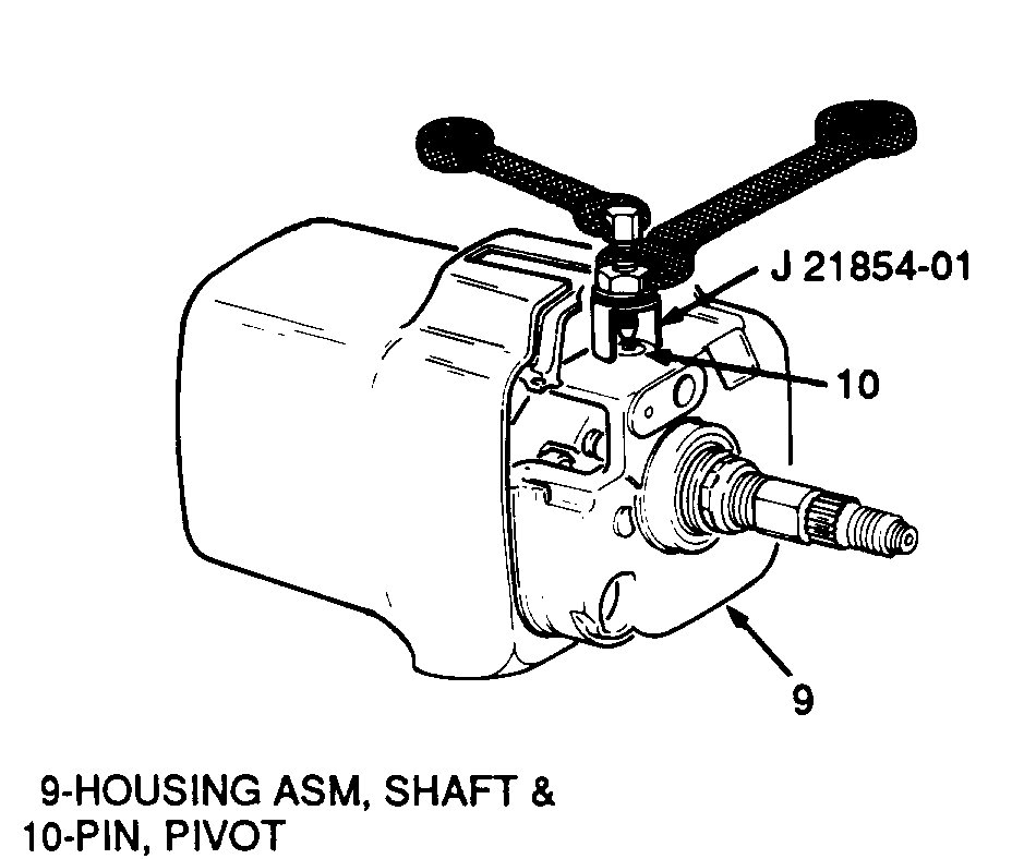

what's the easiest way to install the two pivot pins without damaging them by hammering them in?

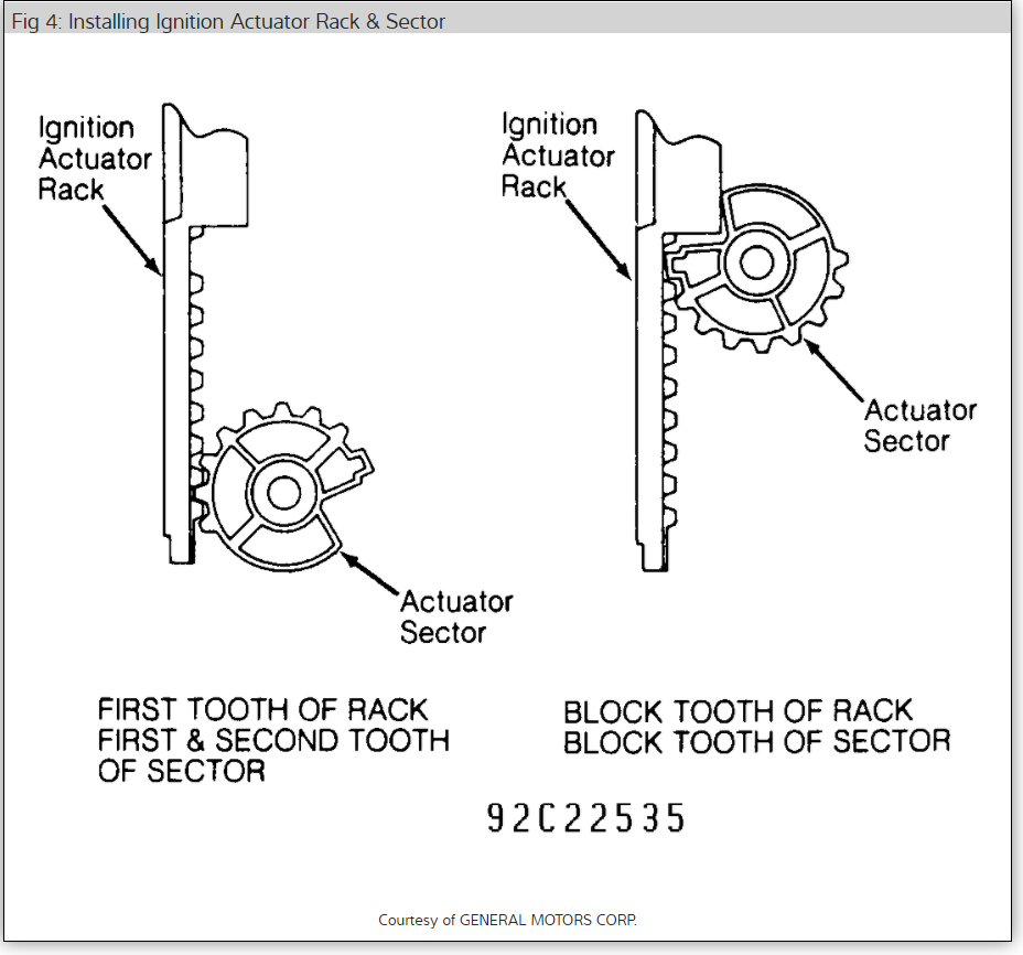

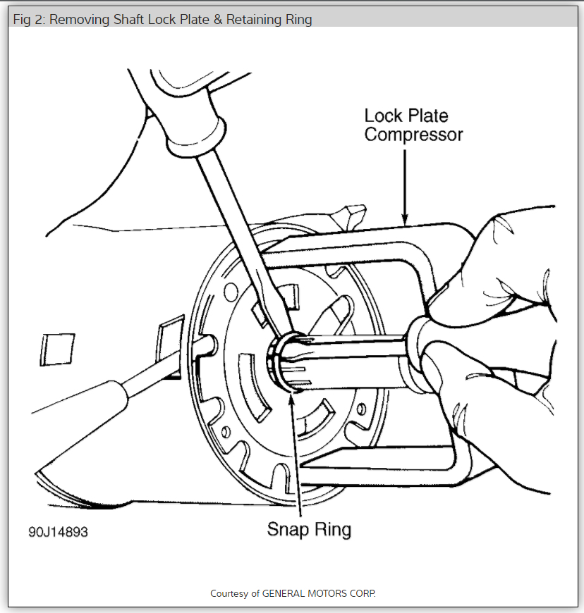

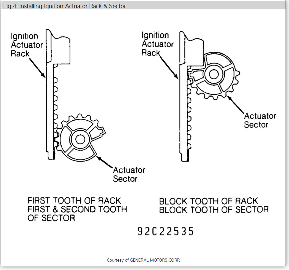

Thank you motor master. this is my first attempt working on this and reason being is to replace the key lock cylinder which I've put in. but as I was removing the column from the car and set down and separated the shaft from the housing and removed the faulty key lock cylinder a small metal length pin with serrated teeth fell out. no problem so I placed it back in. here is another question, by inserting the key to bench test the forward and reverse action of the moving ignition key lock cylinder and slider that fits into the ignition switch it moves forward okay, but will not reverse when I turn the key backwards to the key off lock position. is this right?
Jun 25, 2019 at 10:25 PM
  • 55,433 POSTS
It sounds like you have the gear off one tooth, and as far as getting the pivot pins use a screw driver on one side to hold it then push the main shaft over to line up the opposing holes. Here are some instructions and diagrams to help. Check out the diagrams (below). Please let us know if you need anything else to get the problem fixed.

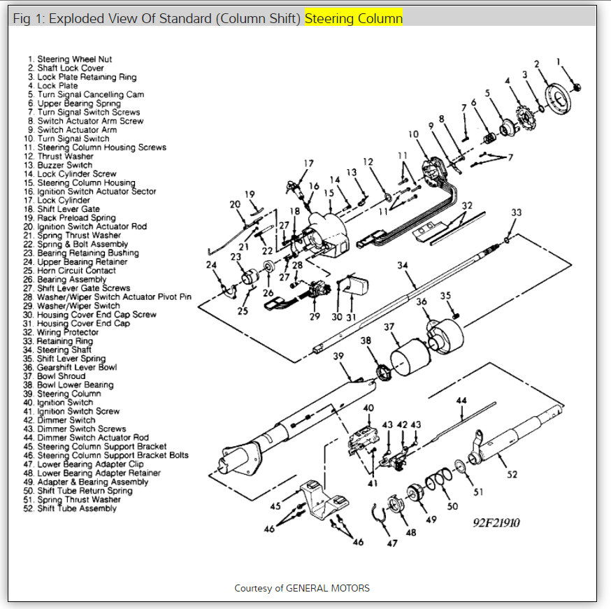

this question is a continuation from the previous one..the column is still on the bench and i would like to know since this is my first time doing this job and just want to be sure before I install the pivot pins..Im checking my work by inserting one of the new keys that came with the new key lock cylinder to test the forward and reverse action of the key lock cylinder in relation to the slider arm movement it moves forward okay but will not reverse in relation to the key lock cylinder being rotated back to the off lock position..there doesn't seem to be any parts or spring that I left out aside from putting the steering shaft back into the housing and installing the pivot pins and the lower bearing and spring with the washers on the end that fits into the intermediate shaft.
Jul 23, 2019 at 10:11 AM (Merged)
  • 110,244 POSTS
Welcome to 2CarPros.

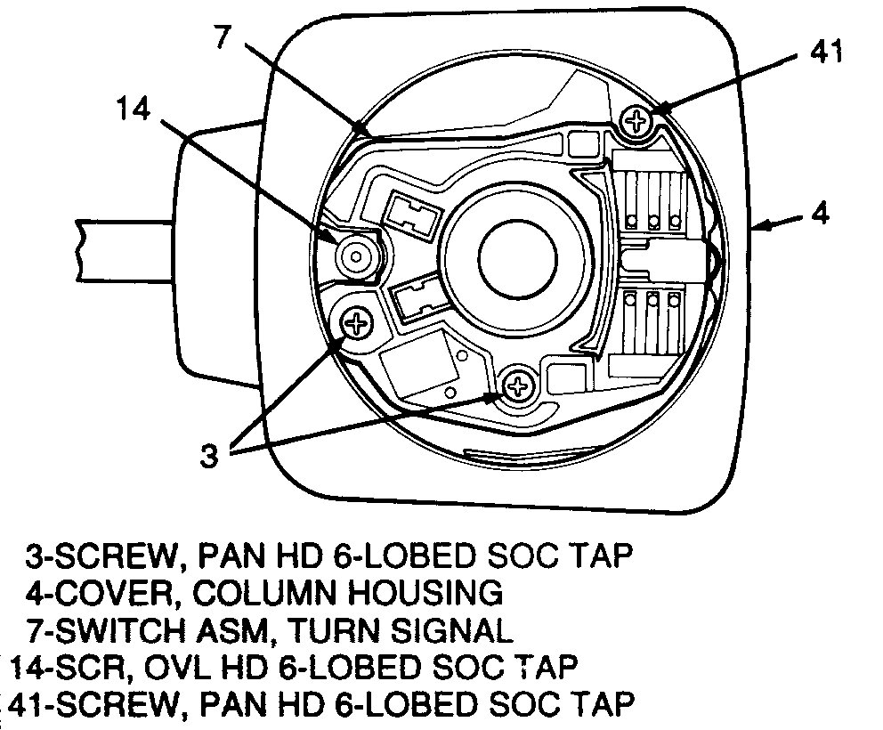

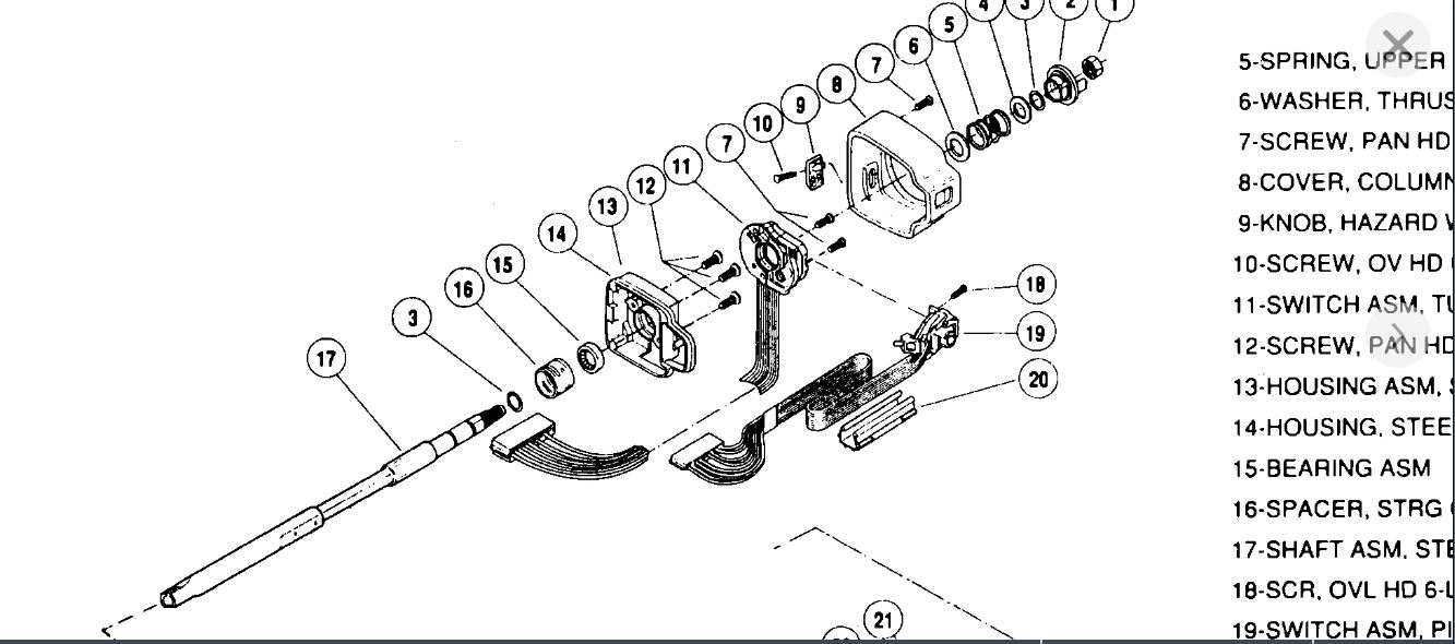

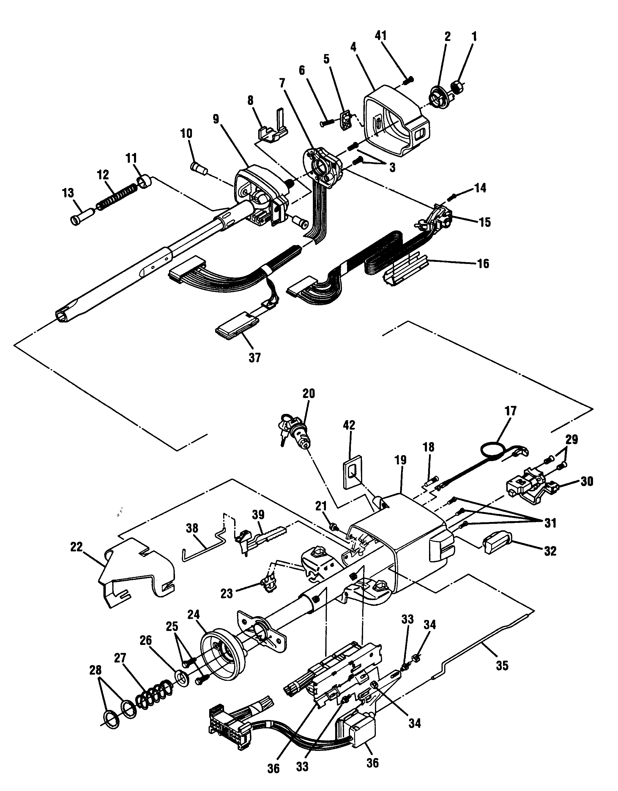

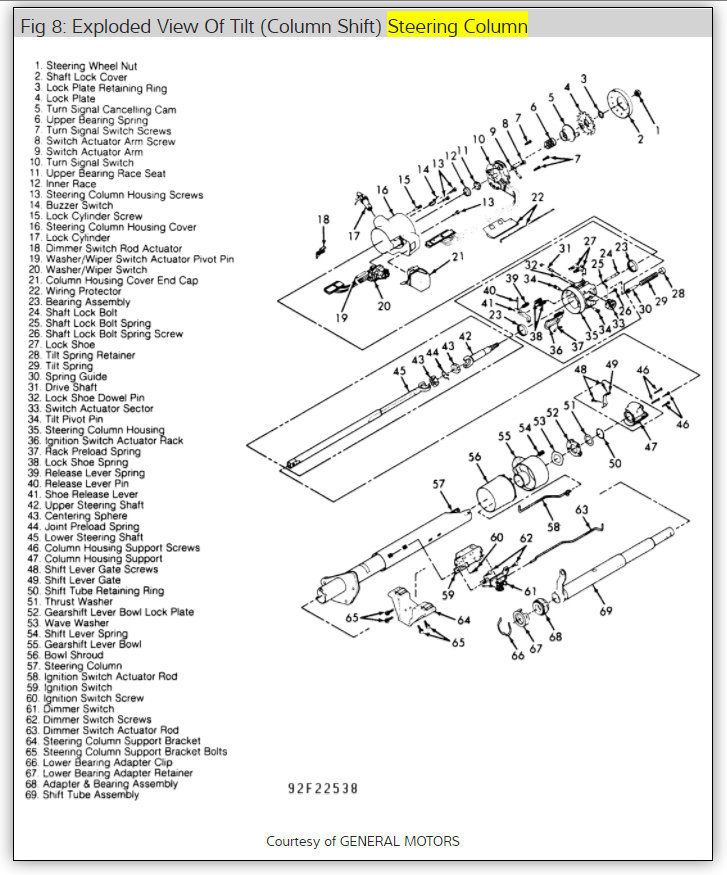

What I am going to provide are the directions specific to replacement with a tilt wheel. All attached pictures correlate with the directions. Also, pic 1 is an exploded view of the column. Read through the directions, compare the pics, and see if anything stands out as different to what you have done.
_____________________________
IGNITION LOCK CYLINDER
Tilt Wheel Steering Column
pic 1
Legend
pic 2
Housing Cover And Turn Signal Switch Removal
pic 3

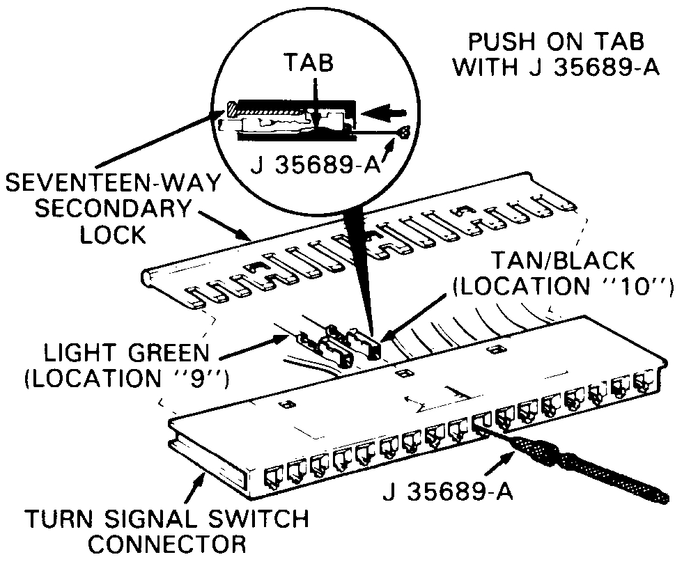

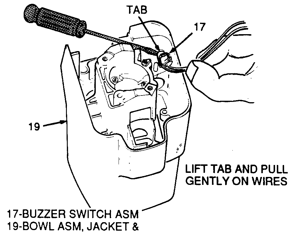

Buzzer Switch Wires, Removal
pic 4
Pivot Pin Removal

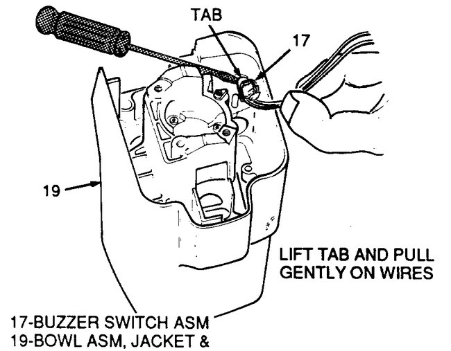

Buzzer Switch Removal

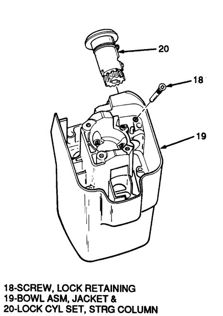

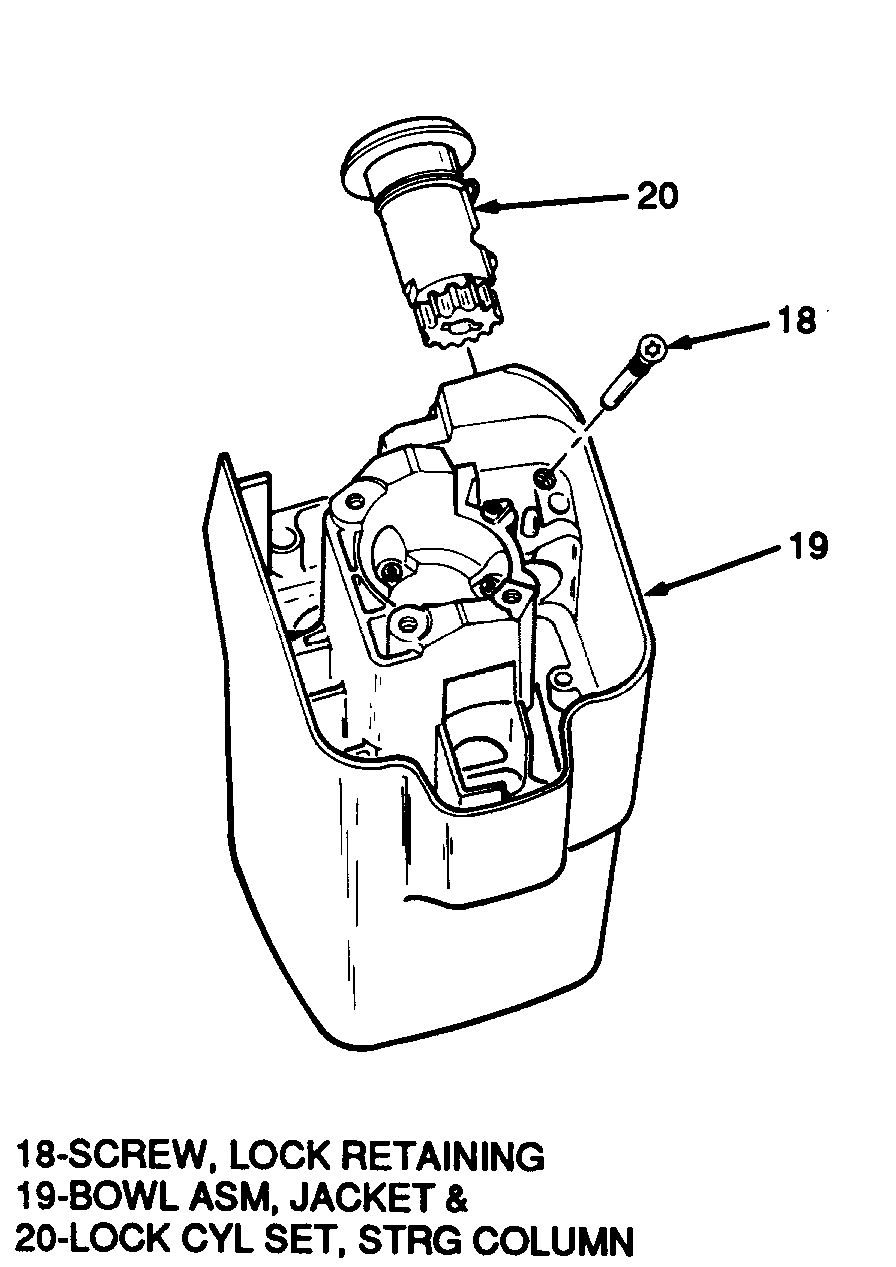

Lock Cylinder Set Removal
pic 7
Remove or Disconnect
Tools Required: J 35689-A Terminal Remover J 21854-01 Pivot Pin Remover.
Important: Steering column must be removed from car before proceeding with the following steps.

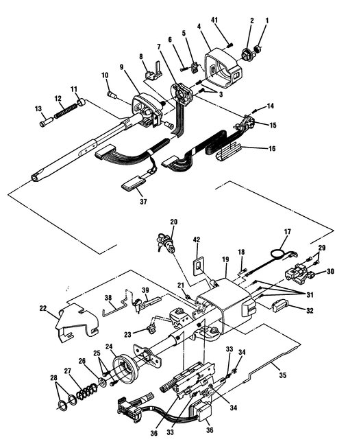

1. Do steps 1 through 18 under Turn Signal Switch Assembly / Service and Repair / Remove or Disconnect. See: Turn Signal Switch > Procedures
2. Pull tilt lever (30) and tilt column all the way up.
3. Insert phillips head screwdriver into square opening in spring retainer (11), push down and turn left to release retainer (11) and wheel tilt spring (12).
4. Spring retainer (11), tilt spring (12) and tilt spring guide (13).
5. Two lower spring retainers (28) and discard.
6. Lower bearing spring (27) and lower bearing seat (26).
7. Adapter screws (25).
8. Adapter and lower bearing assembly (24).
9. Two pivot pins (10) with J 21854-01 as shown.
10. Place lock cylinder (20) in "Run" position.
11. Pull tilt lever (30) to release shaft and housing assembly (9).
12. Shaft and housing assembly (9) from jacket and bowl assembly (19).
13. Place lock cylinder (20) in "Off-Lock" position and remove key.
14. Buzzer switch (17). Use screwdriver to lift switch tab and pull gently on wires to remove.
15. Lock retaining screw (18).
16. Lock cylinder (20).
17. Column tilt bumpers (31) with vise grips. If bumper is broken off use a 5.9 mm (7/32 in.) drill to remove remaining piece of bumper.
18. Tilt bracket screws (29).
19. Tilt lever and bracket assembly (30).
20. Rod cap (32) from dimmer switch rod (35).
21. Jacket and bowl assembly (19).

7. Buzzer switch assembly (17). Push switch down into retaining bore until bottomed with plastic tab covering lock retaining screw (18).

10. Lubricate pivot pins (10) with lithium grease.
^ Two pivot pins (10) into pivot holes in shaft and housing assembly (9) until bottomed.

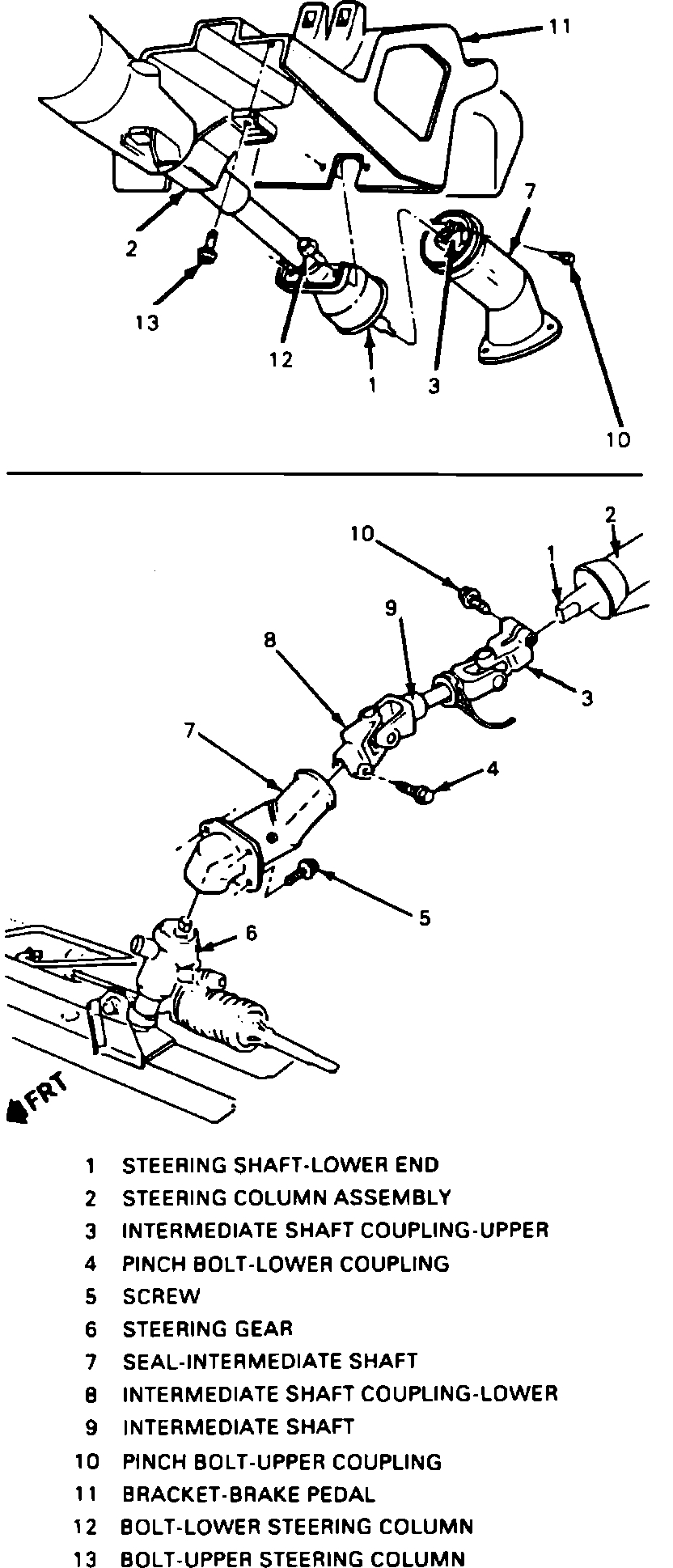

STEERING COLUMN - REMOVAL AND INSTALLATION
Removal
Steering wheel removal for vehicles with redundant steering wheel controls has been revised by service bulletin No. 90-110-9.
1. On 1990-91 models, remove air cleaner.
2. On all models, disconnect battery ground cable, then remove steering wheel as necessary. When removing steering wheel that is equipped with redundant steering wheel controls, insert wheel puller bolts only four to six threads deep to prevent bolts from going all the way through the hub.
3. Remove left hand sound insulator and the trim panel below steering column.
4. Unlock steering column, then push top of intermediate shaft seal down for access to upper intermediate shaft coupling and upper coupling pinch bolt.
5. Rotate intermediate shaft as necessary to remove upper coupling pinch bolt.
6. Disconnect shift indicator cable end and casing from steering column and transaxle shift lever, or park lock cable if equipped with floor shift.
7. Disconnect transaxle shift cable from ball stud on transaxle shift lever, then remove transaxle shift cable casing from steering column bracket by depressing two tabs.
Fig. 27 Steering Column Removal And Installation.
Pic 1
8. Remove lower steering column attaching bolts, Fig. 27, then the upper steering column attaching bolts, and lower steering column to seat.
9. Disconnect electrical connector by loosening the screw and separating the two halves.
10. Withdraw lower end of steering shaft from upper intermediate shaft coupling and remove column. It may be necessary to spread coupling clamp with a screwdriver to withdraw steering shaft.
