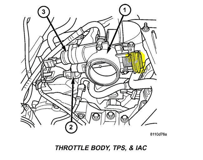

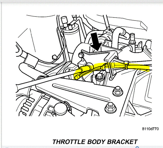

I tried to change spark plug number 6 and I think I bothered the throttle cables because the acceleration is top speed when I turn it over.
Jul 29, 2020 at 12:38 PM
  • 110,240 POSTS
I attached two pics below. In the first one, I highlighted the cable. In the second one, I highlighted where the cable goes.
Check to make sure nothing is disconnected. With the engine off, have a helper press the gas pedal in the vehicle while you watch if the cable is moving the throttle plate.
Let me know what you find. Also, if you have questions, let me know that as well.
