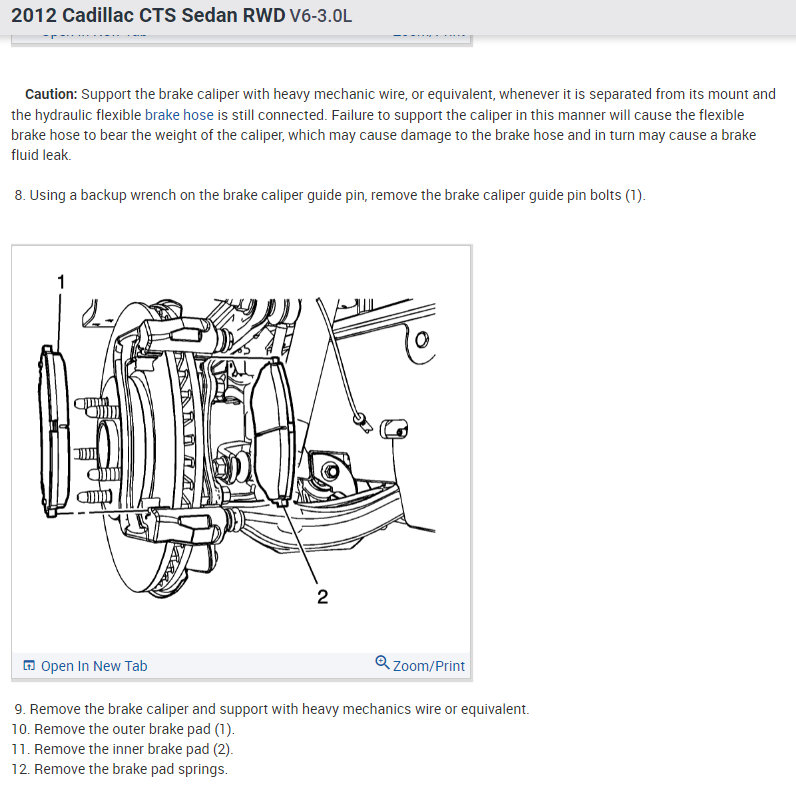

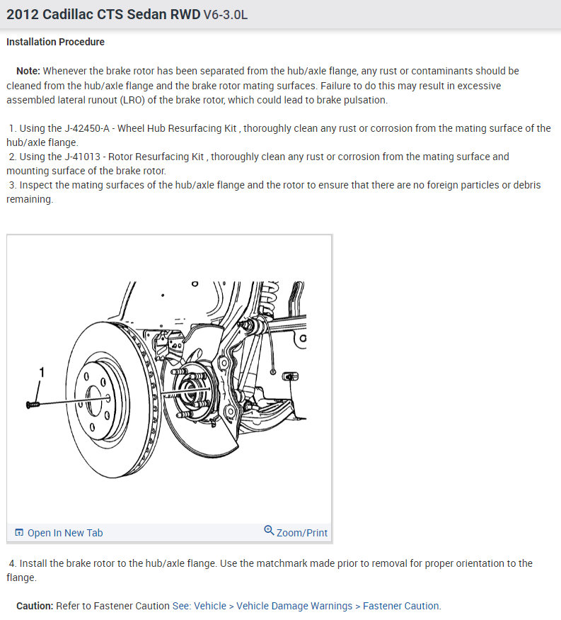

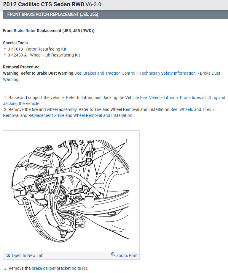

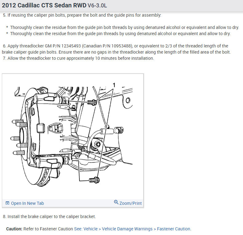

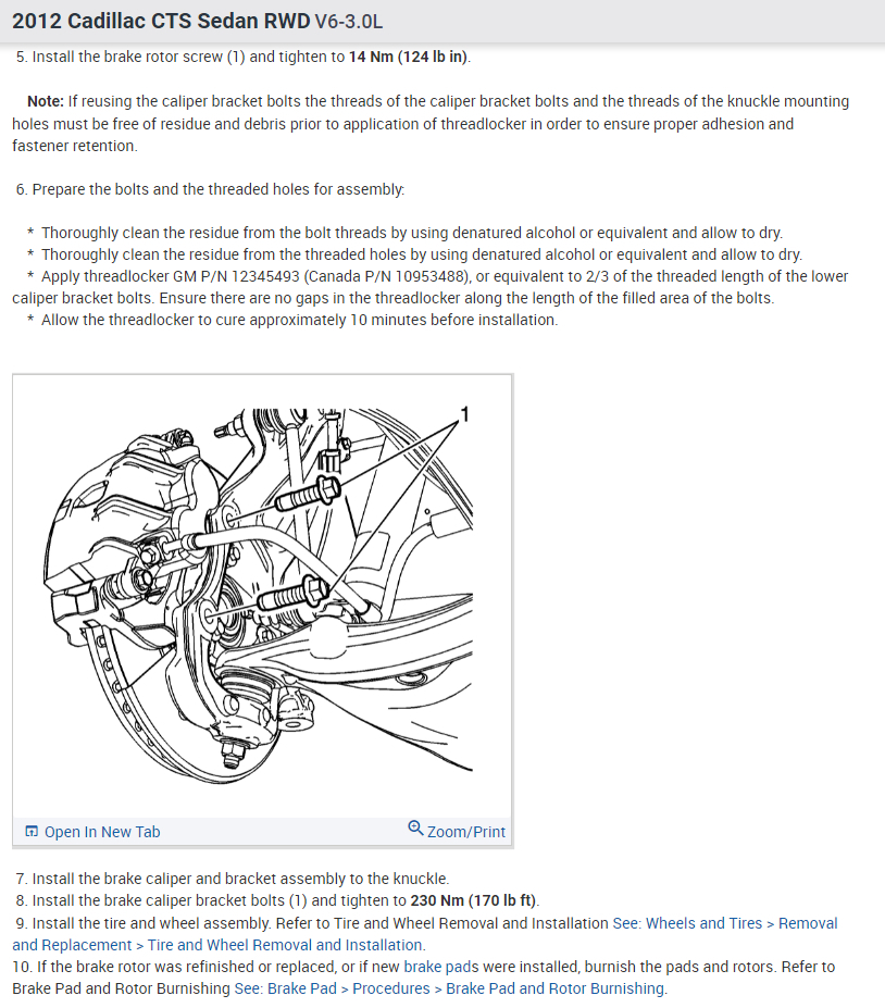

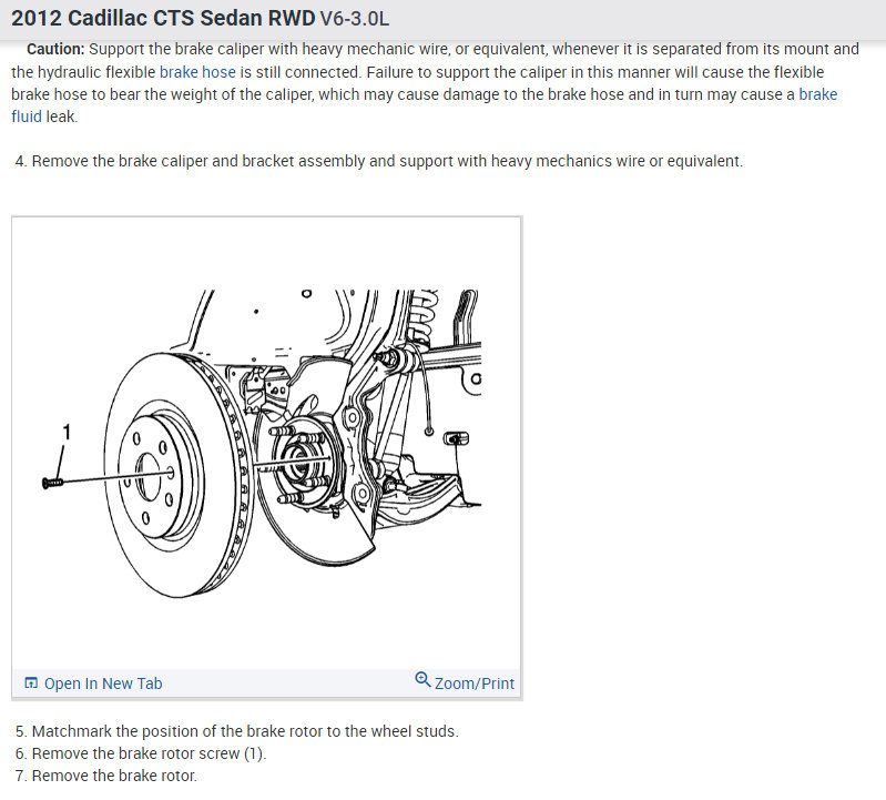

Just to clarify when you press the brake, you feel pulsation (vibration) on the brake pedal?
If this is what you are experiencing, it could be due to wrapped brake rotors. The rotor can become wrapped due to being below minimum thickness specification, it can also be simply for normal use.
This will require servicing the brakes. If the rotor is above minimum thickness, it is possible to get it resurfaced to get rid of the issue.
Here is a helpful article:

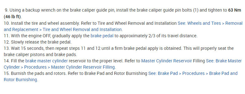

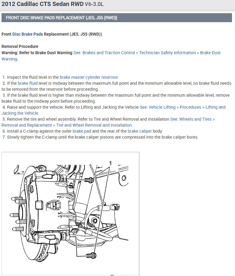

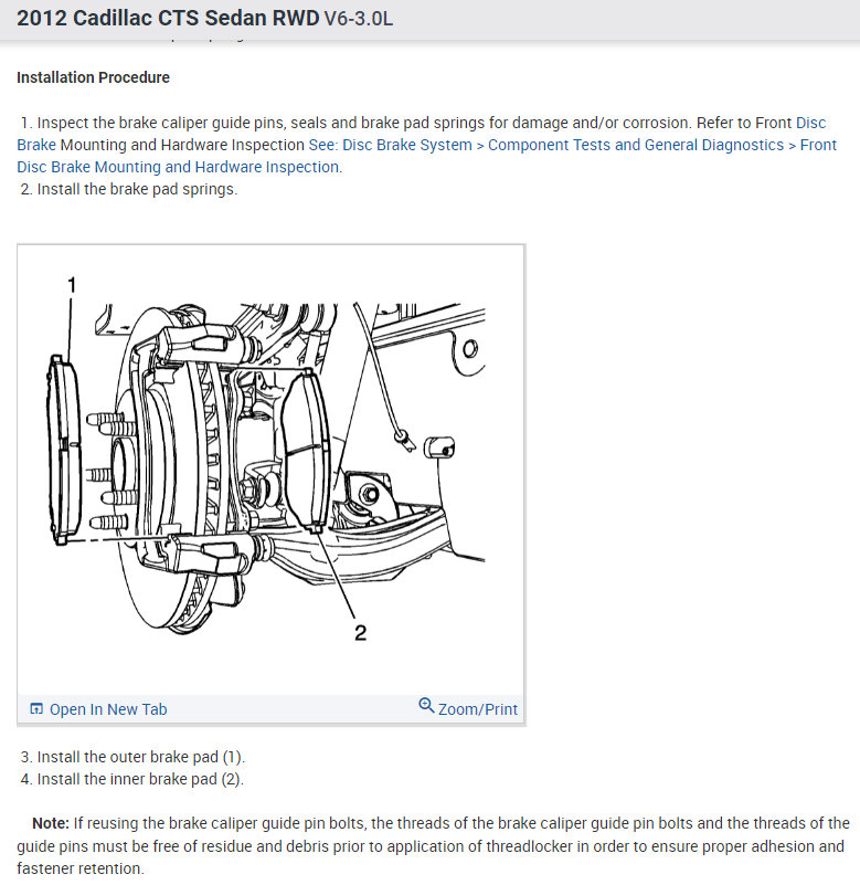

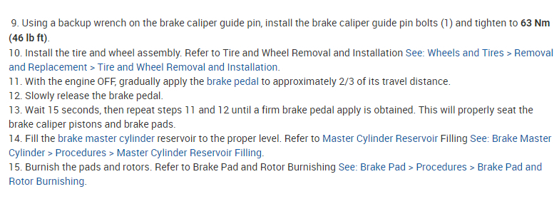

I have attached the brake pads and rotors replacement procedure for this vehicle.
