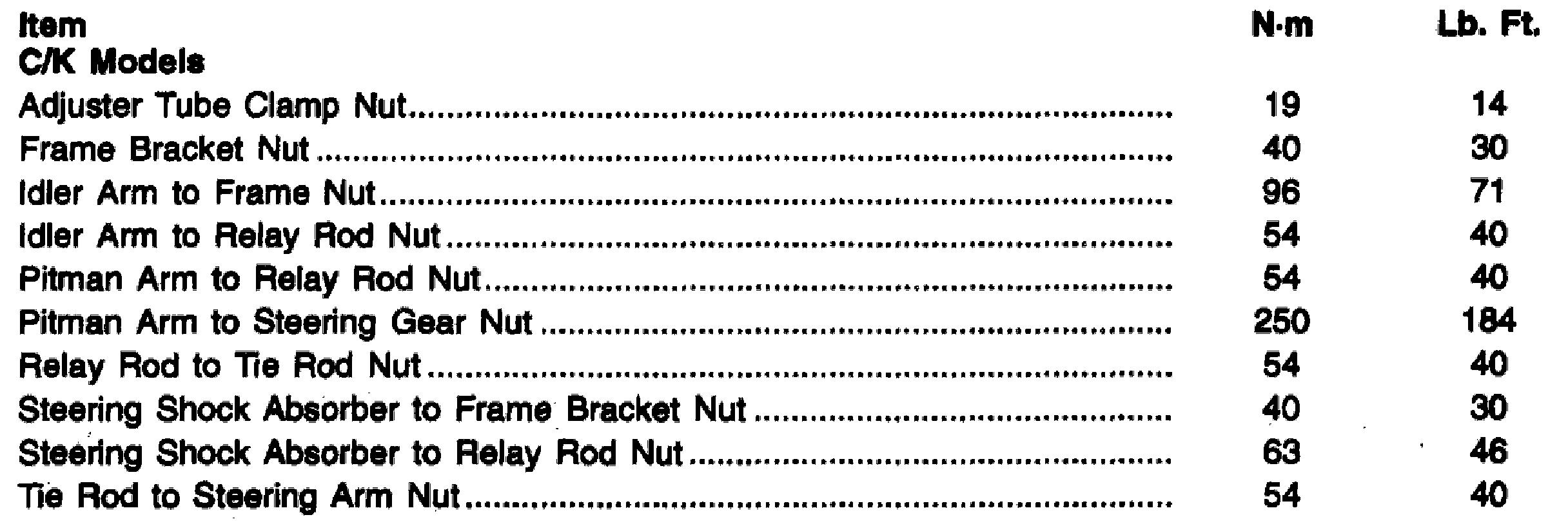

I can help with some of your questions. When you have a castle nut, tighten it to the spec listed on the sheet that comes with it. If none is provided, use the manufacturer's spec. I can look that up for you next time. Once you get it there, always tighten it more, just enough for the hole to line up for the cotter pin. If you already over-tightened the nut, you likely would have felt the threads start to peel, then the nut would quickly turn easier. Invest in a click-type torque wrench for jobs like these. Once tightened, do not back the nut off.

So when I over tighten the tie rod end the tie rod becomes deformed? Or the center link that it is tighten into?

The deformed holes I mentioned occur when a tapered stud works loose after not being tightened fully. That can occur days or years after the part was replaced. Many people do not pay attention to the clunking noise and reduced handling. They keep on driving for days or weeks. That is when the tapered stud and the tapered hole rub against each other and wear, and that is when both parts must be replaced. Simply installing a new tie rod end or ball joint into the old hole will not solve the problem. The nice straight stud will not fully seat on the rounded hole.
Over-tightening the castle nut does not deform the tapered stud or hole. It stretches the threads and if bad enough, will start to peel the threads. At that point you would feel the nut start to turn with much less resistance. If you were still grunting on the wrench, I would leave it alone. Definitely do not back the nut off because it will become too loose to hold the stud in place.

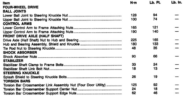

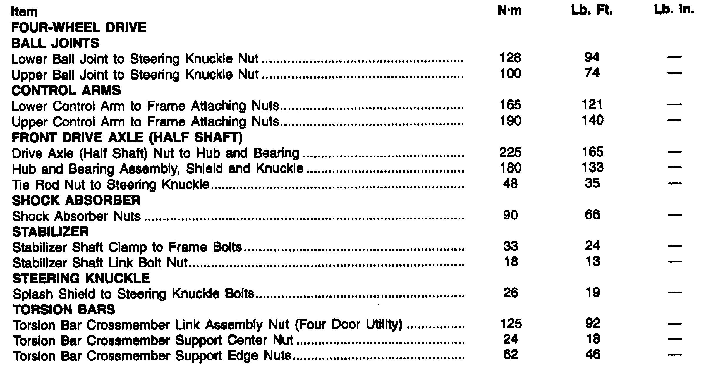

Perfect. I got the knuckle on now and it’s in the lower ball joint, tie rod, and cv axle right now. Just finger tight.
Like I said before I matched the tie rods. In length and the steering wheel is straight but the hub is way off. Should i just spin the adjuster sleeve to make it a bit straighter? Or is it because it’s not hooked to the upper control arm, and the axle and joints arent fully tightened up?
Dec 8, 2018 at 10:26 AM
CARADIODOC
  • 34,380 POSTS
Ooh. Watch out for the large axle nut. That has to be tightened to specs before you set the truck down and put its weight on the wheel bearing. Failure to have that nut tight will make the bearing noisy. It will buzz like an airplane engine. The spec. for that nut is 165 foot-pounds which is lower than for most little front-wheel-drive cars. A lot of people mistakenly install the wheel and tire, then set it down so the tire will hold the axle from spinning while they tighten that nut. By that time it's too late. Instead, just stick a punch or screwdriver into a cooling slot of the rotor, then tighten the nut.
When everything else is tight and finished, the last step before buzzing off to the alignment shop is to set "toe" for each front wheel as close as you can get it to reduce tire wear. Lock the steering wheel straight ahead, then twist each tie rod sleeve to bring each wheel straight ahead. Don't obsess over getting these perfect. You won't even be close, as a quarter turn is plenty to go from out-of-specs to in-specs. Your eyeballs aren't calibrated well enough to see that tiny change. When you get close, look through the slot in the sleeve to see how much threads of each tie rod end are engaged. You don't want to end up with one of them only having a few threads engaged. From memory of replacing these on GM cars in the '70s and '80s, those typically ended up with around 26 or 27 threads engaged, but just use that for reference. If you find that one is going to be wound in to the end of its threads, or is going to have just a few threads engaged, rather than popping the tapered studs apart again, just unthread the sleeve from both tie rod ends, then thread them back together while starting both at approximately the same time. You can wind the sleeve onto one tie rod end two or three turns, then work on starting the other tie rod end. Keep running them together to make the linkage shorter and shorter until that wheel is close to straight ahead to match the steering wheel. Tighten the two strap clamp bolts just enough so you can't spin the sleeve any more, then just a little more so they don't tear apart on the drive to the shop. These sleeves are the last thing to be adjusted by the alignment specialist.
If you put any lubricant on the threads for the sleeve, use only axle grease or a spray lithium-based grease. A long time ago I started lubing tie rod threads with Chrysler's Rust Penetrant, thinking these cars were coming in once a year for maintenance alignments, and that would insure the sleeves were easy to adjust. What I learned was penetrating oils open the way for moisture to follow it in, then those parts became rusted together so tightly that I needed a torch to get them loose. Don't use any type of anti-seize compound either on any steering or suspension parts. That stuff will prevent the clamping action from holding parts tightly together, and they will slip.
