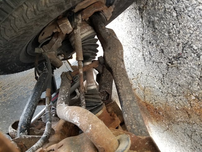

I installed a 3" lift on my truck and I am just wondering if it is possible for me to switch my tie rods from bottom to top due to them being at a pretty harsh angle.

If you can use your cell phone and upload a picture here of the crazy tie rod angle that would be helpful. Also, did you install the lift kit or did you take it to a shop? Thanks again for using 2CarPros.

I do plan on turning my torsion keys down another turn.

From what it looks like you installed a torsion key lift.... Those do provide crazy tie rod/CV axle angles. You might want to crank down a little more..Is there binding/scraping? Unfortunately no you cannot flip the tie rod over. I installed a Rancho 6' lift on my 1997 and then put Bilstein 5100 shocks and it rode like a Cadillac.Hope this helps and thanks again for using 2CarPros.

No binding or scrapping, does ride pretty rough but I knew that was going to happen. But definitely taking the keys down a turn or two. But thank you for all your help!

Yeah, unfortunately torsion lift isn't the way to go... Turning down the torsion's might help and I'm sure the ride quality does suffer.Thanks again for using 2CarPros and hope you will use us again in the future.
