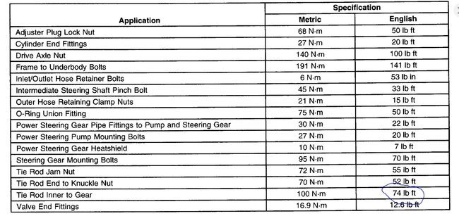

I am looking for front inner and outer tie rod torque specs. Thank you.

Good morning,
I attached the torque specs for you to view the steering system.
I circled the torque for the inner tie rod end.
