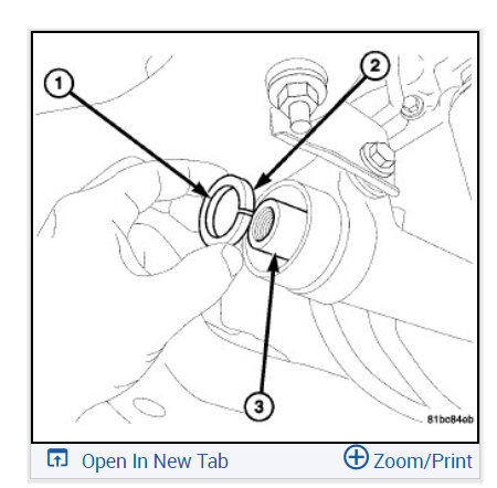

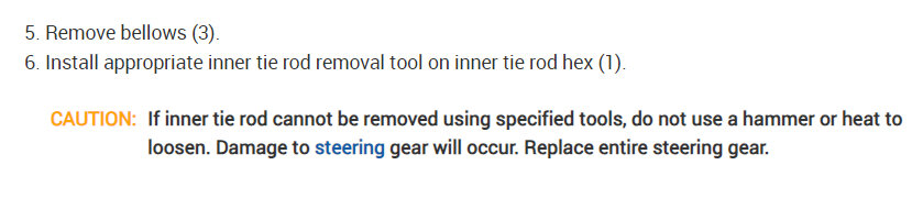

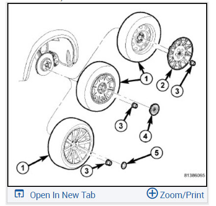

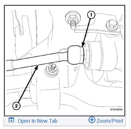

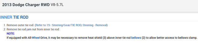

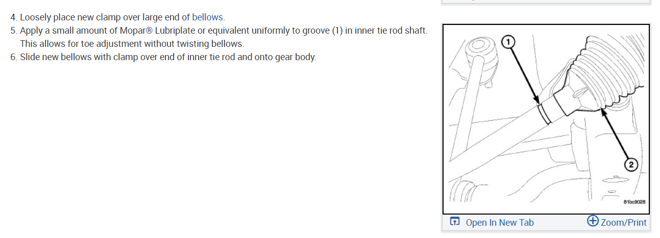

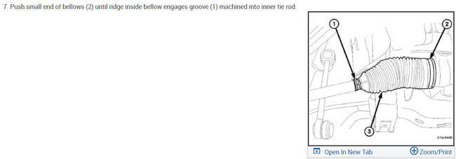

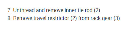

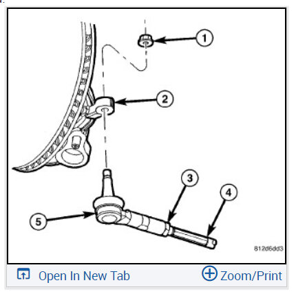

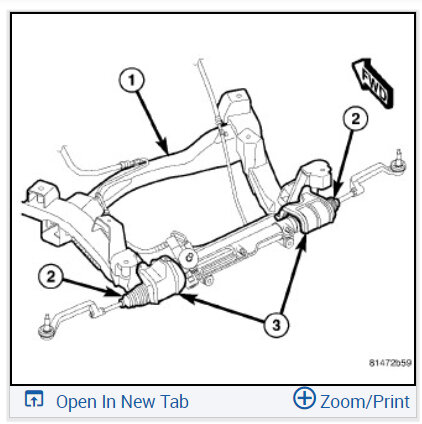

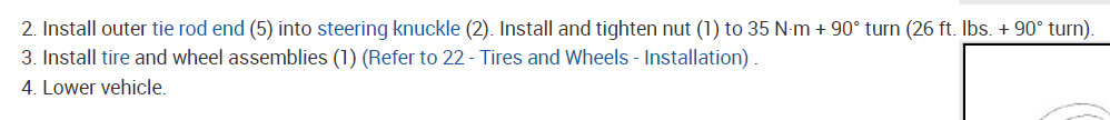

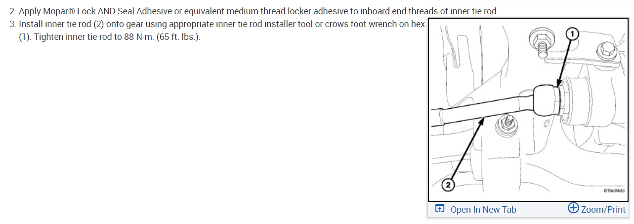

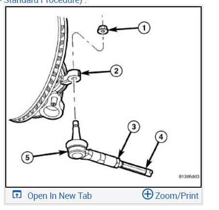

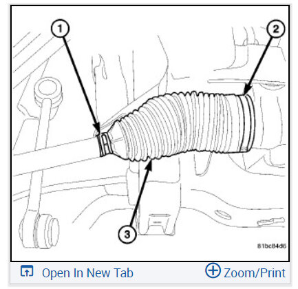

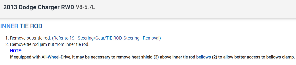

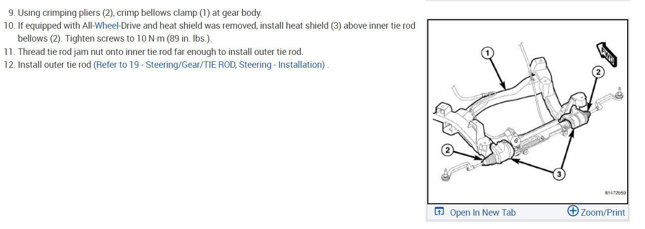

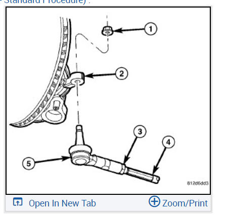

I need the instructions on replacing the inner and outer tie rods on both sides and does the jam nut have to go on a certain way?
Aug 25, 2024 at 2:15 AM
  • 55,628 POSTS

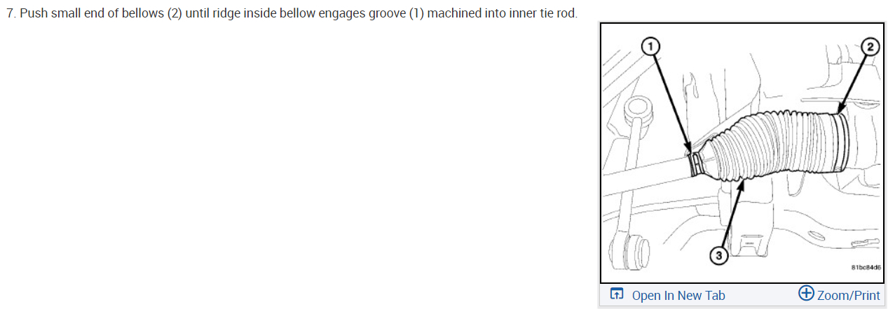

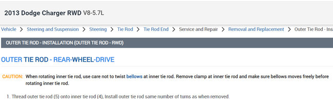

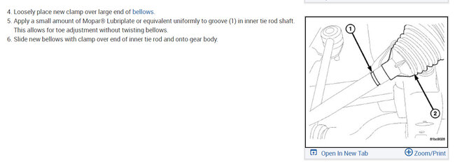

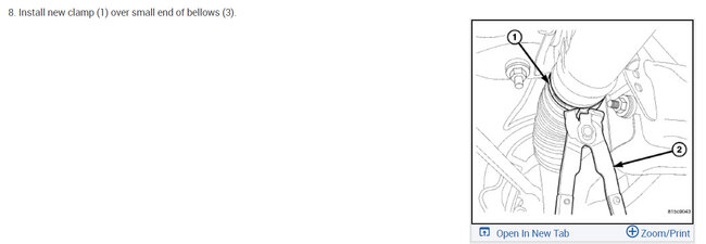

Yes, you want the flat side of the jam nut downward, here is a guide to help you see how to pop loose the taper fit shank on the outer tie rod end. Also, I included instructions on how to do the repair job correctly in the images below.
https://www.2carpros.com/articles/tie-rod-end-replacement
Check out the images (below). Please upload pictures or videos in your response of any problems so we can see what to help you with.

Okay, so, the jam nut is different on each side of it .
Aug 25, 2024 at 12:11 PM
  • 55,628 POSTS
Yes, please keep the orientation correct. I would take a picture using your phone before you take it apart to avoid confusion.

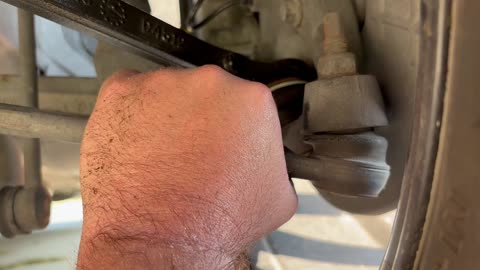

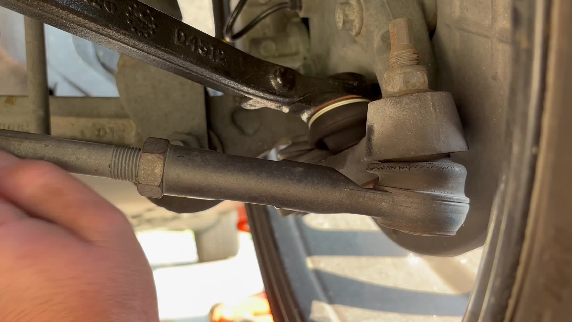

One tie rod boot is torn but the other isn’t but ik you your suppptk be able to pivot the tie rod joint but it’s not supposed to make a clunking noise like this is it.
Aug 28, 2024 at 12:21 AM
  • 55,628 POSTS
Yep, that noise ot normal, thanks for the video.
Aug 28, 2024 at 1:35 AM
SKOOTER28
  • 98 POSTS
Okay, so, that one is good but the other one the boot irks torn. so, I should replace that one, right?
Aug 28, 2024 at 1:39 AM
  • 55,628 POSTS
Yes, torn boots are not good and should be replaced.

Oh, okay, is that noise normal just to confirm before I replace that one.
Aug 29, 2024 at 3:28 AM
  • 55,628 POSTS
Yes, if you twist the tie rod end it will make that noise, new tie rod ends make that noise as well. This is not to say if the tie rod is loose (play) it will make that noise as well so if that is any question replace it.
