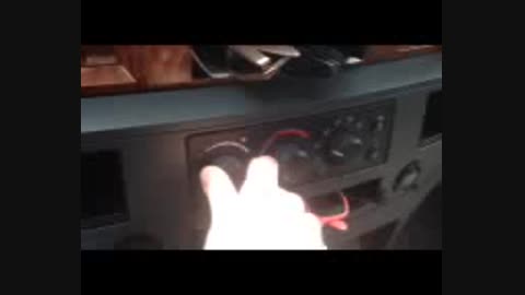

Also, on a completely different note, since I first posted this question there is a different noise that I started hearing, which is a single loud knock that sounds like it is coming from the very bottom of the dash in front of your feet, and it only makes this loud bump when first turning on the A/C. It does not matter if the car is moving or in park, but it does it within fifteen to thirty seconds of turning on the A/C. I was able to capture this sound on video, so I attached a clip, and you will hear the knock at the end of the video. It will not knock again for the entire rest of the drive, just once shortly after you turn it on.
Any ideas on this one?

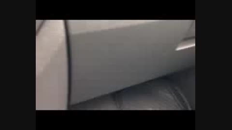

Here is a longer video and it is hard to hear the ticking/chirping noise in this one as well, but you can hear it briefly at about twenty one seconds in the video.

To get a better recording pull up beside a building and use it to bounce the sound back or open the hood and record it right from the engine. If you open the hood you can also move the camera to each side slowly.
