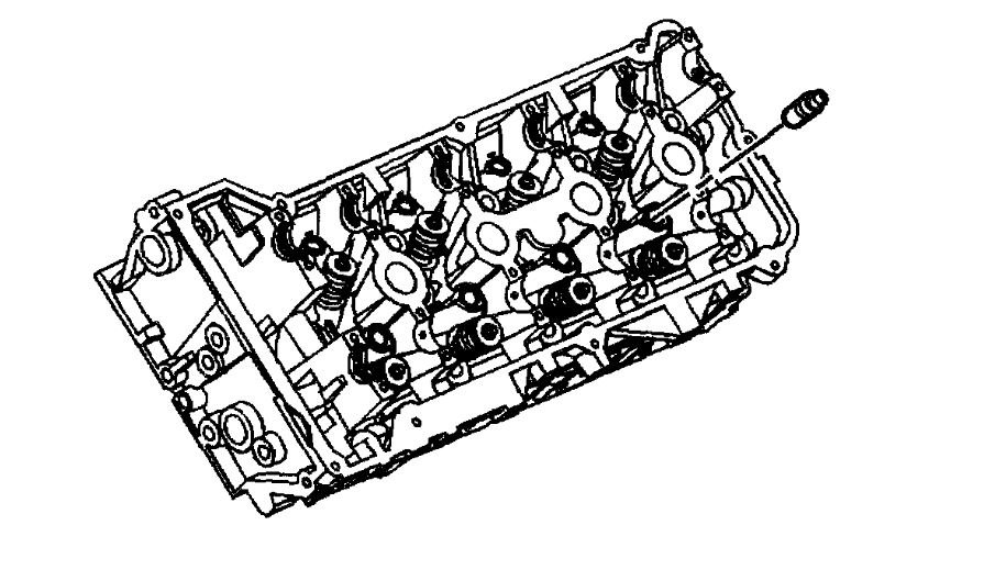

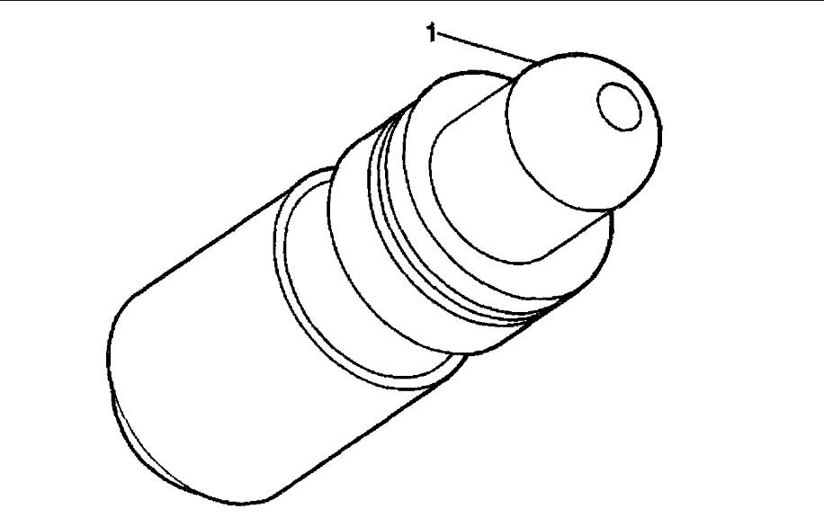

Is it bad to drive with a bad oil lifter? If so, exactly what damage could come from drive with it? Also how much does it cost to have one replaced?
Oct 31, 2018 at 1:47 AM
Good morning.
A collapsed lifter will cause damage over time if it is not repaired.
The one needs to be identified before saying just one can be replaced. It is recommended to replace all at the same time.
The lifters are about 18 each.

Yes. I am positive its the lifters. I should of done it when a friend and I did the valve covers since it would of been accessible to us.
Dec 13, 2018 at 2:27 AM
Okay, since the noise is still there, I would definitely replace the lifters. Driving it with the noise could damage the camshaft lobes.
