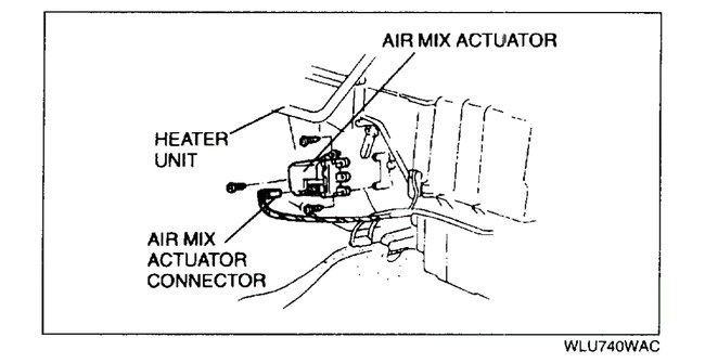

Roy, thank you for your reply. I can barely hear it from inside the car but it does sound like it's coming from closer to the fire wall under the hood, but I could be wrong. I should do a stethoscope test and touch the intake manifold because that's where it seems like it's coming from but I'm sure it won't hurt to check the alternator too. Is the A/C actuator in the engine bay?
Jul 15, 2020 at 5:56 AM
No, the actuator is inside the car in the dash.
Outside, it is hard to guess what or where the noise is coming from. The blend door actuator is up against the firewall but is inside the car.
Using the stethoscope is a good idea.
AIR MIX ACTUATOR REMOVAL/INSTALLATION
1. Disconnect the negative battery cable.
2. Remove the dashboard.
3. Disconnect the air mix actuator connector.
4. Remove the three tapping screws and the air mix actuator.
5. Install in the reverse order of removal.
