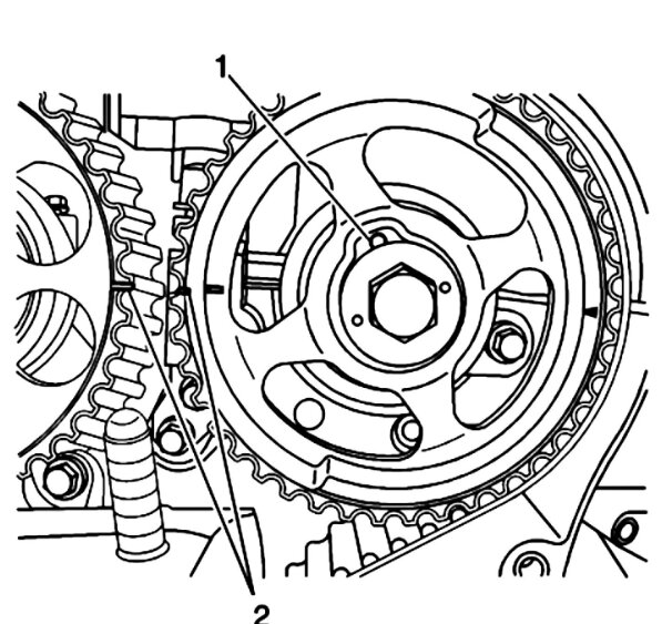

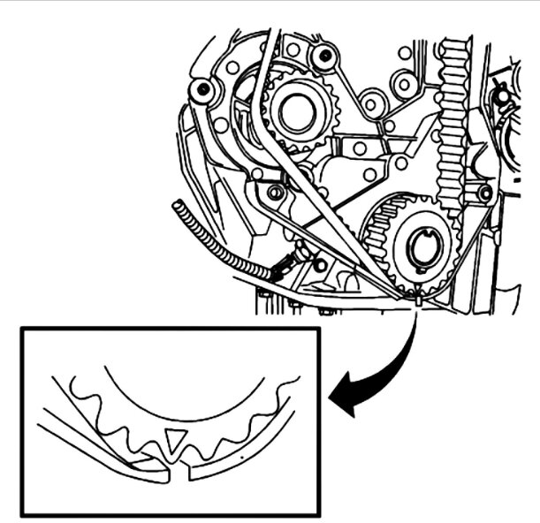

Hello.
On my vehicle listed above, I've noticed a ticking sound from the engine near the timing belt assembly. It's not constant, every few seconds or so, but goes away after a couple of minutes.
I hear this at start-up, but I have not noticed it when driving.
Any advice/help is appreciated.
I've attached a video so you can hear it.
Thanks,
Roosevelt.
Aug 19, 2025 at 11:33 AM
  • 55,732 POSTS
Hello Roosevelt,
Thanks for the video, it helps. this noise sounds like the timing belt tensioner bearing is going out. I would change the timing belt and tensioner to fix the problem. But to be sure I would remove the serpentine belt and start the engine to see if the noise is gone, if not do the timing belt job. Here are the timing belt marks to help you do the job. Check out the images (below). Please upload pictures or videos in your response so I can see the problem.
