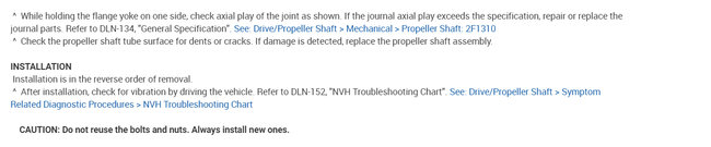

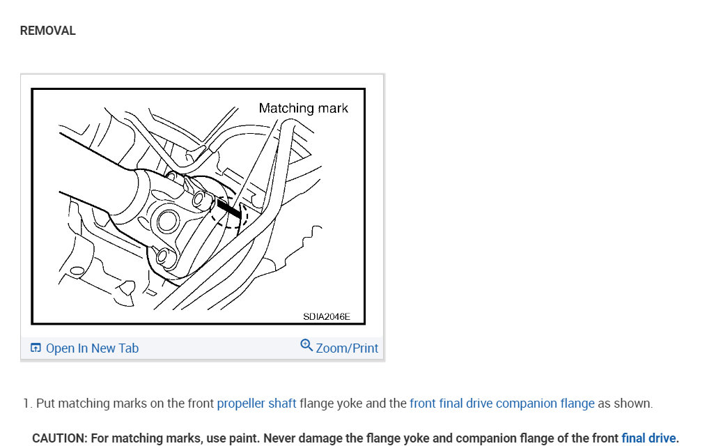

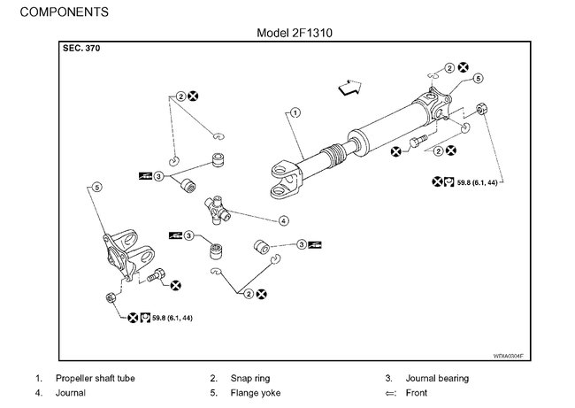

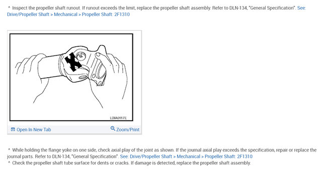

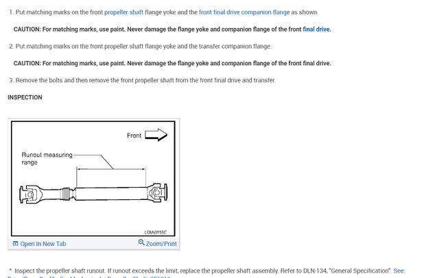

This happens when the U joints are going out. To be sure, you can get under the vehicle and use a flashlight to inspect for rust colored dust which is a sure sign the U joint needs replacement. check out this guide and the images below to help you with the repair:
https://www.2carpros.com/articles/how-u-joints-work
Check out the images (below). Let us know what happens and please upload pictures or videos of the problem.
