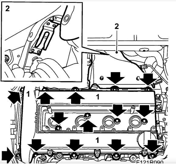

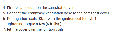

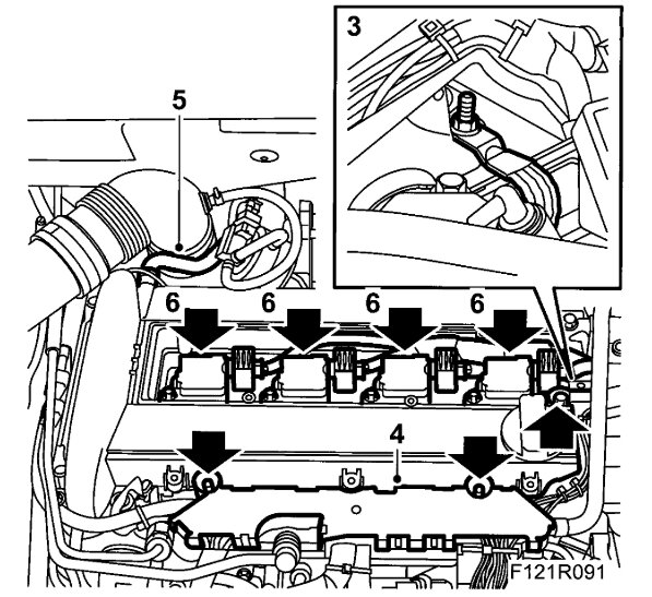

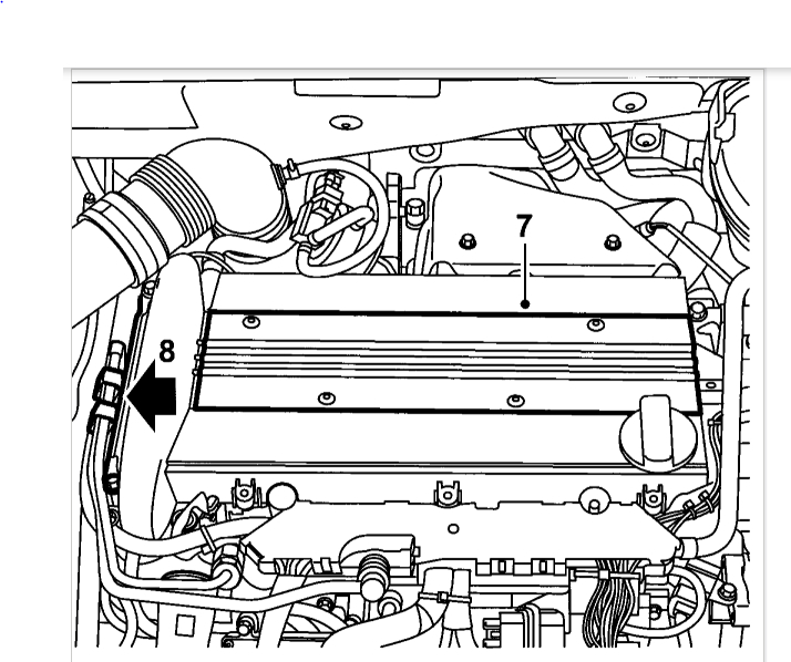

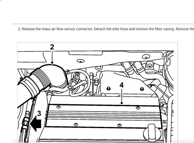

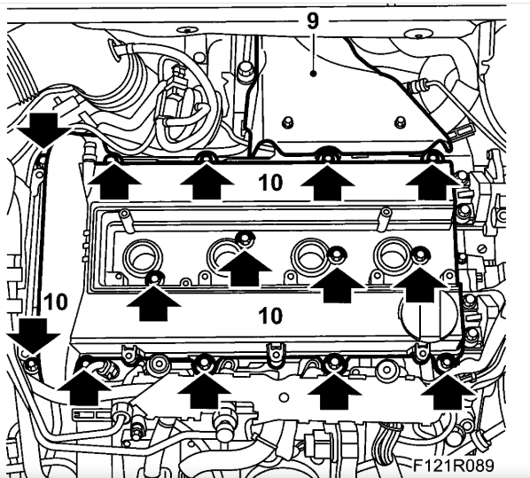

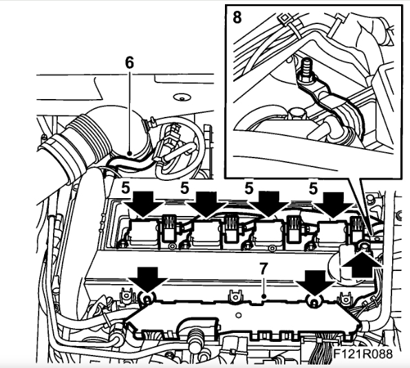

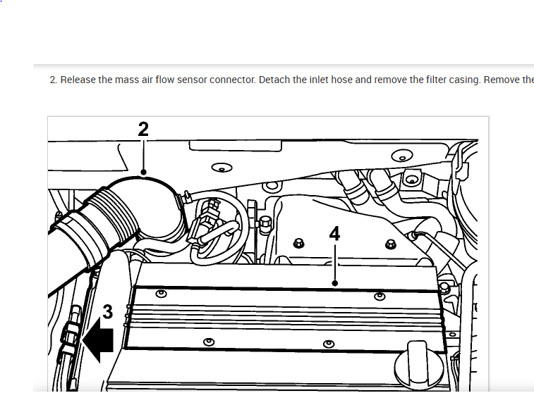

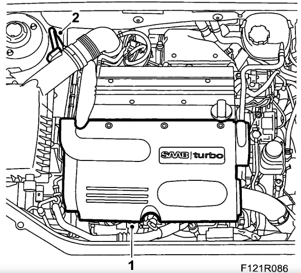

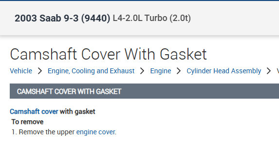

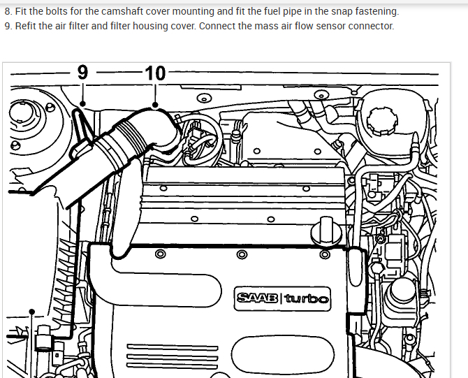

Hi:
I listened to the video you sent. The noise sounds like a top-end noise or a timing chain. If I recall, the timing chains were an issue on these.
What I would suggest is this. Remove the valve cover and inspect the chain and all components related to the camshaft. Make sure nothing is loose. If the chain appears loose, you likely have either a failed tensioner or a chain guide.
Below, I have attached the directions for replacing the valve cover gasket.
See pics below
May 12, 2026 at 7:45 PM

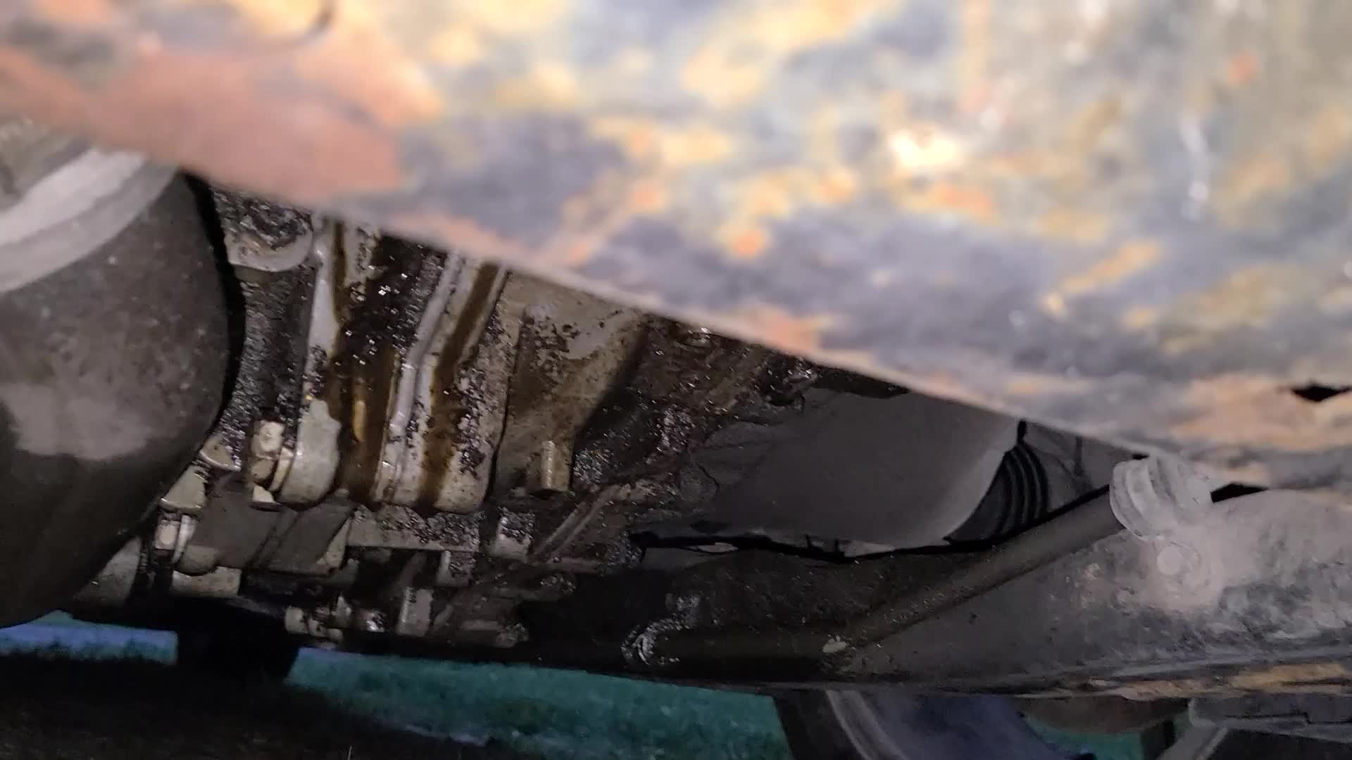

Okay so come to find out I guess I ran the car out of oil. I knew it was leaking but I didn't know it was pouring out like it is. Almost like someone's "saab" otaged it. So I don't know what to think of the new noise it is making now and what I should do with it if it's even worth fixing. I first bought this car for $700 from a friend. I've put $6,000 into it with parts and labor so far and much more needed work done to it including suspension is the main thing. So I don't really know how I'm going to stand still on what I should do with the car but I will send you some videos of the noises it's making and the oil leak on the front right side of the motor would be on the timing cover side or driver side any advice or any help with much be appreciated thanks
May 25, 2026 at 5:46 PM
  • 55,423 POSTS
Yep, that is not good, it looks like the rear main seal popped out and the engine run out of oil now it has a rod knock, sorry about that. Thanks for the videos though.
