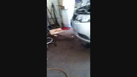

Can you please shoot a quick video with your phone so we can hear the noise? that would be great. You can upload it here with your response.
Jul 17, 2019 at 4:21 AM
REDBONE
  • 105 POSTS
This is the noise after putting new timing chain in.The car sat in driveway for 2 yrs. without starting it.
Jul 17, 2019 at 6:10 AM
  • 55,433 POSTS
Thanks for the video, something is wrong inside, oil etc will not help. It sounds like a broken valve spring, valve train issue. Can you tell if the noise is coming from the front of the engine or from up top? Lets remove the valve cover to inspect. Look for loose cam followers. let me know
Jul 18, 2019 at 2:13 AM
REDBONE
  • 105 POSTS
The noise is coming from the top,driver side close to the cam sensor,will i have to take the camshaft out to fix it.
Jul 18, 2019 at 4:19 AM
  • 55,433 POSTS
Something is broken/loose/worn. please send another video when you get it apart so I can see what is going on. :)
