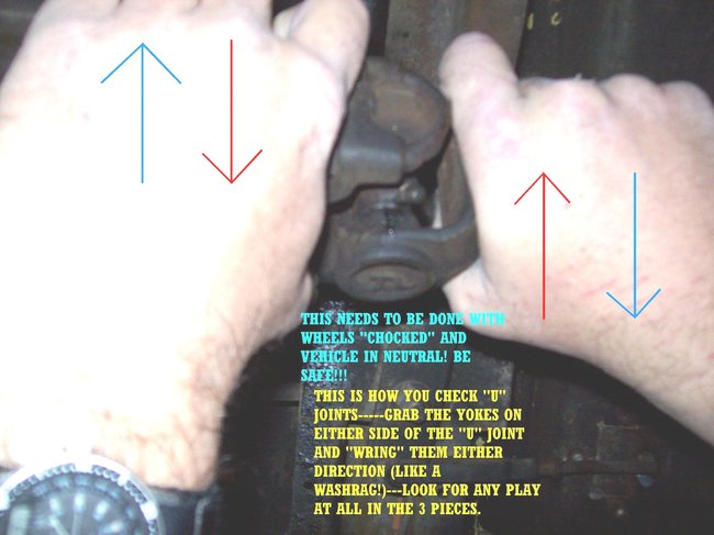

HAVE YOU CHECKED YOUR UNIVERSAL JOINTS?

No I haven't checked those. I described the sound wrong it's more of a popping noise coming to a stop mainly around 10 mph to stopping. If it is the uv joints what should I do to check it?

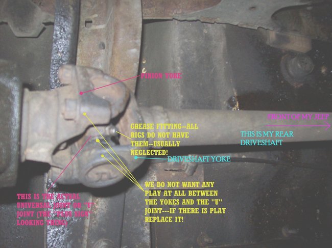

MAYBE LOOK AT THE PICS OF MY 1946 WILLYS JEEP U-JOINTS IN MY 1ST RESPONSE?

Sorry, the images didn't show up at first in my phone it just said it couldn't be displayed. But I'll try that out and see if that's it. Thanks
