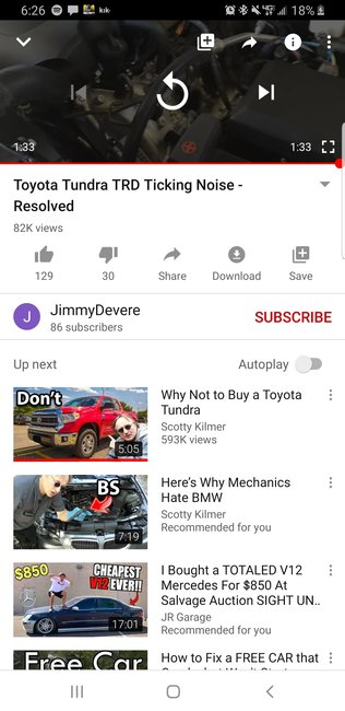

When I start my truck and it is sitting it has a somewhat of a diesel noise kind of a clicking, but when I accelerate it goes away. It runs just fine no codes are being thrown and no engine light. Some people say it's normal but it still bothers me. Any input or ideas would be very helpful and give me a peace of mind.

Kinda sounds like mine.
Nov 12, 2019 at 4:27 PM
  • 110,194 POSTS
I just got home from work and had a chance to listen to my friend's truck. It sounds just like your video. Honestly, I don't feel there is anything to worry about.
