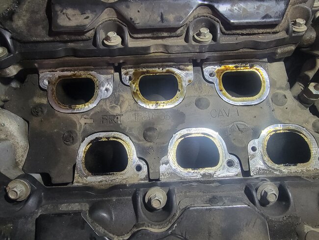

I think you're right look at the different, does that mean i need to replace valves as well? Check out the video.

Also oil spitting up from exhaust side.

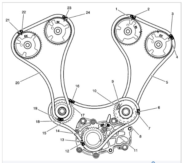

Is the one timing chain a lot looser than the other? It's hard to see your hand on the first one you check. Is that the same side that you are seeing oil from the exhaust side?
Also, take a look at the guides. Is anything damaged? If not, we need to confirm the timing is correct. I attached a pic below showing the timing mark locations.
See pic below.

The head closer to the engine bay has a tighter chain the one closer to the front of the bumper is way looser it is almost possible to pull it off, the valves where i see the oil has the tighter chain the looser chain has no oil leakage if the timing slipped do i need to check the valves from being bent, if so how can i check that compression test?
