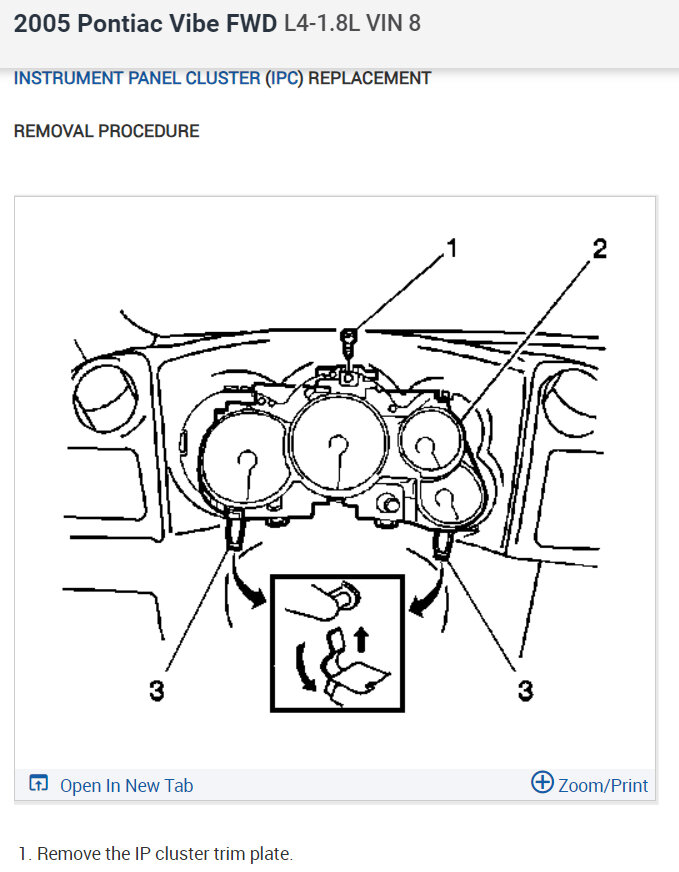

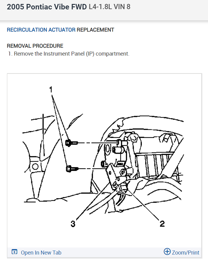

I'll start off by saying I'd rather fix my vehicle than put money into another cash car. When I push the airflow button on the inside of the car, there's a thumping noise on the passenger side of the dashboard. The A/C doesn't blow cold air, but the heater works. I'd like to see if I can replace or fix something myself. Any thoughts?
Mar 5, 2024 at 9:00 PM
  • 55,691 POSTS

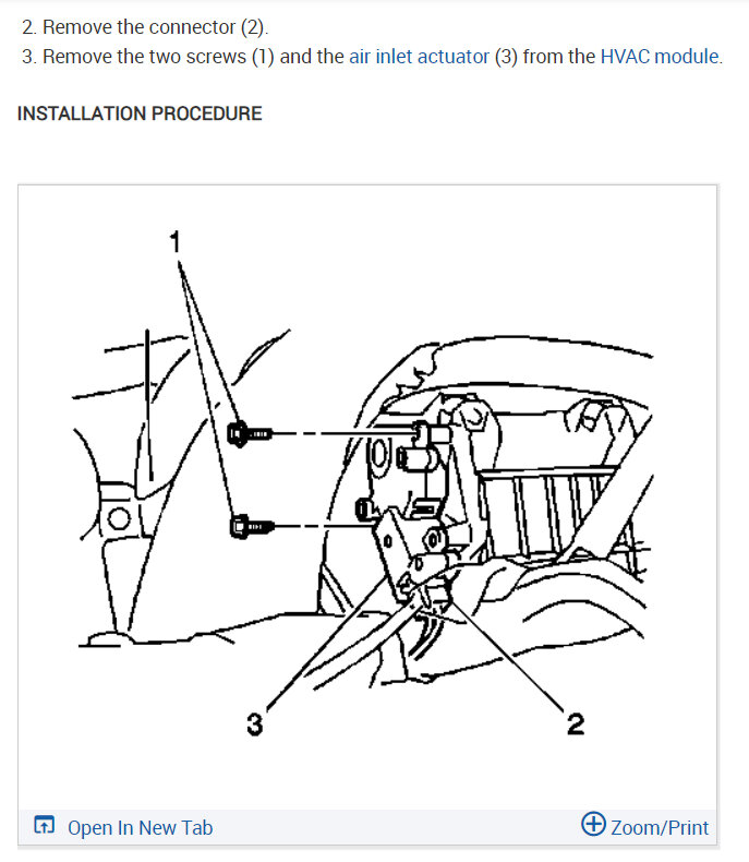

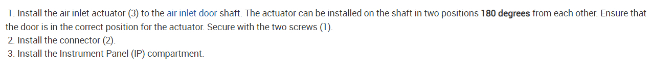

Yep, this happens when the recirculation actuator goes out. Here is the location and how to change it out in the images below. Check out the images (below). Please upload pictures or videos in your response to the problem so we can see what's going on. Please start a new thread for the A/C system not working.

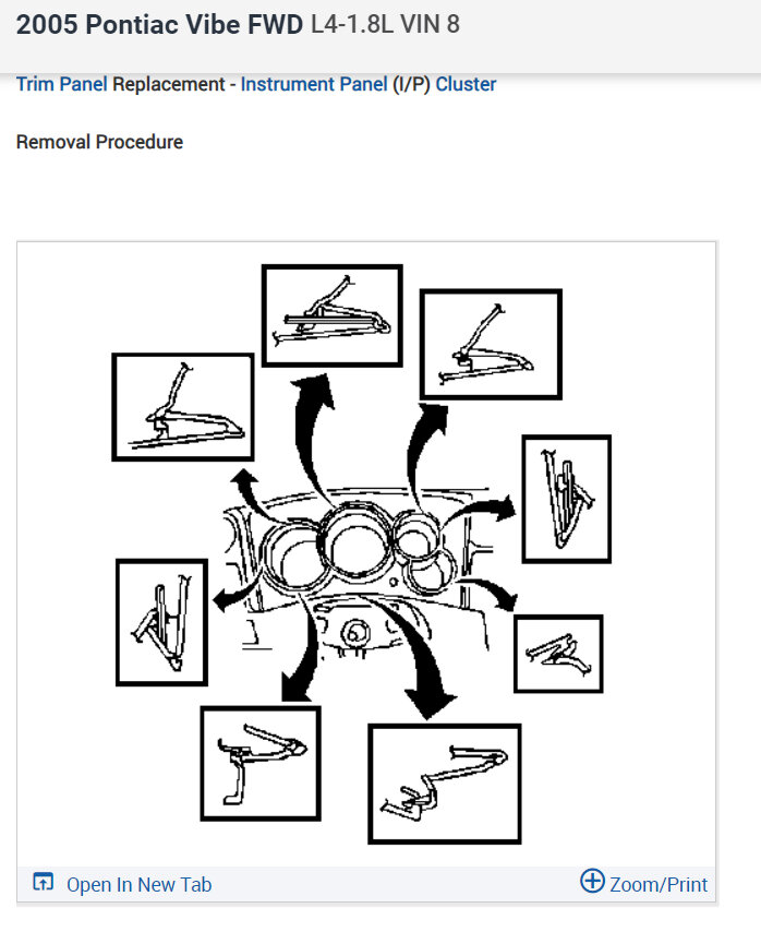

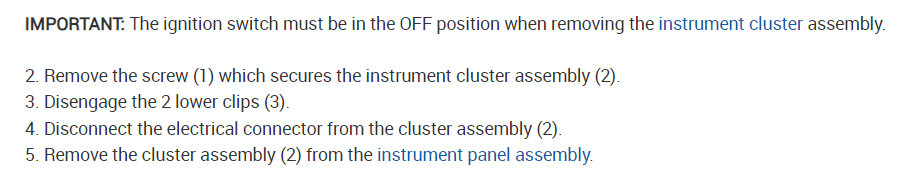

Thank you, Ken. Total girl question, is the control panel access from inside the car?
Mar 6, 2024 at 3:47 AM
  • 55,691 POSTS
Yes, from inside the car, if you have problems, please upload images or a short video so I can see and help you through the repair. It looks like you will need to remove the instrument cluster. These images should help you. Check out the images (below). Let us know how it goes.

I was finally able to get the actuator changed out. My back is fused so I had trouble getting my hand in there from the front. I got creative and laid my ironing board on the seat and scooted up under the dash. It was a challenge to get the new actuator on and the screws in the right holes without being able to see it. I used a lighted dental mirror and was able to get the screws in and tightened. The noise is gone but it still wasn't blowing very cold. I used an ac spray cleaner, a soft dryer vent lint remover brush and the soft spray on a power washer to clean the condensor. It's blowing cold now with no noise.
