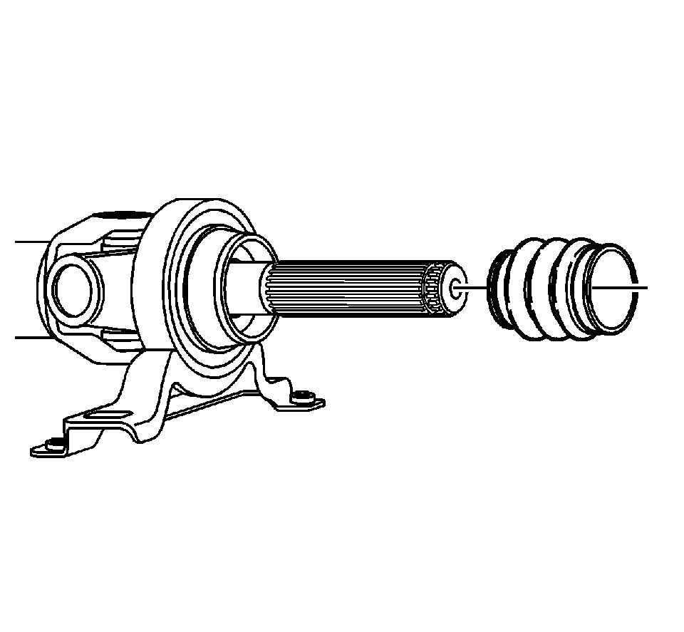

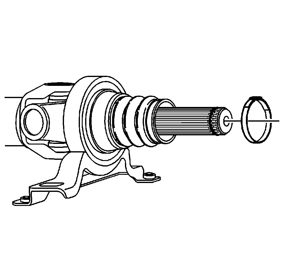

Thumping noise coming from rear of car.when changing to drive.sometimes hear it when driving.
Jan 27, 2020 at 5:03 PM
  • 110,190 POSTS
My first suspect is the rear drive shaft center support. There is a bearing that can go bad and cause what you have described.
To check, put the parking brake on and have a helper (engine off) while holding the brake pedal securely, place the shifter in neutral. That will remove any tension on the driveshaft. Then, grab the drive shaft near the center support and see if there is play in it. If there is, the bearing needs replaced.
This is where I would suggest starting. Also, make sure there are no issues with the universal joints or axle joints between the differential and wheels.
Here is a link that describes a universal joint:
https://www.2carpros.com/articles/how-u-joints-work
If you find the prop shaft center support bearing is the problem, here are the directions for replacement. The attached pics correlate with the directions.

pic 1

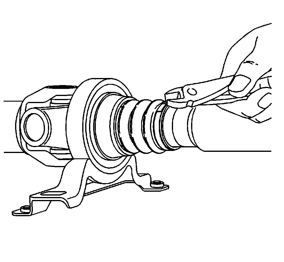

1. Using a paint stick, mark the shaft on both sides. The splines are not keyed, therefore, alignment marks are necessary for assembly.
Notice: Never clamp propeller shaft tubing in a vise. Clamping propeller shaft tubing in a vise could dent or deform the tube causing an imbalance or unsafe condition.
Always clamp on one of the yokes and support the shaft horizontally.
Important: Proper alignment on assembly is critical in order to maintain correct balance.

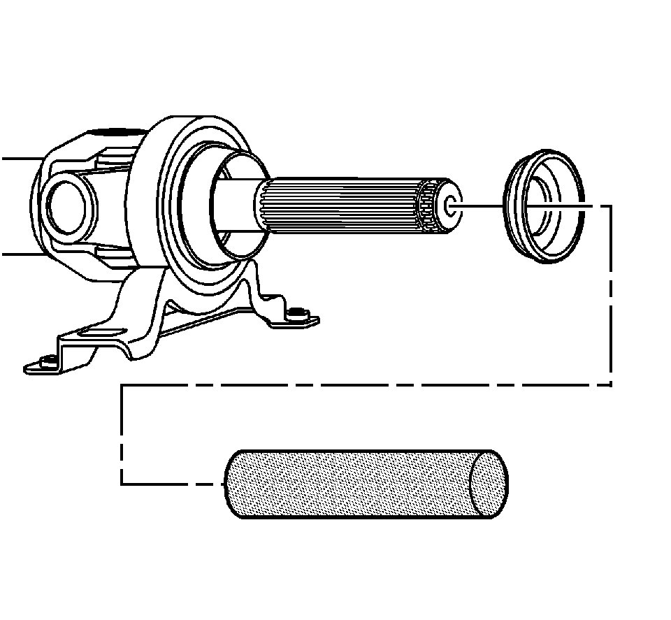

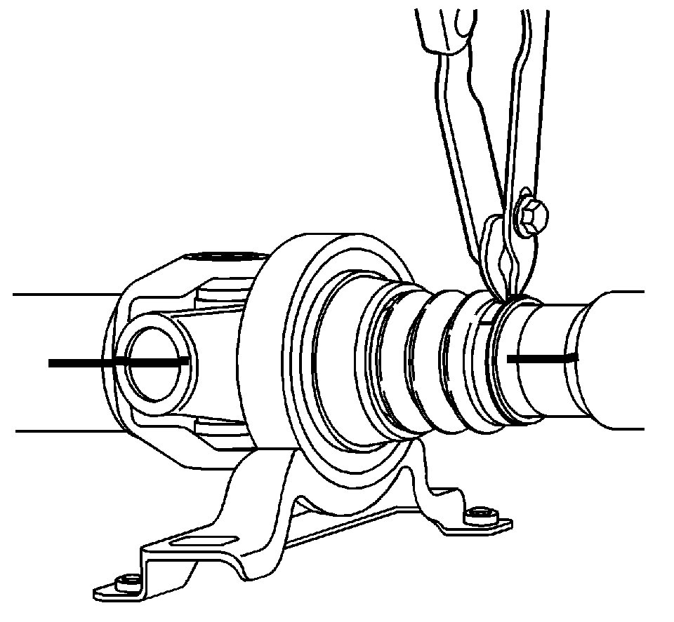

pic 2

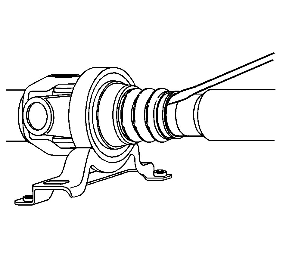

2. Remove the clamp holding the dust boot to the shaft. Discard the clamp.
Important: The clamp is not reusable.

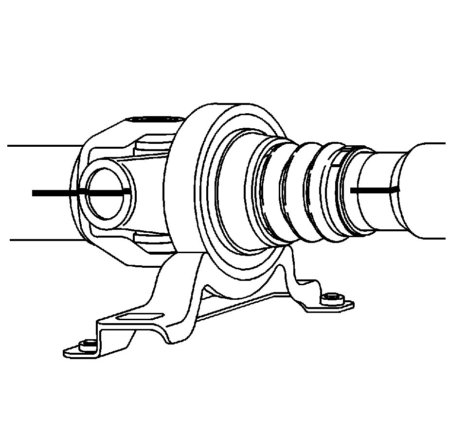

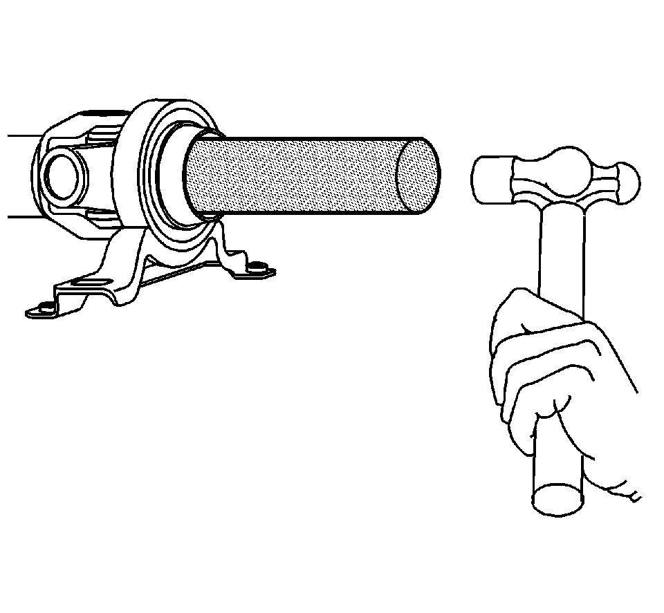

pic 3
3. Pry the dust boot off the shaft tube.

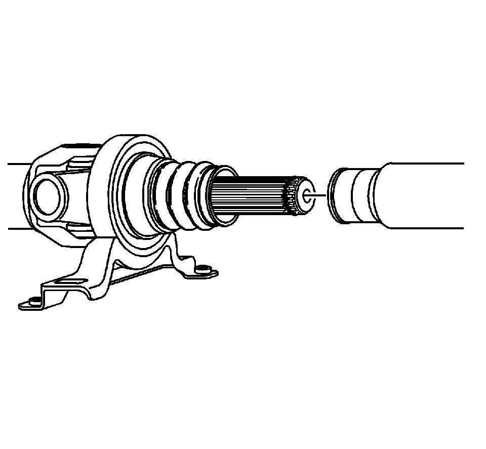

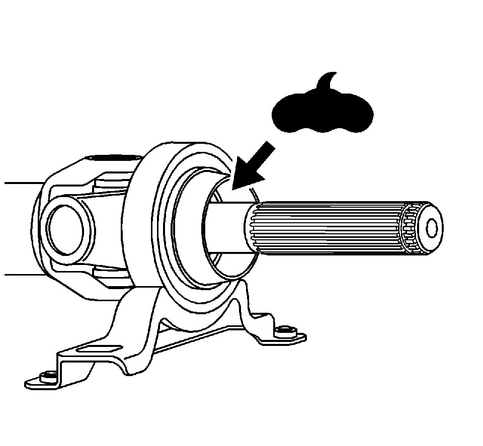

pic 4
4. Hold the shaft on both sides of the bearing and pull or separate the 2 halves.

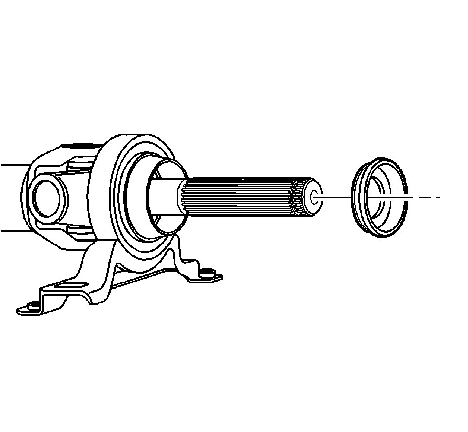

pic 5
5. Remove the O-ring from the end of the spline shaft.

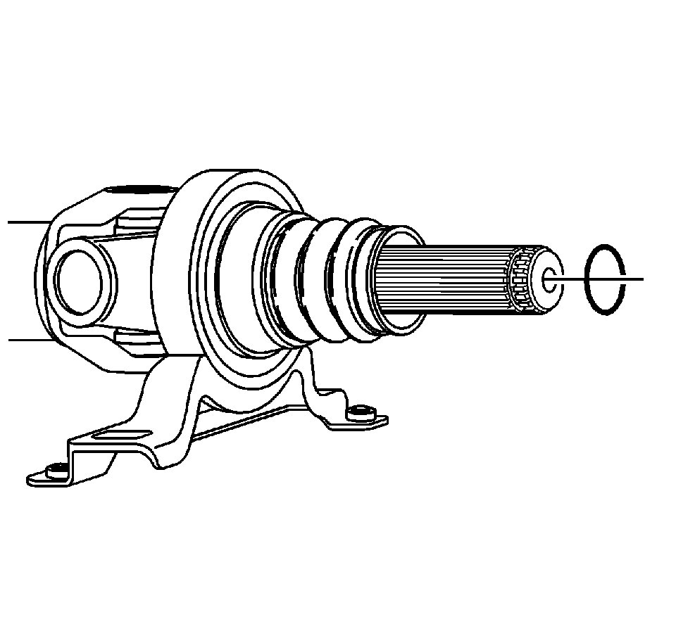

pic 6
6. Remove the dust boot.

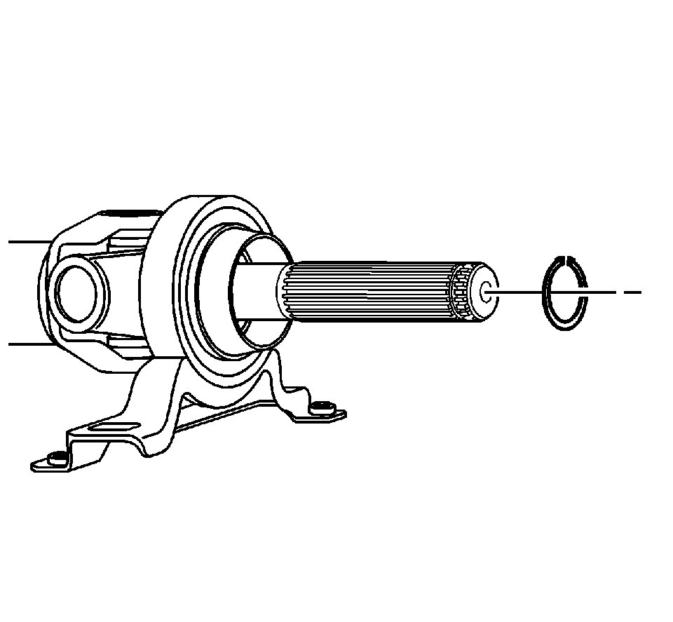

pic 8
8. Remove the snap ring from the groove.
Important: Grease may have to be removed to see the snap ring.

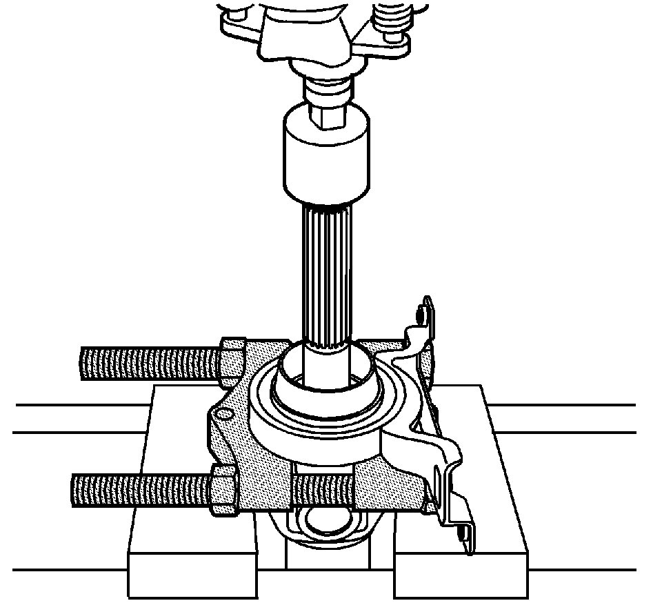

pic 9
9. Install the J22912-01 around the shaft behind the bearing. Place shaft in a press and remove the bearing.

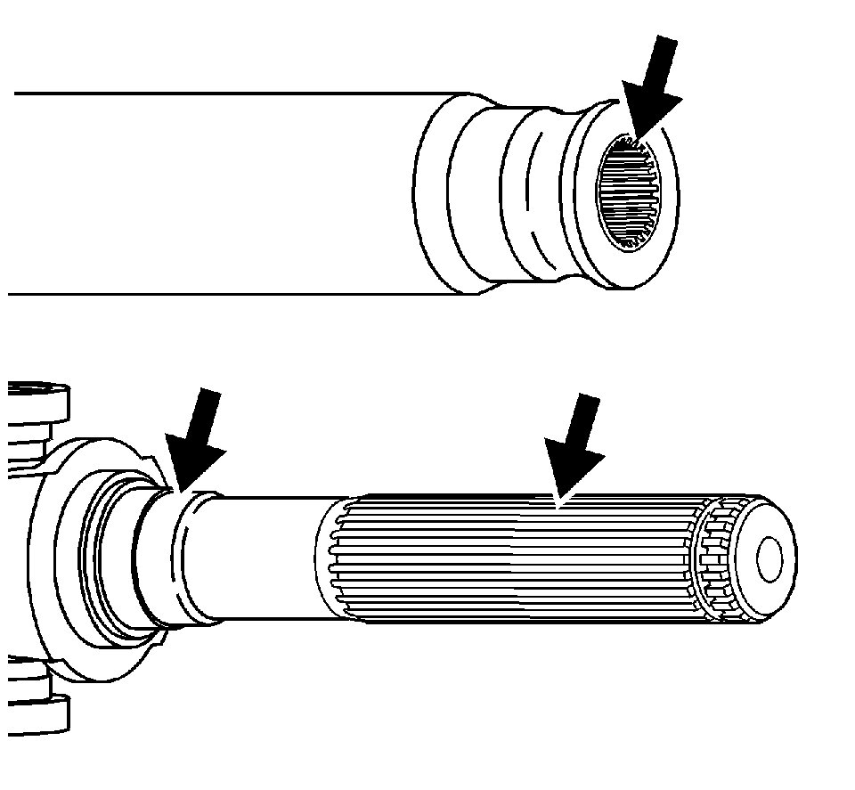

Clean and Inspect
pic 10
1. Clean grease from the splines on both halves of the shaft.
2. Remove any corrosion or debris from the bearing area.
