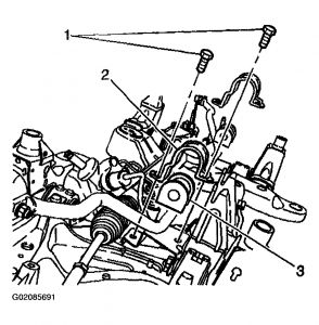

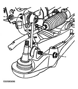

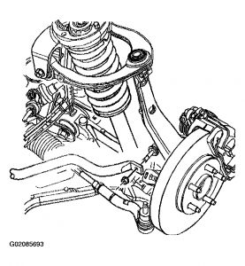

have had the car looked at by Cadillac and Midas.
When I run over a sewer cap with left front tire I get just the thump, thump as you hit both sides. When I do this with the right front tire I get the thum, thump and a wobbling sound and vibration.
No one seems to be able to determine what may be wobbling. driving me crazy...
Apr 23, 2010 at 7:57 AM
BMRFIXIT
  • 19,053 POSTS
I would suspect stabilizer links and or bushing
