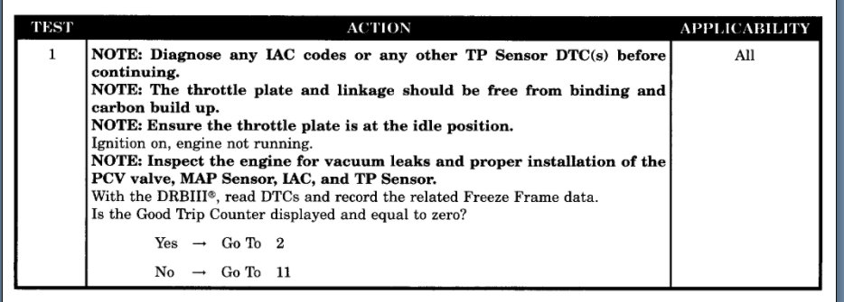

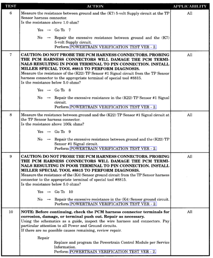

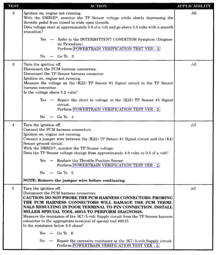

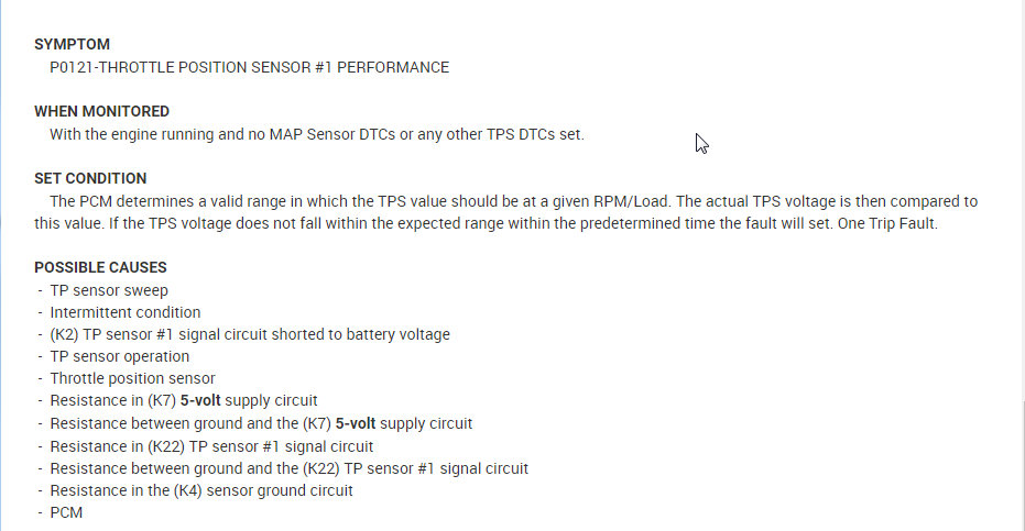

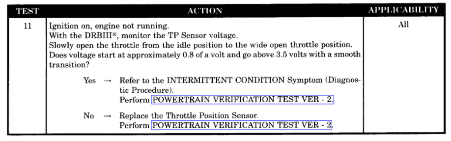

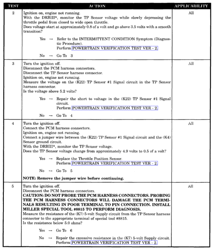

Got a p0121 code and put a new TPS on but it still runs very bad and the same code keeps coming back.
Nov 7, 2020 at 6:01 AM
I attached the testing that we need to run through for this. Unfortunately the sensor is only one of the possible causes. The other include wiring or a PCM issue.
Let's run through this test and see what turns up. Let me know what questions you have with this. Thanks
